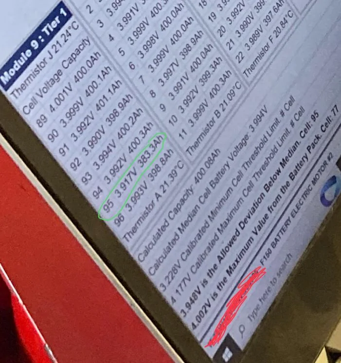

OP here. Take it to a DC fast charger and see if you can charge there. In my case, every time this happened, I was able to charge at a DCFC, and that was how I sustained it until I could get it in for an appt. THe last time around, I found that after a DCFC session, I was then able to charge at home. THe last time I had it happen was a couple months ago, and that was my resolution at that time.
Level 3 charger did not work. Different Level 1 & 2 chargers yield same no go red ring of death ☠ as far as charging. It’s now looking like I have a bad battery pack with low voltage in module 9 needing replaced. Clearing codes no good as it throws code after charging starts. Expected 10 work days to get once parts order is approved on review. Estimating 2 work days job.

You likely have bad battery pack in one of your 9 battery modules if yours is extended range as mine is. Sounds identical to mine.

This is a snapshot of my known reason for 57% reduced power and inability to AC or DC charge (red ring of death ☠ charge port lights) in my vehicle so far….
Amazing and mind boggling how just one pack out of (~96 packs combined total number)
in any of the 9 battery modules can create so much chaos.
