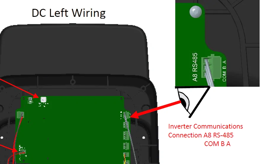

There is 485 and another signal labeled PE. Wonder if that is something as simple as Power Enable?
2,804
3,987

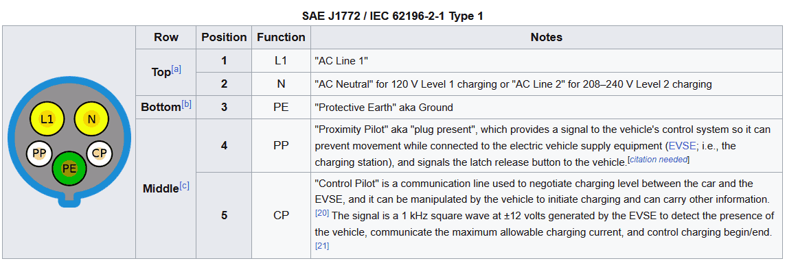

Where do you see PE? Note that for the J1772 connector PE refers to Protective Earth, i.e., Ground.

Yeah, common wire for low voltage. From the Ford-Charge-Station-Pro-Installation-Guide.pdf:
