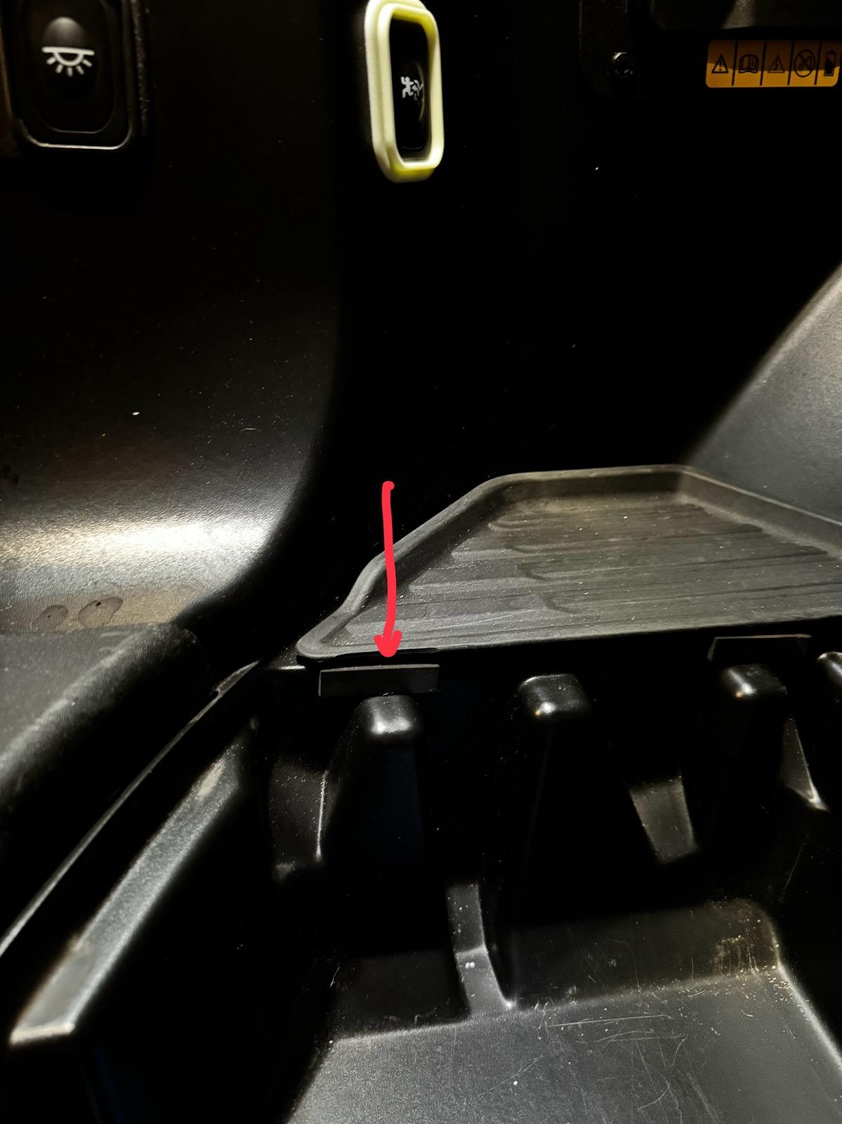

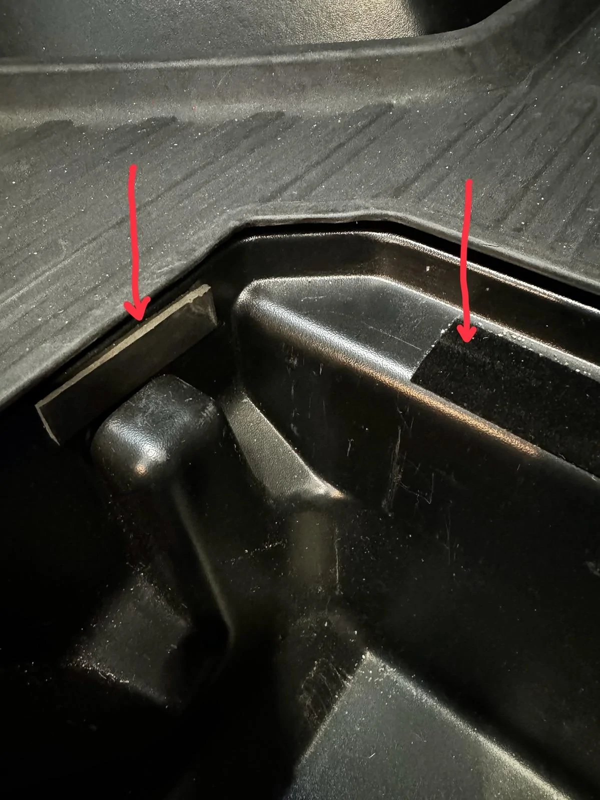

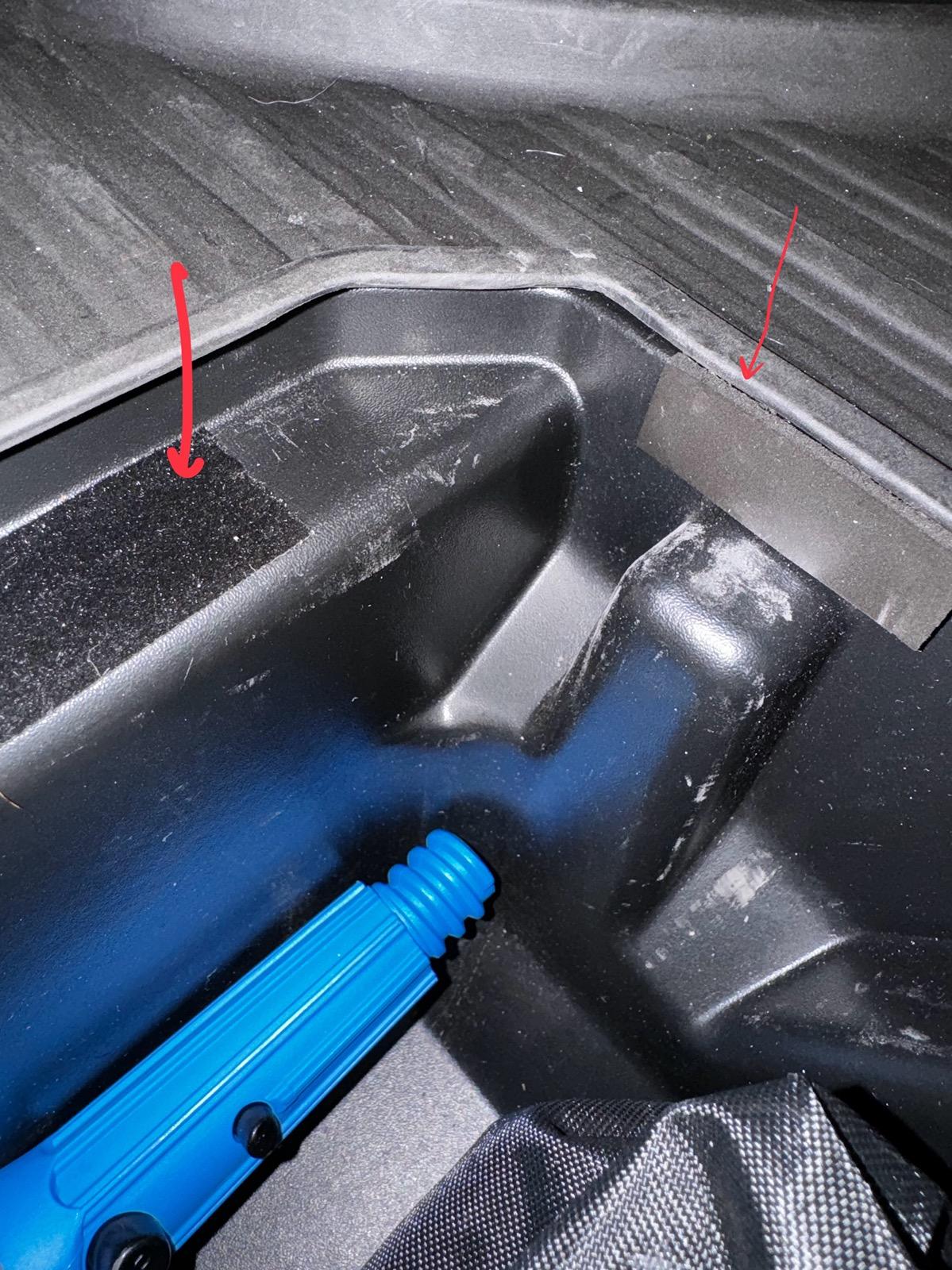

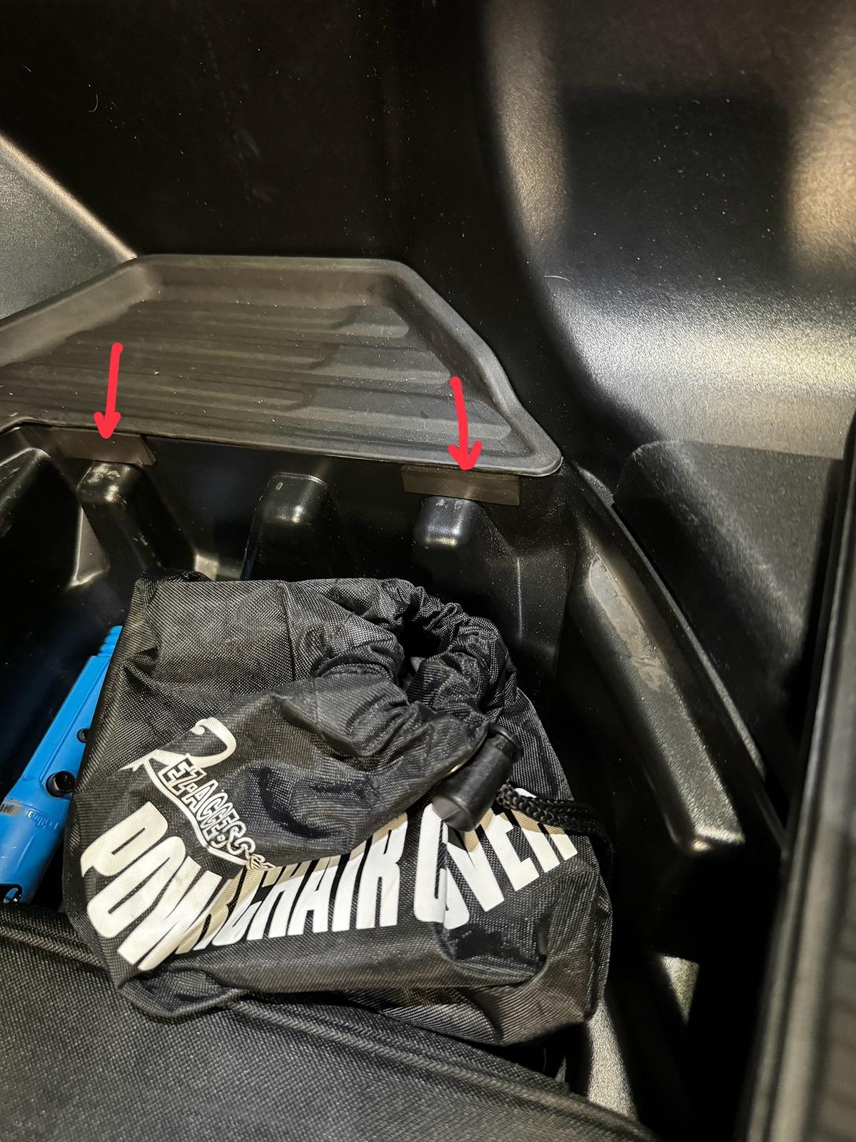

The only other noise issue I had was a clunk when speeding up or turning. It sounded like a loose ball joint or similar - but it ended up being the Frunk lower tray that covers the “ice box” section. There is about a 1/4” to 1/8”gap surrounding it…the dealer I go to isolated the issue and added some small foam bumpers to prevent the sliding and some velveted tape in the ledge where the tray sits in and this resolved the clunk issues:

I was also thinking the soft fuzzy side of Velcro tape would also be a good match thinkness wise and would blend in well.
@Ford Motor Company Company - you may want to cut this issue off at the pass and add these in assembly in the future.
