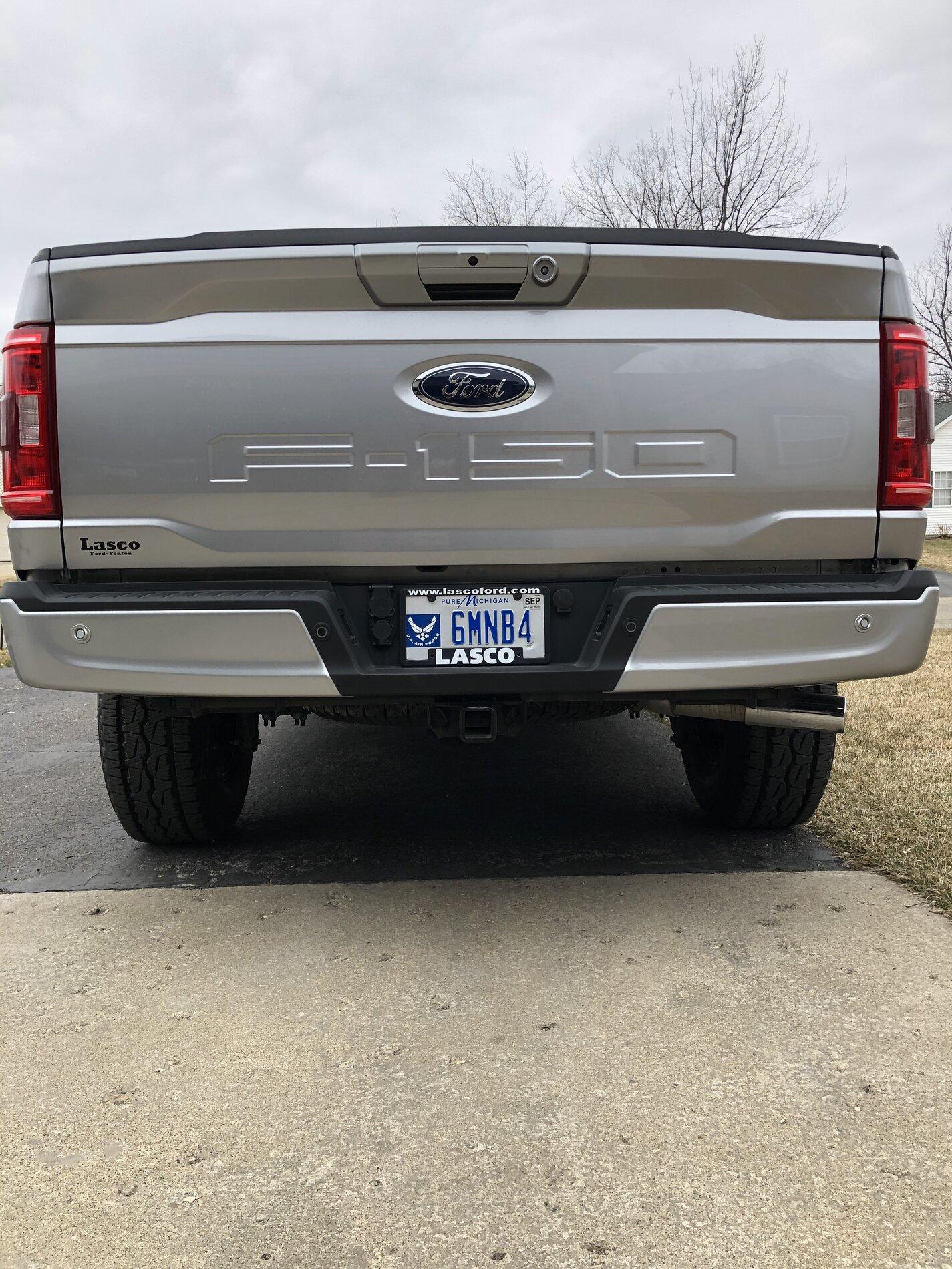

I installed the same size tire as the rest of mine and put it right back up in the hole. 295/70R18
Well shit, now I'm gonna have to buy another wheel and tire that matches to mount under there since I know it fits. Thanks for answering that question, though my wallet doesn't thank you! Haha.
Thank you, this is very helpful. I'm probably going to use the exact size.
You know if you don't change the spare to a comparable size, you will eventually drive 60 miles into the back country, at night, in the snow and then get a flat....Murphy!
It's valuable info to know the larger sizes fit. Thanks for the info, especially since I'm planning the 295/70/18 option.
Is the spare the same 18inch sport wheel as the rest?
