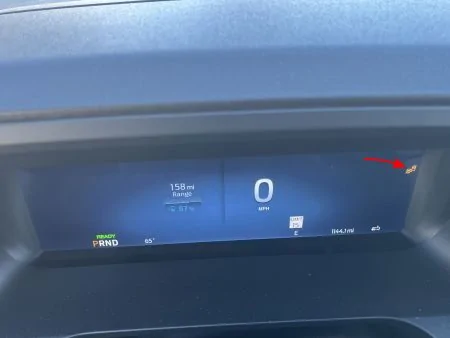

the red arrow points to the indicator in question:
Ford F-150 Lightning What does this indicator light on the dash mean? arrow pointing to lights sm

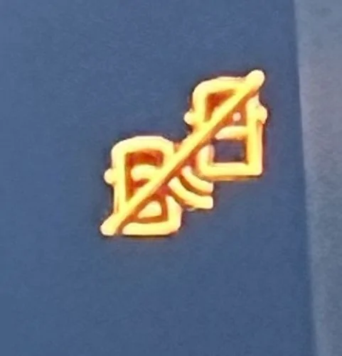

Here is a closeup:
Ford F-150 Lightning What does this indicator light on the dash mean? closeu

Appears to be a blind spot monitoring issue.

That’s correct. It’s telling you there is a problem with blind spot sensors.

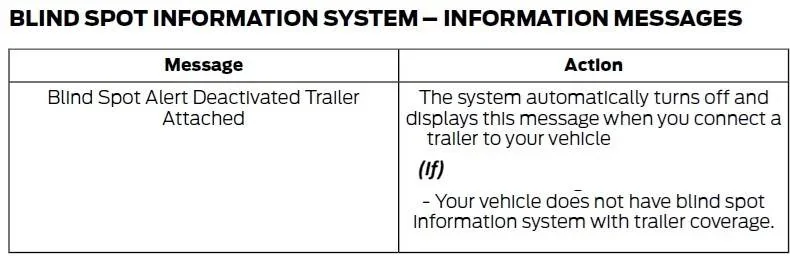

The blind spot indicator does work when a trailer is connected, with some F-150 LIghtnings, according to the manual. Eg: this excerpt from the manual states that the BLIS turns off when a trailer is connected
Ford F-150 Lightning What does this indicator light on the dash mean? excerpts from BLIS message description

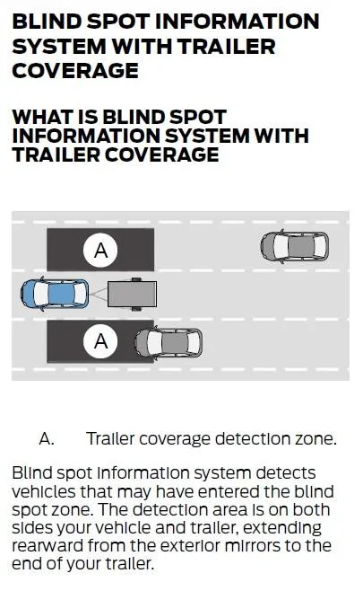

But, if your vehicle does have BLIS with trailer coverage, system stays on. The manual has a section explaining it:
Ford F-150 Lightning What does this indicator light on the dash mean? Manual BLIS with trailer coverage
Since my Flash indicated the system turned off because a trailer was connected, and then indicated nothing after a few times a trailer was hooked up and disconnected, I'm still wondering if a 2024 Flash has BLIS when a trailer is connected, or if my indicator has an intermittent fault. I'll be able to confirm once I get back out into traffic with a trailer connected, when a vehicle comes into the blind spot.

Keep reading the next section. You need to tell the truck how long your trailer is so it knows where the blind spot ends.

I gave the Ford software all the info it needed on the trailer. It is the "active trailer", and the only trailer the software knows about.

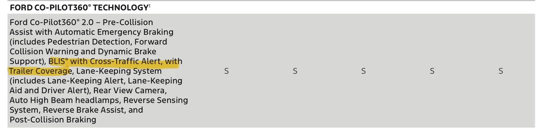

It should be standard on all trims so it might be time to visit the dealer.
https://www.f150lightningforum.com/...p-updated-with-specs-sheet.19160/#post-384042
I found contradictory information about what is standard equipment on a 2024 Flash.
Your screenshot comes from a page hosted on this forum that includes material from several other pages. I wanted to confirm that it exists on Ford.com. I couldn't find it on Ford.com. I did find it on what appears to be a Ford page, i.e. a media.ford.com page:

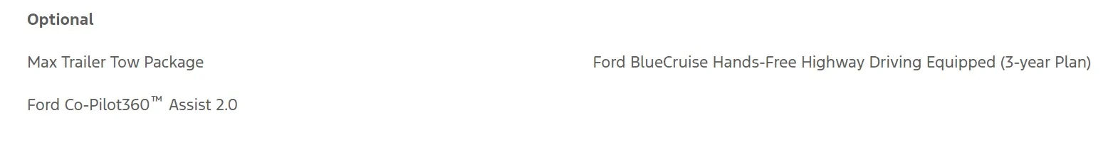

The Ford.com page describing Flash specs, that contradicts the page you pointed to, is this one:
https://www.ford.com/trucks/f150/f150-lightning/models/f150-flash/
which lists, under Packages, that the Co-Pilot360 package, which includes BLIS Trailer Coverage, is optional:
Ford F-150 Lightning What does this indicator light on the dash mean? Co-Pilot360 optional
I'm still not sure what exists on my Flash. I've seen descriptions of Equipment Group 312a, which is standard on a Flash, that state it includes Co-Pilot360.
