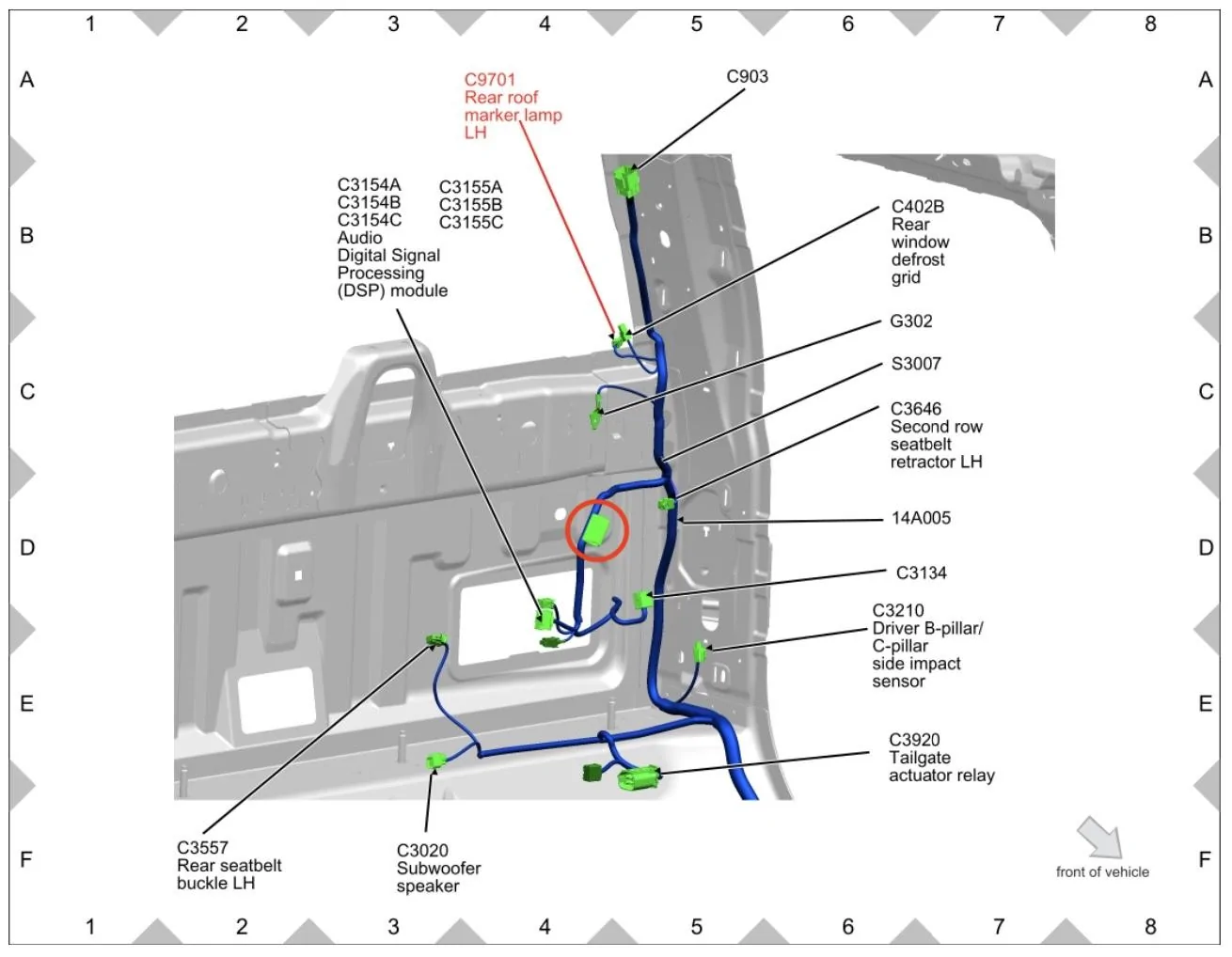

What is this connector for?
Mike G
Jan 6, 2022
1,766
2,577
N. AL, USA
Actually one side is primary and the other side is backup. TCU antennas.
