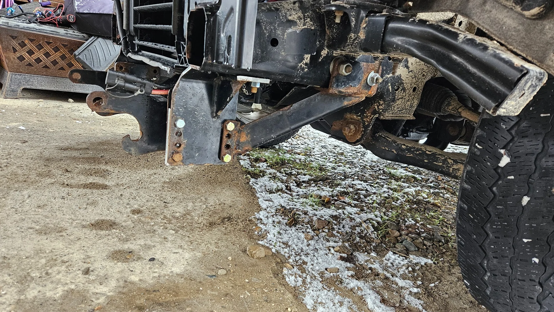

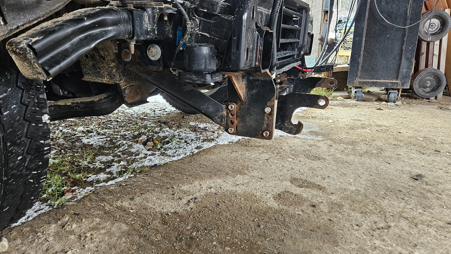

Keep us posted. I was also thinking the tow hooks were the best place to attach to the truck. Looking forward to seeing how things progress.
Any detailed pictures of the attach points are greatly appreciated.

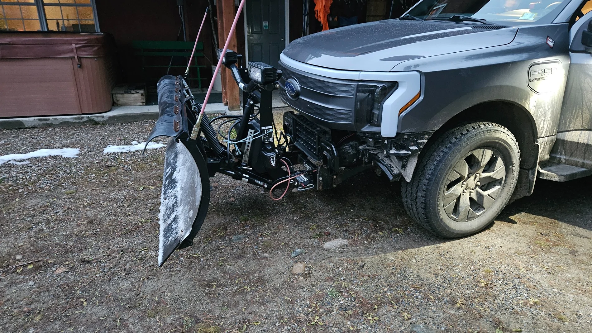

I attached it to the rear hitch. With the cameras, it works great.

That just might be all I need. How did you attach power to the plow?
I have a 100 Ah, 12V LFP battery I use for many other purposes that was already wired with a DC breaker for these kinds of purposes. So the plow is basically self-contained and I could attach it to another vehicle if I needed. I bought a wireless remote for the "winch" so I can stay in my nice and warm truck with the seat heaters going. The battery sits in the bed. I considered attaching it to the Lightning's low voltage battery, but already have this and didn't see much reason to bother with a permanent connection.
