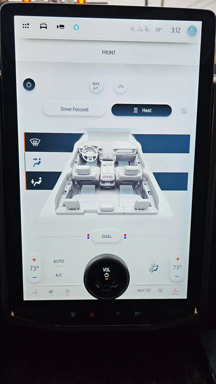

I set climate from Auto, turned fan on 4 and switched to windshield and floor last weekend and it seems to help my situation in the cold weather fogging up my windows. We'll see how it goes this weekend.
Ford F-150 Lightning Windshield fogging up in cold weather 20241215_151233
