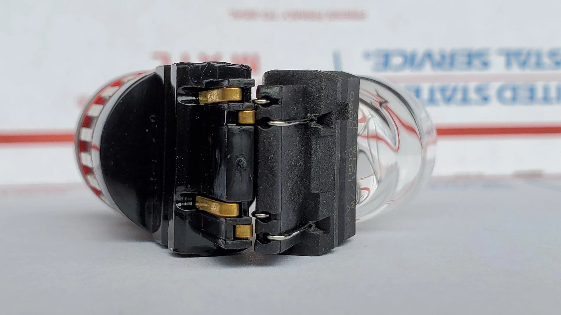

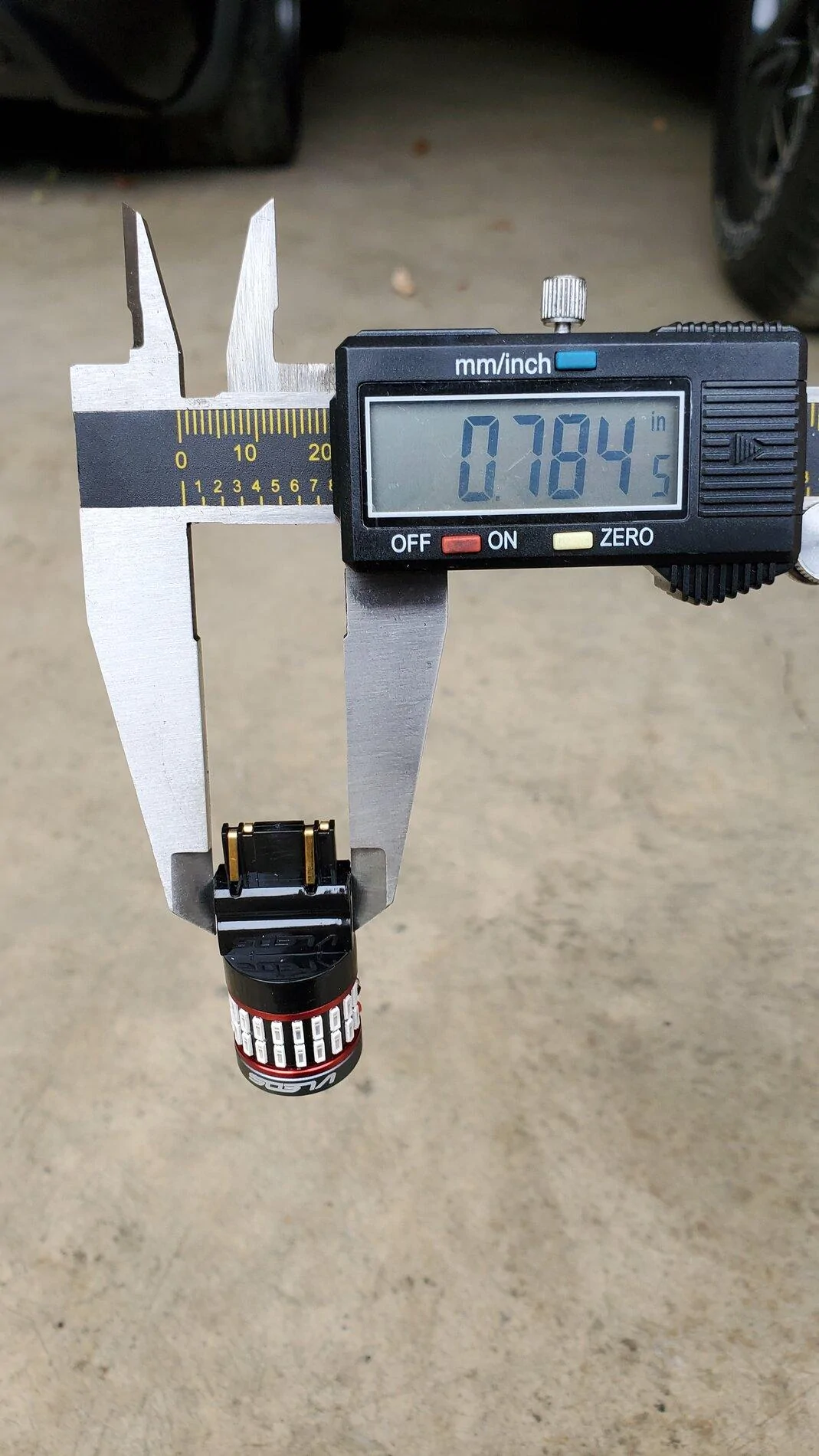

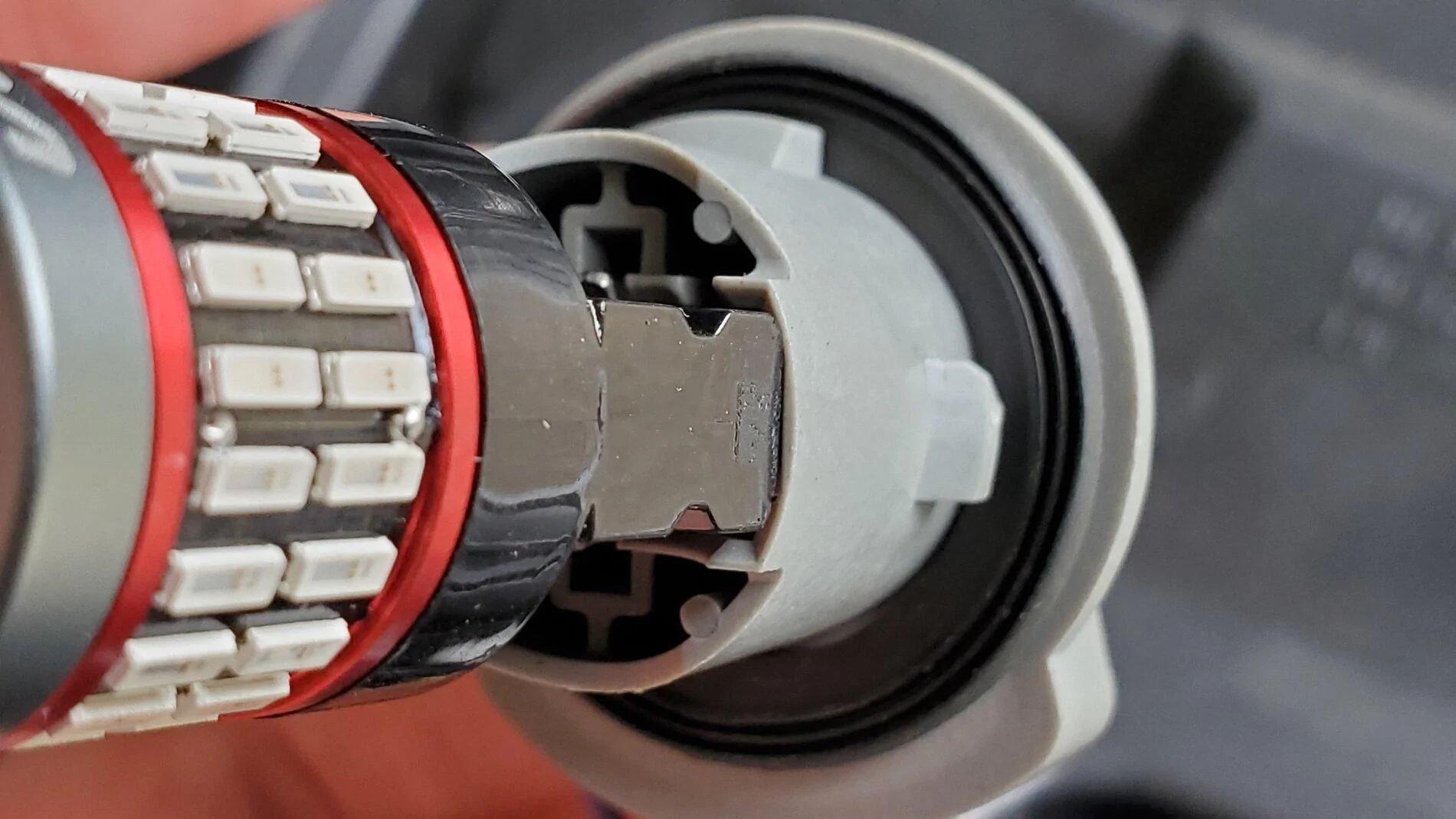

VLEDs told me their 4257 bulbs would fit but they were too wide for the socket. Could have filed them down but that would've voided the warranty if I had any more issues. Ended up returning them.

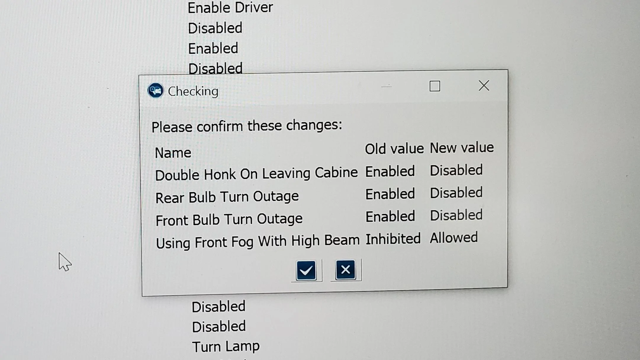

Yes you get hyper flash, but disabled it with Forscan!

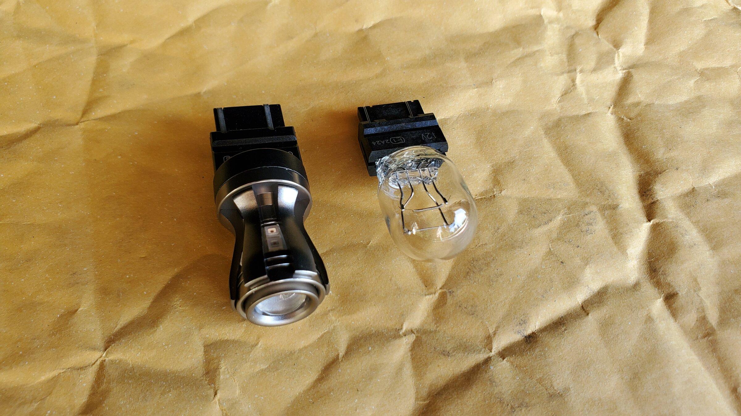

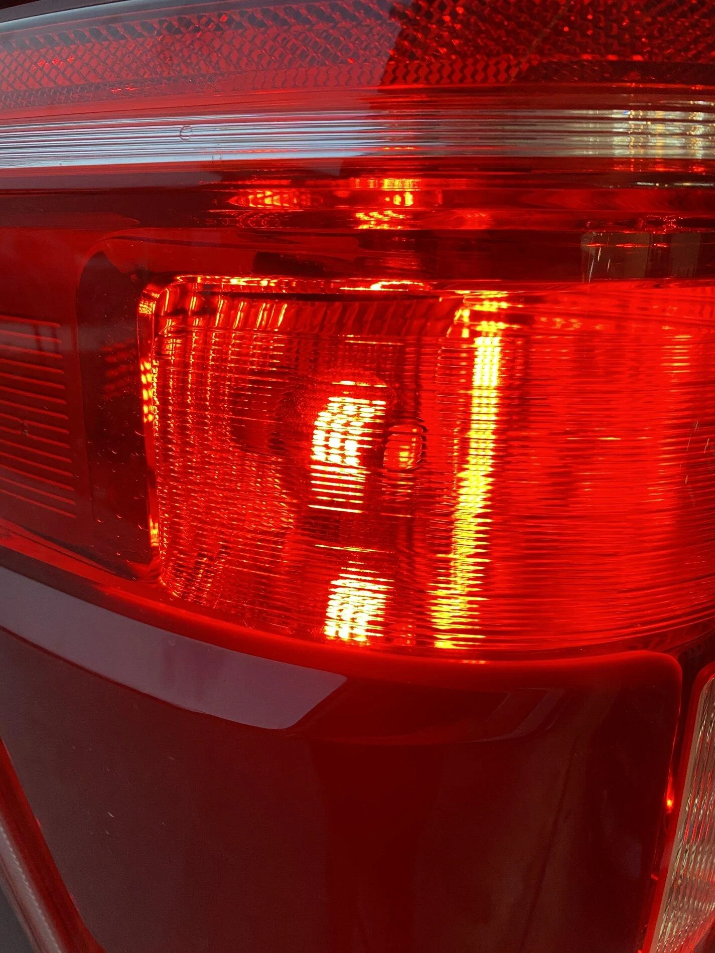

Forgot to update this thread. I found GTR Lighting 4257 bulbs from The Retrofit Source fit great and work well.
Ford F-150 Lightning XLT taillight LED bulb fitment? 20210902_150155
And for the hyperflash, it flashes at thw regular rate outside the truck but only the turn signal indicator inside the truck flashes quickly. If that bothers you, you can use forscan and disable "Rear Bulb Turn Outage"
