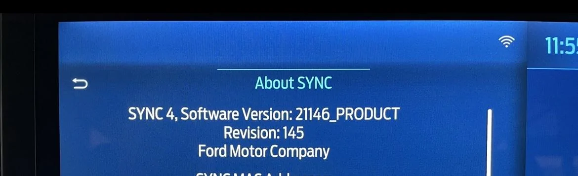

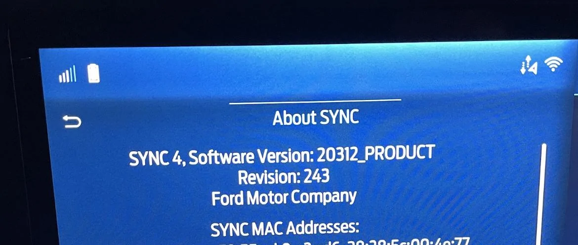

@Bob_Mac
Next question, got the APIM usb to kick off but now it shows I still have a software update in FDRS. Might be because I’m so far behind, haven’t had an OTA since November. Here is some screen shots. I only have today left on my license so any sudjestuons or just wait a few days and see if things progress like they should.
Ford F-150 Lightning ECU module programming guide using FDRS 1645986049036
Ford F-150 Lightning ECU module programming guide using FDRS 1645986093403
