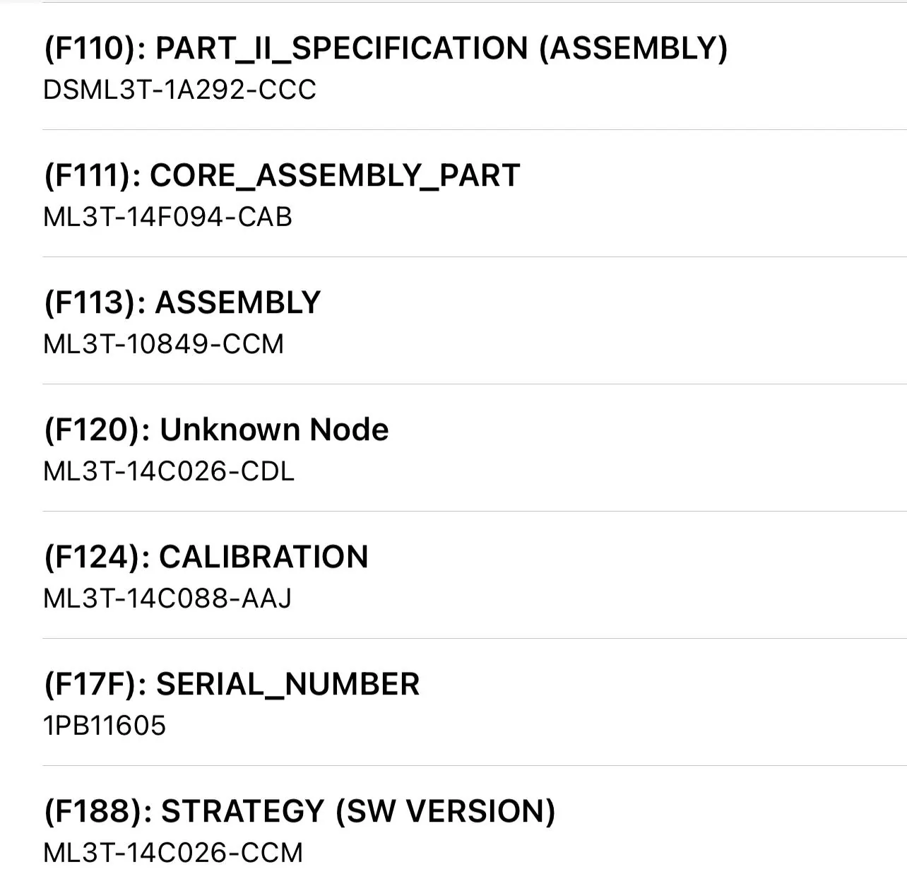

Those look like 5.0 cluster files? Is that what you have
Jesse-Infotainment
Jesse
751
756
2024 F150 Lightning Flash
Ok . So yes. What happened to you is what I believe is happening to everyone. It loaded the as build portion and failed everything else. To put into per this update should have taken hours.
Here is my current files on a V8 not updated !
Now his is ideal for comp sake.
Make of this what you want but three files should have been updated .!

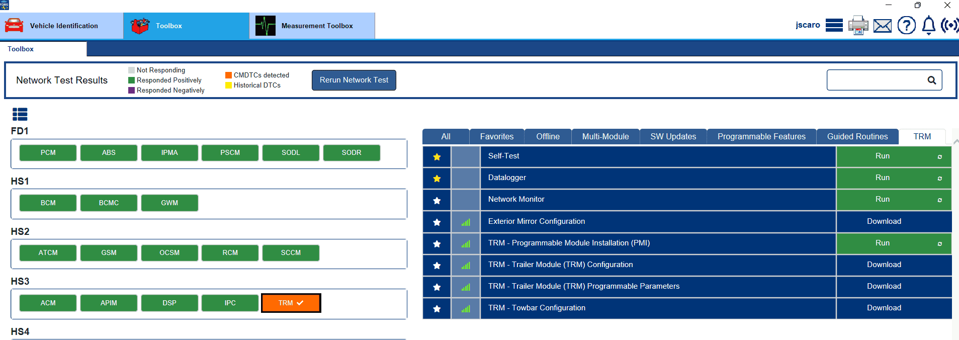

While in the toolbox click the All tab then click on TDM on the left side you should see a new tab show with TRM as it's label now click on TRM - Programmable Module Installation (PMI) then Download and run. Go through the prompts as if you already installed a new module and report back if that cleared your DTC
The GSM will not go away... disregard it as it appears to be a bug
OK @Bob_Mac , Downloaded and Ran the PMI, still shows DTC
Should I download and run the others?

Trm will have a dtc there is even a tsb about it.
