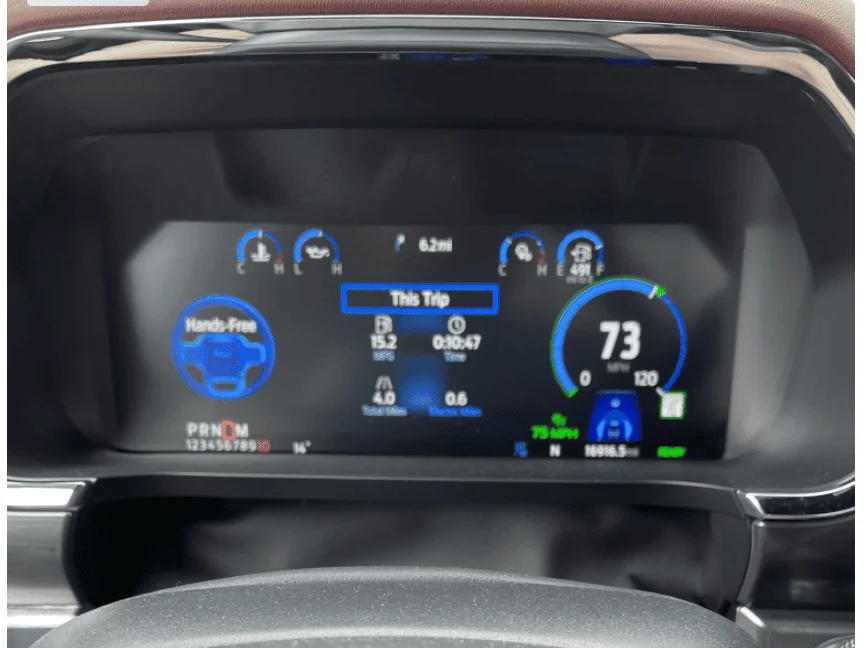

Shout out to the big players on this thread @Jesse-Infotainment @iceman77 @Bob_Mac @JEB @Snakebitten and others who give us the courage and path to make this happen. I won't clutter the thread with the details of my journey, but it was a lot of fun and I made it. I get to do it again with my business partner's truck. Job 1 build date 7/1/2021. And it now has all the goodies.
Ford F-150 Lightning ECU module programming guide using FDRS Screenshot 2022-03-29 190829
Sorry for the blurry picture, but the in-cab spy cams are sensitive!
