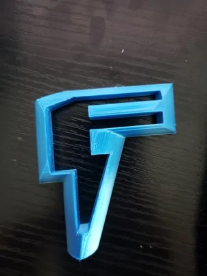

I like the other hitch cover lighting bolt that is available on thingiverse but wanted something different and liked this sites logo so playing with my own take on the design, printing the hitch part later, this is all done in PLA and if i like it will get some ABS and reprint it once its finalized.

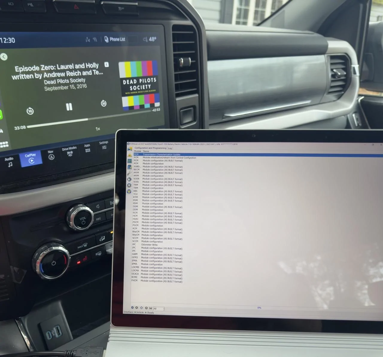

I finally got around to making some software updates to my '23 XLT via Forscan and did the following:
  • I tied the bed lights I installed a few months ago into my Zone Lighting and enabled the physical on/off button.
  • Changed my temp blinkers from 3 to 5.
  • Added universal window control (roll front windows up or down with key fob).
  • Switched all cameras to be able to be used at speed.
  • Turned on the glare free/matrix LED headlight feature.
Once you got Glare Free to work, did you notice that your normal auto highbeam feature no longer works when Glare Free is switched off?

Would you humor a random internet person and try it to see what happens? I'll mail you a cookie.
So I tried it last night. I turned off the updated Glare Free and yes, it switches my headlights to standard manual on off for high beams. Which makes sense. The Glare Free feature takes the place of the auto-high beam feature.
Thanks for confirming. Address for the cookie?
Would you mind sharing the selections you made to get the "all cameras to work at Speed"?
Also, do you happen to know how to make SPORT mode the default when I turn on my truck?
THANKS

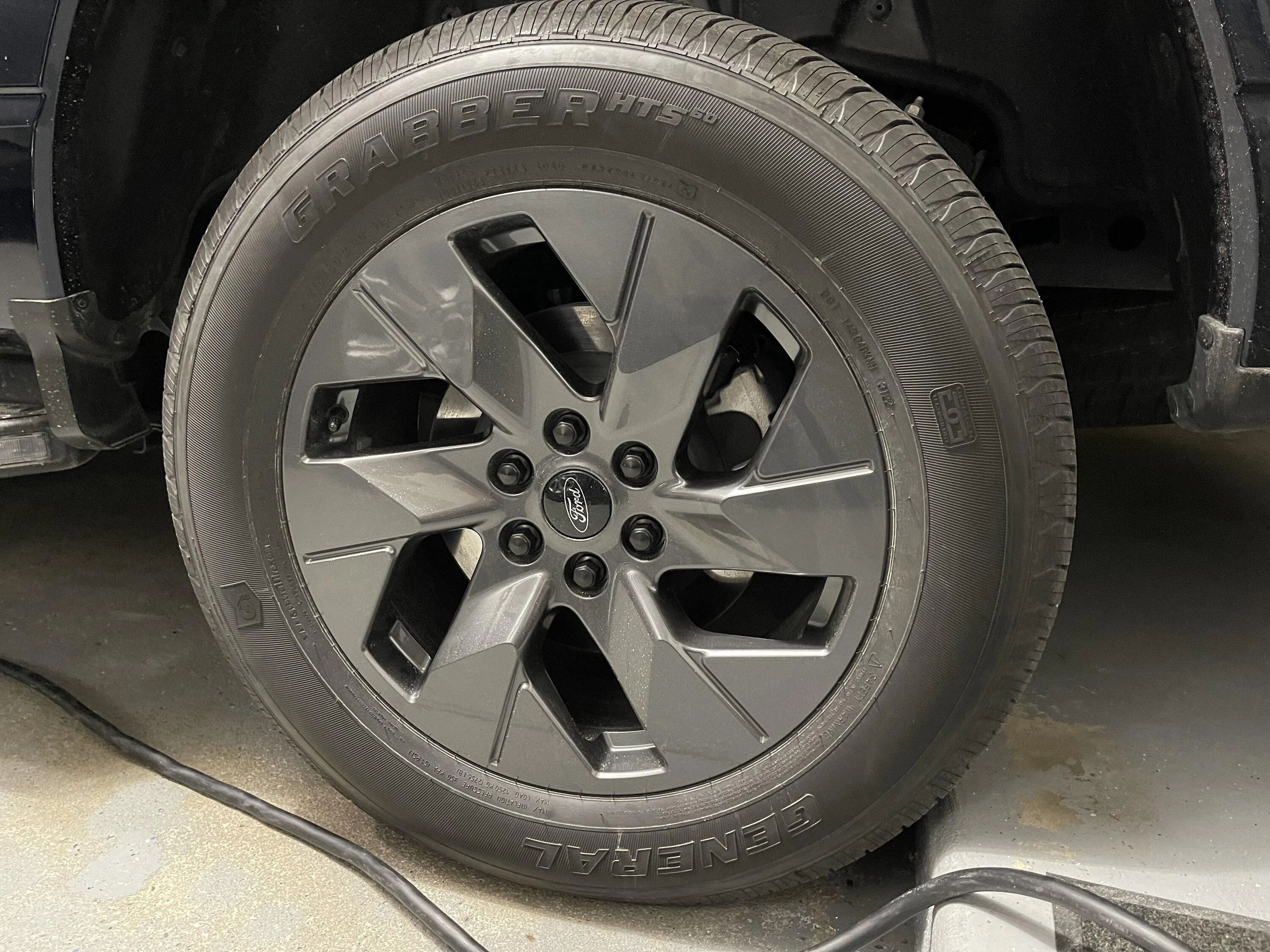

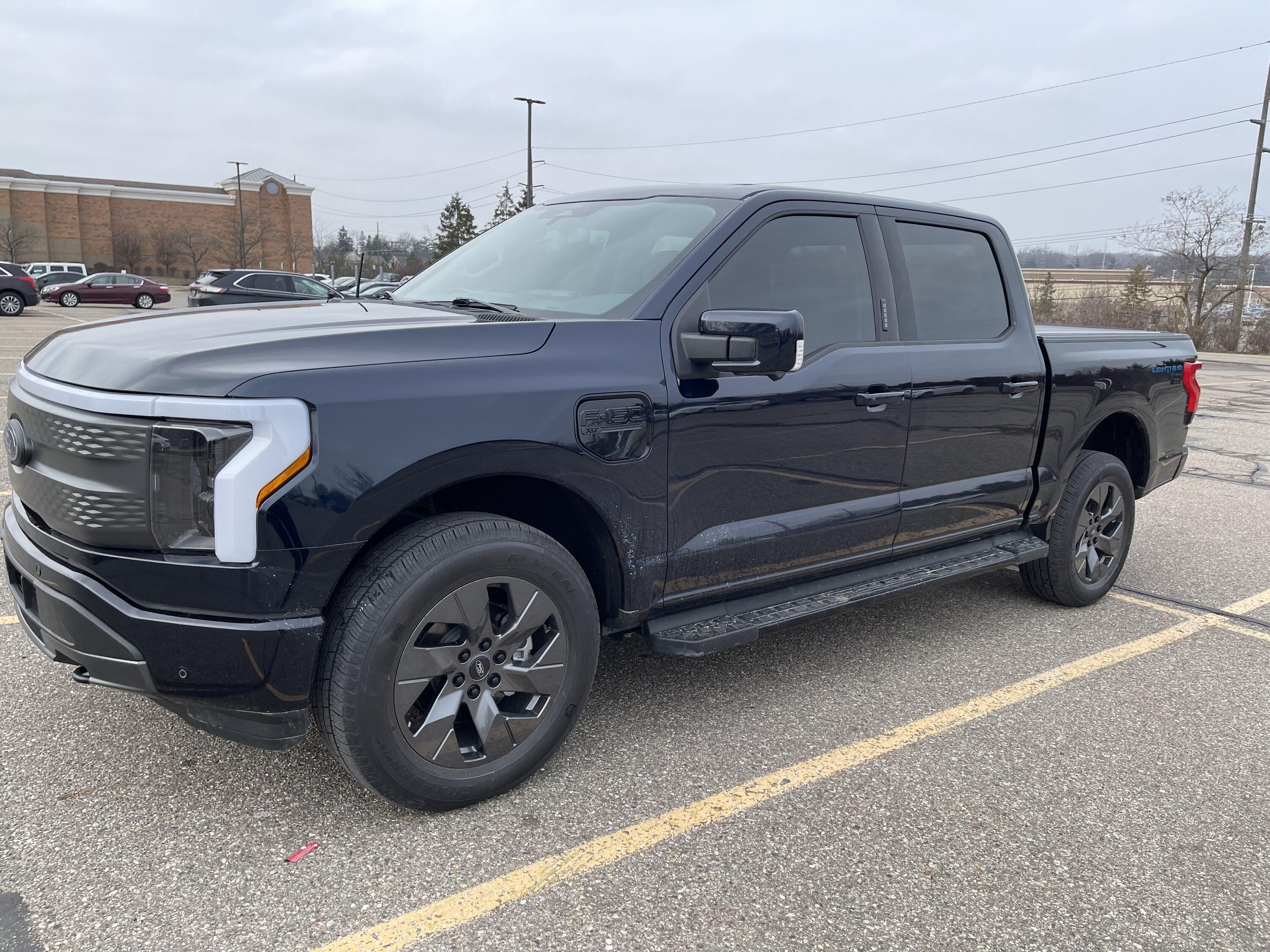

She is a little dirty and about to be more so with the impending snow coming this week but figured I would add to this post.
Added Ford official black lug nuts using some FordPass points after seeing many others do the same on this forum.
