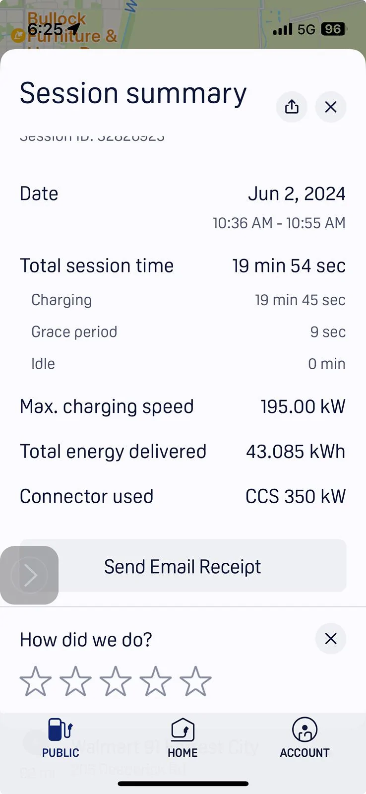

195kw Charging Speed

The “switch that allows 800v charging” is unlikely to be a retrofit- the battery pack itself is actually two battery packs; the “switch” connects them in series for charging (400v+400v=800v), parallel (400v) for driving.
GM employed this more expensive approach, after the Lightning was introduced without it (it’s the second rat that gets the cheese!). I guess Ford didn’t figure on the market being as range-sensitive as it turned out to be (to make a huge long-range battery pack charge at a reasonable rate, you need higher voltage). If faster charging becomes as important as extended range, perhaps future vehicles will have the split battery pack design even on smaller pack sizes.
