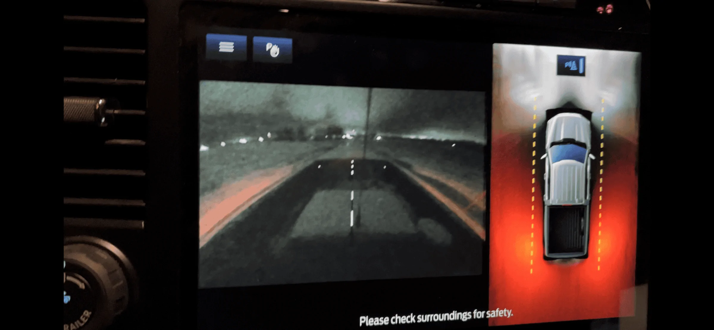

I too am on Power Up 1.7.1, and I was also able to use Livinit Up’s sheet to manually change those 3 lines in the 2 modules, reset the APIM, and then the cameras in motion works for me now also! First button press gives hitch cam and second press gives 360 view with cargo cam.

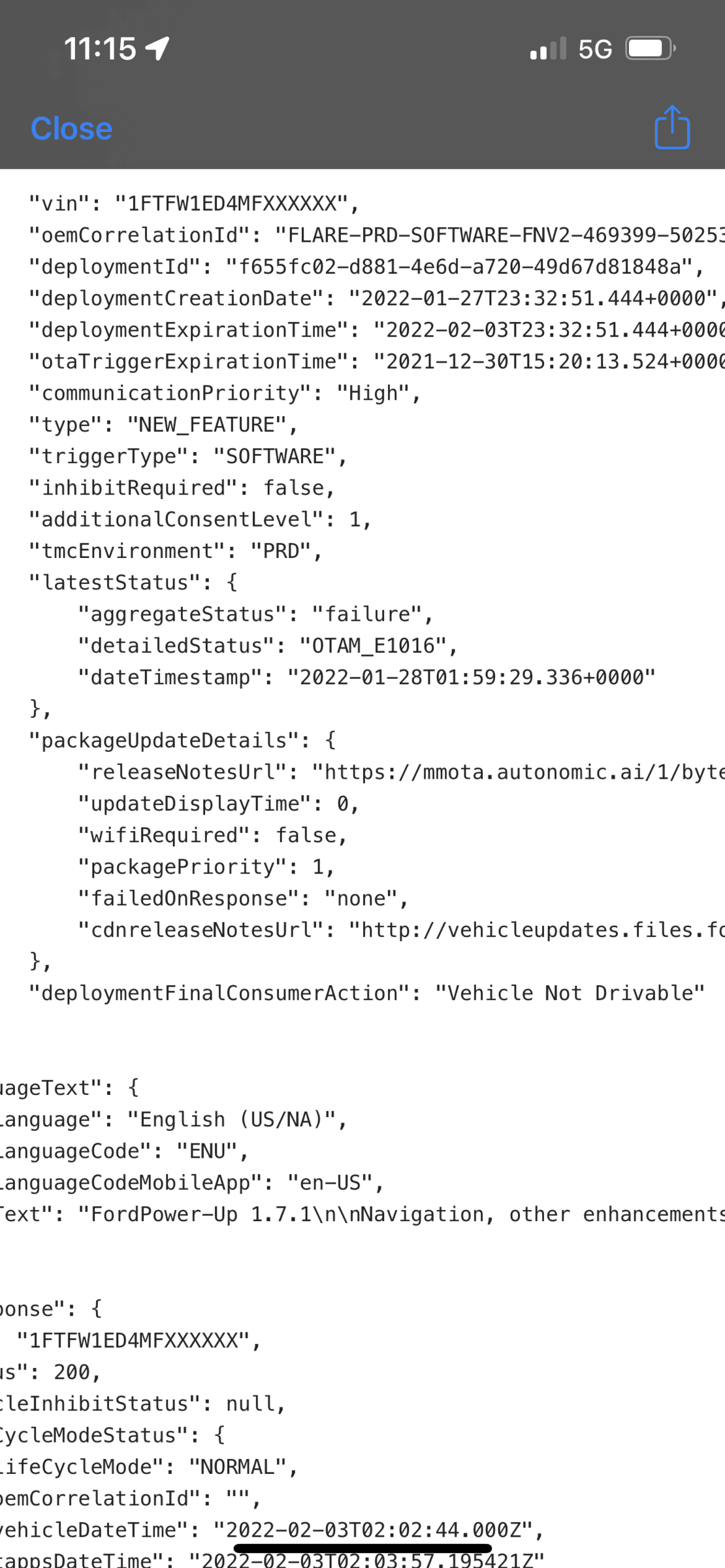

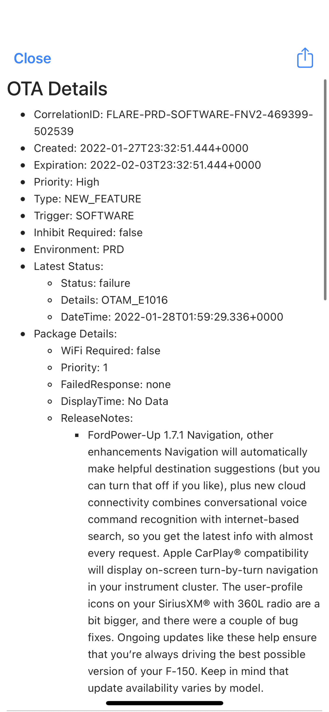

I have a job 1 Platinum Powerboost with 7.2 Pro Power, and Blue Cruise Prep, purchased on 1/15/21. The last update I received notification of was 1.7.1, on 7/28/21, and nothing after that. I have installed the widget and I think it also says I have 1.7.1, so I have included some of the raw data for assistance.
Maybe someone can help me understand why it says Vehicle Not Drivable. And, how can I tell the failed update version?

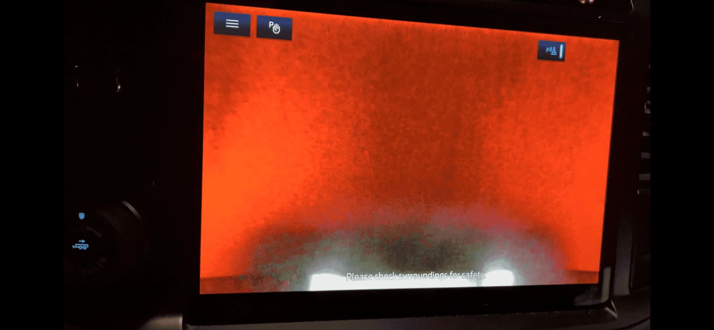

Bed Cam & 360 Cam In Motion:

Hitch Cam:
