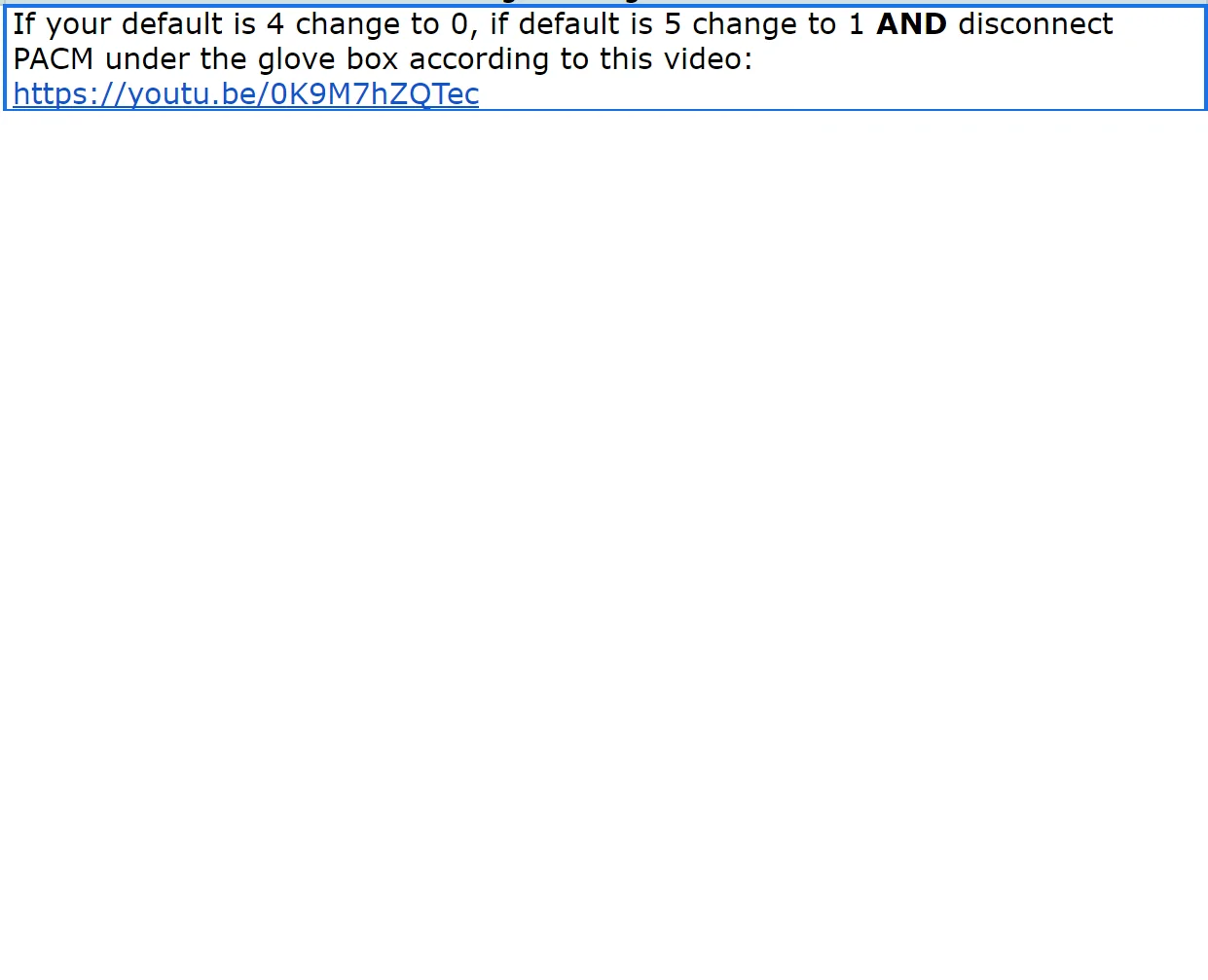

In regards to disabling the pedestrian alert speaker, has anybody done this successfully, going from a value "4", to a value "0"? I tried it on mine (has a 4 currently), but the speaker is still beeping in reverse as well as making the noise in drive. Any ideas?
imnuts
Mark
Mar 1, 2021
657
127
Dirty Jerz
'21 502A Powerboost 4×4
Facilities Engineer
Did you unplug the module as well? It was stated in the post that detailed how to do it.
