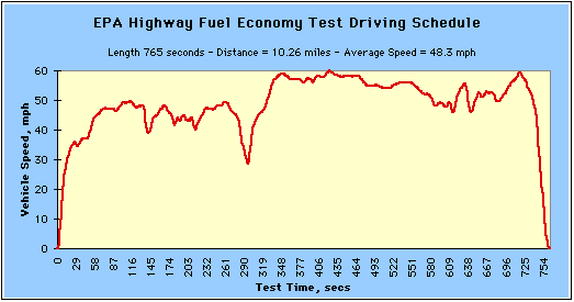

Presumably Ford will use the same EPA procedures for range testing the Lightning that they did for the Mach E. Remember folks: the EPA tests are a standard but they are neither real world, nor 70-80 mph. Here's a graphic of the test cycle for the Highway testing:
Ford F-150 Lightning 2021 F-150 Lightning With Extended Battery May Get ~460 Miles Range, Unloaded! 1608752323151
Some reviewers do a really nice job of testing at real highway speeds and using out and back on the same route to account for wind. Those will be much more informative than EPA cycles.
It will be interesting to see how many of them do loaded and/or towing tests as well.
