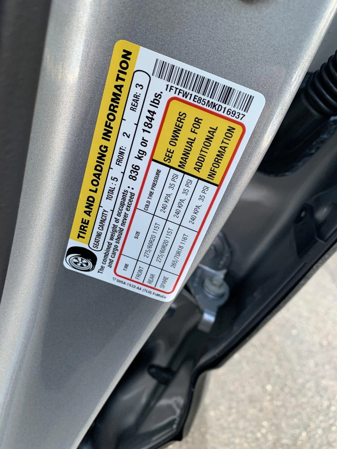

F150 payload can vary greatly from 1300lbs to well over 3000lbs.
A F 150 Hdpp has a 1.25 ton payload. Those old 1/2 , 3/4 ton ratings don't exactly reflect the payload any more. A f250 supercrew disel has a lower payload than a f150 HDPP

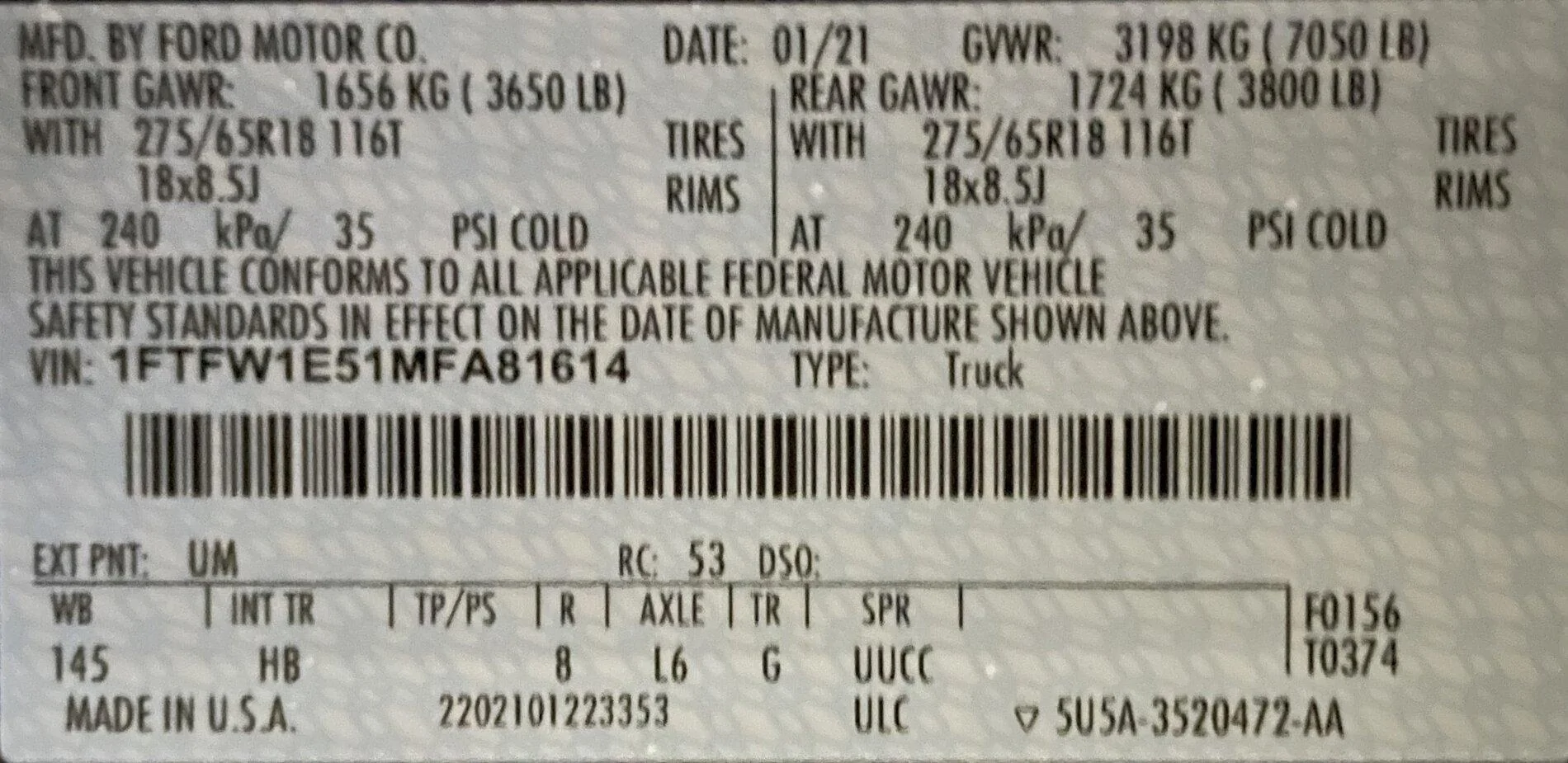

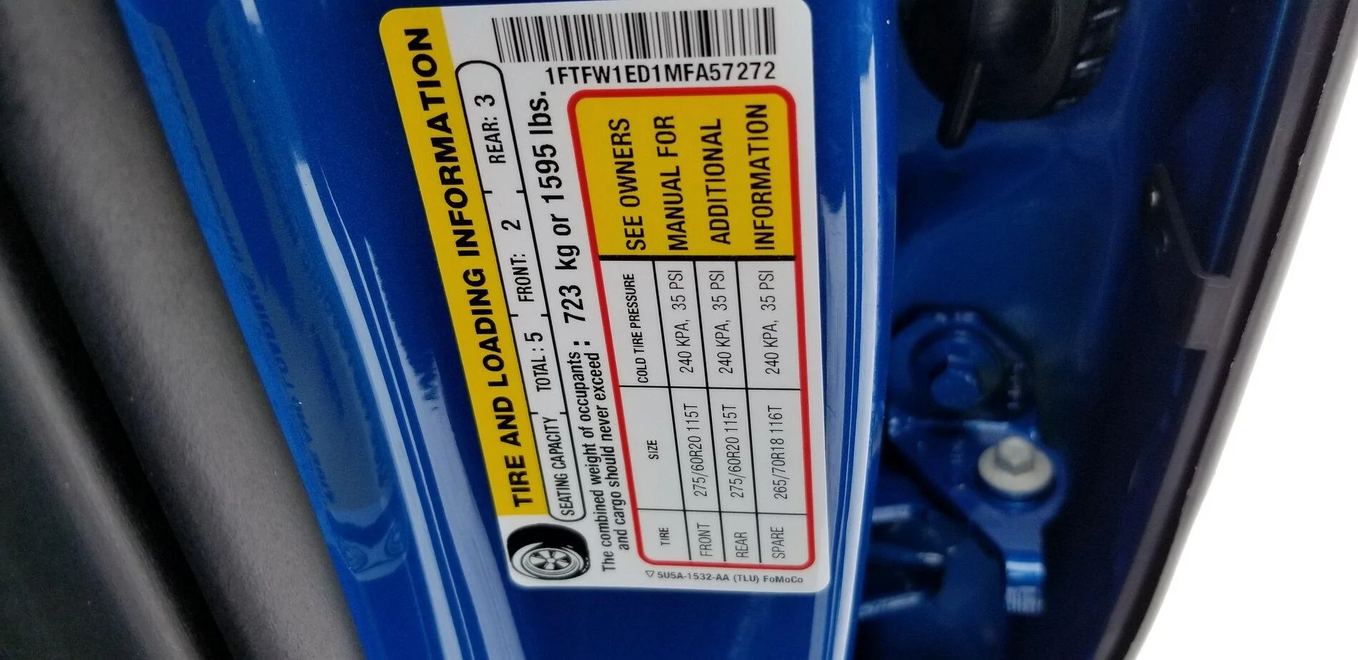

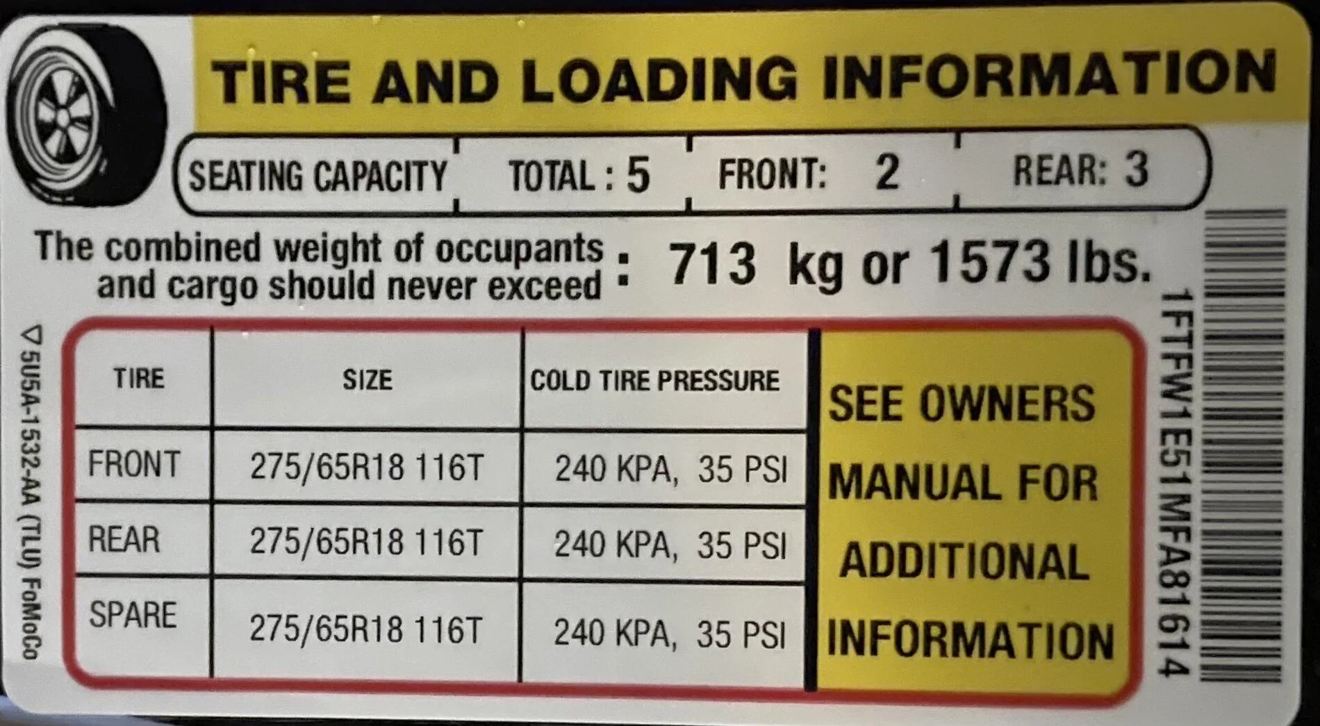

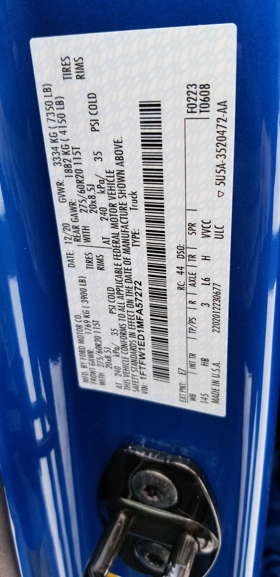

Pretty loaded Lariat sport screw with Max tow and FX4. Moonroof, Unleashed, and work surface/storage.
Ford F-150 Lightning 2021 F-150 Payload Stickers EE174666-1020-45B8-ABD9-99D0E15F3865
Ford F-150 Lightning 2021 F-150 Payload Stickers 4EAAEA9A-5B06-4869-B7BE-C08FA8D4D070
Ford F-150 Lightning 2021 F-150 Payload Stickers FC4DFE56-2570-4BD3-B1A7-E53710E80CBC

2021 F150 XLT 3.5 EcoBoost 502A Max Tow
One thing to note is that for the 2021 F150, Ford includes a 150 pound driver and 150 pound passenger in its tow capacity calculations. So you have an extra 300 lbs in payload and a full tank of gas that you don’t have to subtract if you were doing so before.
lcrain
Lawson
Dec 20, 2020
56
'21 F150, '95 911 c2, '97 miata, '98 M3/4/5
Do you have any data to support that? This is the first I have heard of that and it would be different from how it was calculated in the past.
jordandev
Jordan
Feb 26, 2021
107
Yes, as the towing guide states that is included in the towing capacity guidelines. But that is for the trailer weight limits. NOT meaning you can just add an extra 300 to the payload sticker.

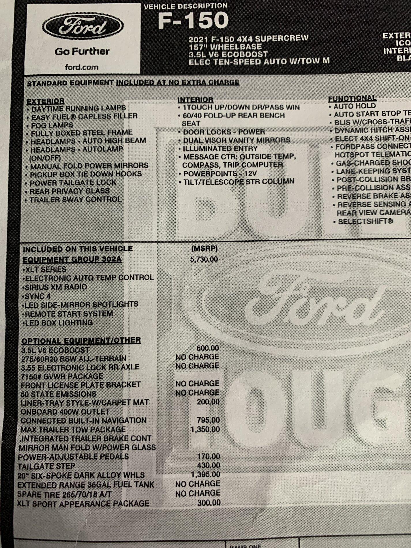

looks like you cannot get XLT V8 with HPP just Max Tow
EDIT: My bad! I had short box selected....

XLT 4x4 crew+6.5’
Ford F-150 Lightning 2021 F-150 Payload Stickers 255837EA-D197-4480-8AEF-EE2FBC13BE42
Ford F-150 Lightning 2021 F-150 Payload Stickers image
Why did Ford opt to not let us combine HDPP with 302a? Push people to superduty?
