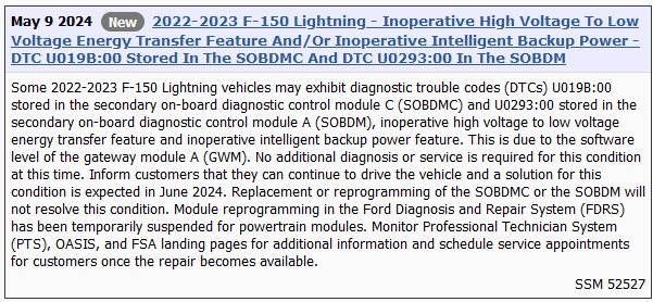

2022-2023 F-150 Lightning - Inoperative High Voltage To Low Voltage Energy Transfer Feature And/Or Inoperative Intelligent Backup Power

And another one this morning.
Ford F-150 Lightning 2022-2023 F-150 Lightning - Inoperative High Voltage To Low Voltage Energy Transfer Feature And/Or Inoperative Intelligent Backup Power SSM_52527_Lightning_Energy_Transfer

Winner winner, chicken dinner. I have these since i got my truck back after module replacement Monday. Repair notes indicated they updated PCM, SOB’s, etc.
I will monitor my 12V SOC.
===SOBDMC DTC U019B:00-2F===
Code: U019B - Lost Communication With Battery Charger Control Module 'A'
Status:
- DTC Present at Time of Request
- Malfunction Indicator Lamp is Off for this DTC
===SOBDM DTC U0293:00-2B===
Code: U0293 - Lost Communication With Hybrid/EV Powertrain Control Module 'A'
Status:

I have those same codes everyday as well.
