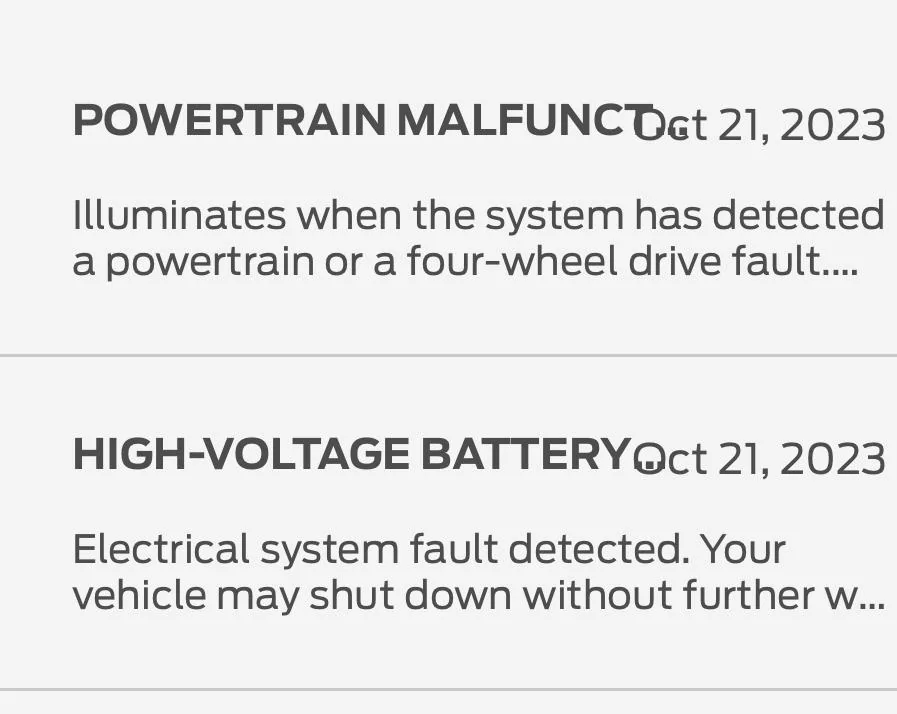

I just got the high voltage battery warning and a power train malfunction warning yesterday. It came suddenly without warning and I lost almost all power (could barely move the truck). Now I guess I need to get it towed to the dealer? Very frustrating.
I know a few of the more recent OTA updates have been targeted to avoid this out of the blue, not sure if you've been getting those.
I hope it's not too wild a ride for you - call the BEV hotline at Ford corporate and they might have information your dealer doesn't but will also reimburse any gas spent while your truck is out of service.
Best of luck.
