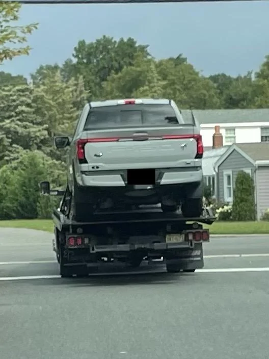

Shorevet
Nov 24, 2022
Virginia
Bronco, GT500, Ranger, Corvette
Defeats the value of an EV if it requires an ICE Flatbed to move around.
