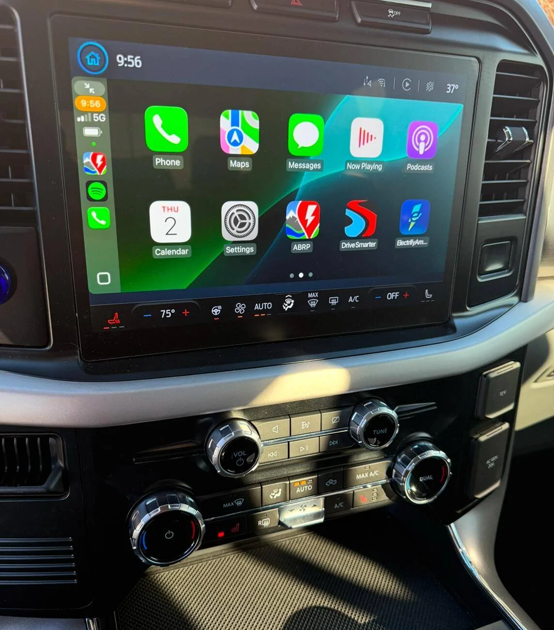

Success! Can't even believe I got it to work, but it does!!

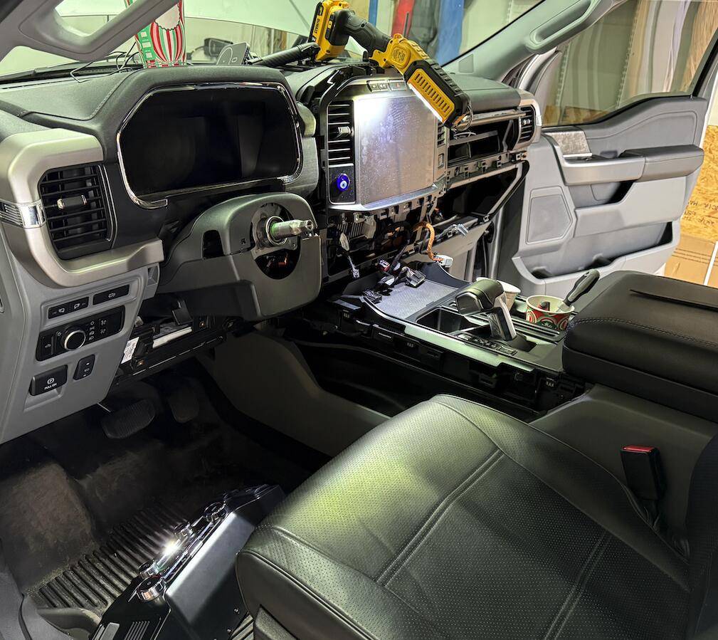

I was able to get a pair of Lariat Lightning seats to work on my '22 Pro. Big thank you to @lSherlockl for doing all the leg work, as well as @kdkool for his write up.
I took my time and completed this over the course of three weekends. Below was my journey...
The excel spreadsheet is your bible, study it, know it, trust it, it works. Took me a while to figure out what a lot of it meant but forums and youtube are undefeated ;)
Rear seat swap/install was fairly straight forward. I didn't add heated seats to the rear, so this was probably the easiest part of the project. Basically just remove the bolts, unplug a couple wires and do the reverse on the new seats. The trickiest thing was the latch on the driver side rear seat, that was a pain to get to as the lever pull had fallen.
Next, I worked on the passenger seat, the seat swap itself was again straight forward, undo the 4 bolts and wire harness and the seat pops out. While the seat was out I pinned all the wires according to the spreadsheet in the first post, wrapped the wires in some loom tape and set it aside while I installed the new seat. Once connected back to the truck side harness the seats/lumbar function as they should.
I drove with the truck like this for a week or two... no issues.

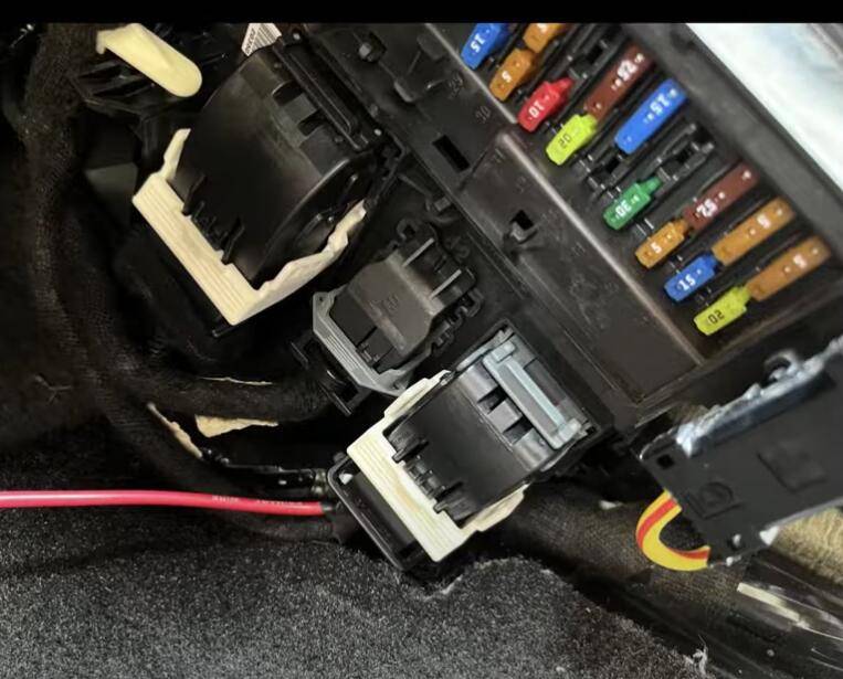

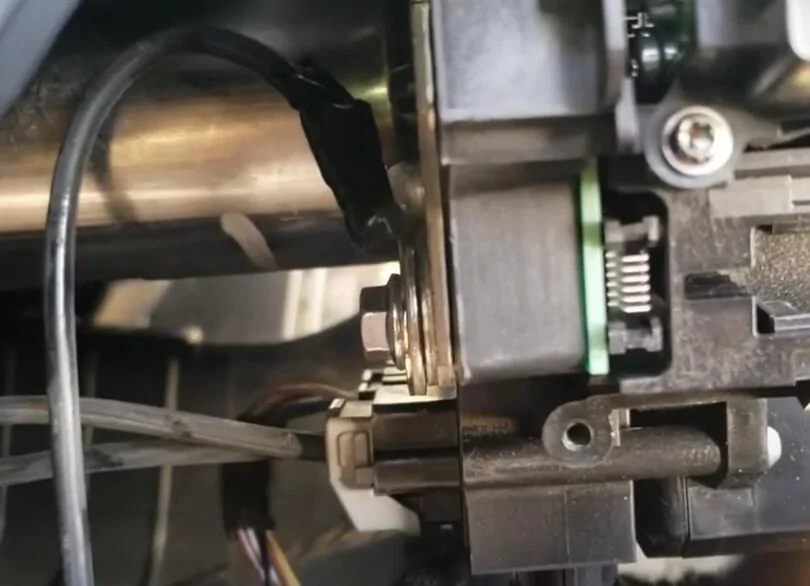

Finally, on to main event, installing the driver seat and running wires. Again, removing the seat was easy, 4 bolts and a wire harness. I also removed the center console completely so I could run the wires. I believe there is a write on how to remove the center console somewhere but basically remove the two trim panels from each side of the console, undo the 6 bolts (careful they can and will break with too much torque), undo the two (maybe three) wire connectors and it will lift right out. I ran my custom wire harness from the passenger seat under the floor lining to the driver side then pinned all the wires into the truck side seat harness, again according to the spreadsheet. I was then able to reinstall the center console. From there I ran the twisted pair to C212 and a single hot wire to C265 (F**k C265 and its location, it absolutely sucked getting it out), along the passenger side of the console then into the area behind the glovebox. Tapped and pined the wires accordingly then buttoned everything back up.

did some more work tonight and i have HSW working WWOOHOO
also what on screen controls look like with below settings changes how the main menu navigation works too no longer the bar on the bottom
So bear in mind this is still with the the pictured ICE HVAC unit (which cannot actually do heating or cooling) But i configured HVAC with stock PRO config via forscan, still need to ultimately try swapping back to stock hvac unit (or force re-flashing it) but keeping the ICE unit in there till i finish HC seat install.

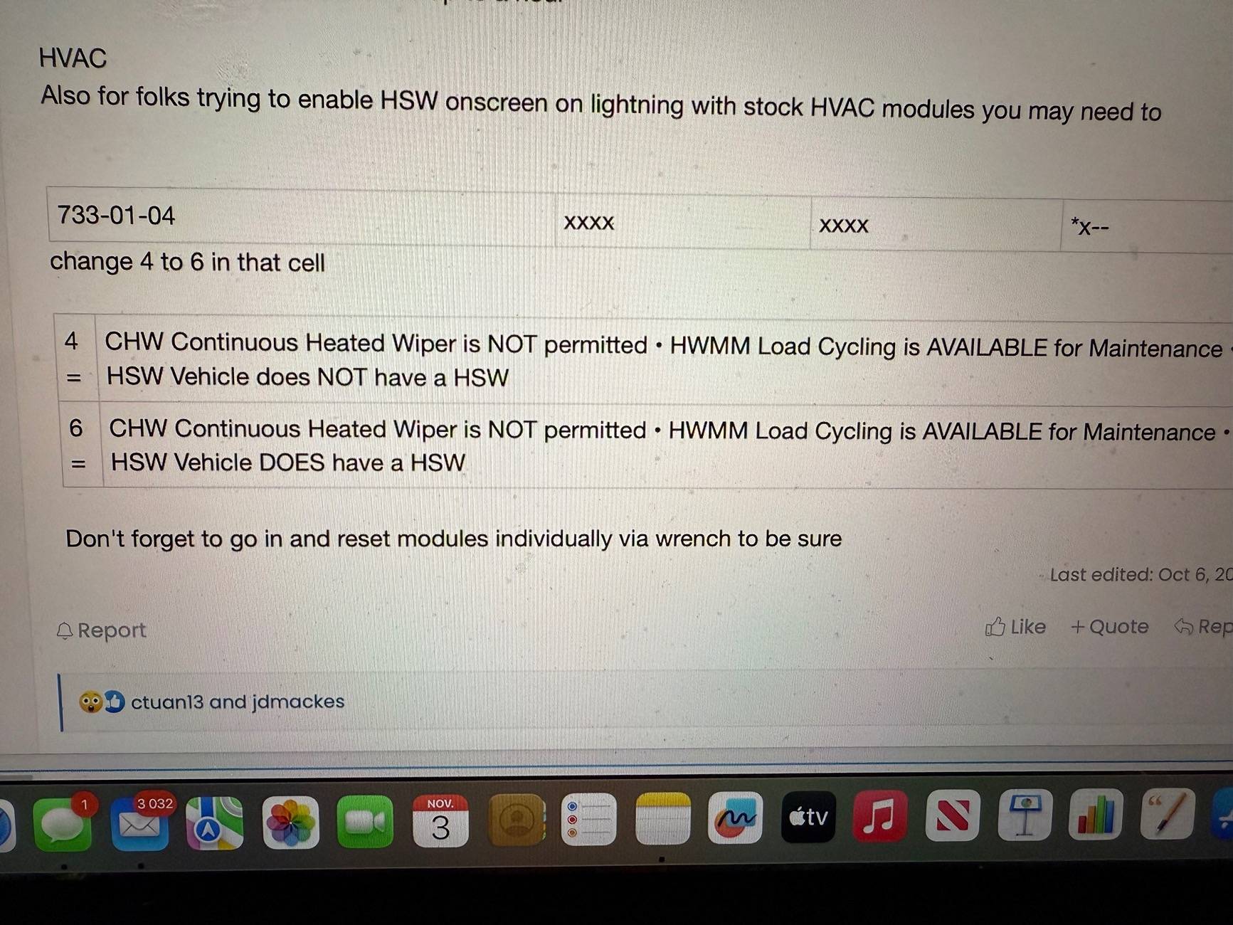

HVAC
Also for folks trying to enable HSW onscreen on lightning with stock HVAC modules you may need to
733-01-04xxxxxxxx*x--
change 4 to 6 in that cell
4 =CHW Continuous Heated Wiper is NOT permitted • HWMM Load Cycling is AVAILABLE for Maintenance • HSW Vehicle does NOT have a HSW
6 =CHW Continuous Heated Wiper is NOT permitted • HWMM Load Cycling is AVAILABLE for Maintenance • HSW Vehicle DOES have a HSW
Don't forget to go in and reset modules individually via wrench to be sure

I installed the ML3Z3F791BB and ML3Z19980K. I managed to install the harness as well, I used the pin slot 15. (not my photo, I got it from this, it helped a lot)
Ford F-150 Lightning 2022 Lightning Pro Seat Swap/Upgrade to Heated/Cooled 1735831354203-sn
Then I started Forscan. I realized I lost my heating (both ventilation and the seats), I guessed it was because of the ML3Z19980K and uninstalled that, installed the stock. I decided to go one by one to achieve a heated steering wheel, so I decided to decrease the number of variables.
When I installed the stock, I didn't have my heating, again. Then I thought something should be wrong in the forscan side. I got back to my backups, still no heat. I realized (of course, Murphy's Law) I didn't get any backup for HVAC, I thought that might be my case. But I didn't have any backups:) Then I found this website with some search in the forums and got my settings with my VIN. Then I checked one by one for HVAC module and corrected what I have. And I got my heating back. I need to be honest, It was a stressful 45mins for me :) (Please make sure you backup the modules you will play with!)
Then I started changing them again, according to what Sherlock told above.
And voila, I got the button and it's working.
Ford F-150 Lightning 2022 Lightning Pro Seat Swap/Upgrade to Heated/Cooled 1735833507161-jz
Is it done? no:) because there is no heat in the wheel. I must be doing something wrong.
I was thinking maybe it was because of the grounding point of the harness. But I exactly did the same thing in the video I mentioned above, so that shouldn't be the case.
Ford F-150 Lightning 2022 Lightning Pro Seat Swap/Upgrade to Heated/Cooled 1735832911287-fs

EDIT - SOLVED!!!
I decided to check the connections one by one to see if I couldn't connect them well etc, and started with the famous pin in the slot #15. I realized that I put it in the wrong slot 🤦‍♂️ Another lesson: don't work for 9 hours in 25F, you make mistakes that you don't realize :) I put it in the correct location, and now it works!!! Finally!
