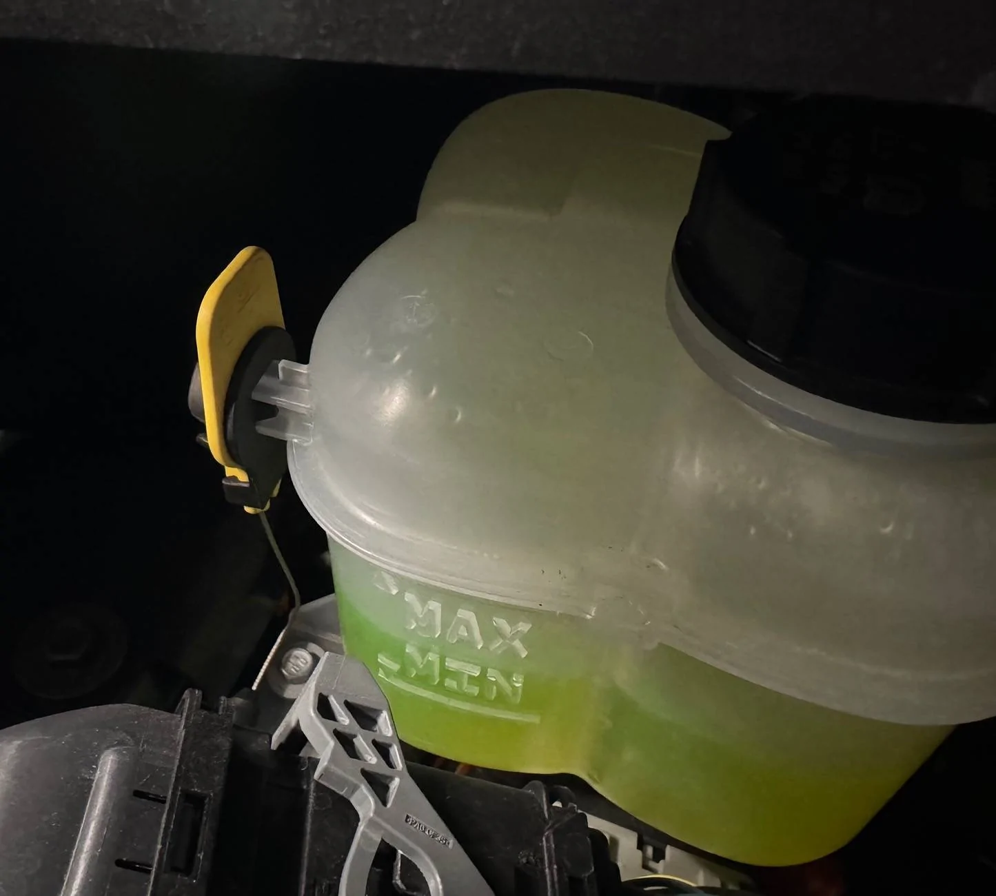

I'm grateful for the input. Going to let it sit overnight, put enough coolant in tomorrow to get closer to the Max line, and will keep you all posted. I'm gathering heat should clearly come back soon, so won't wait too long on that.

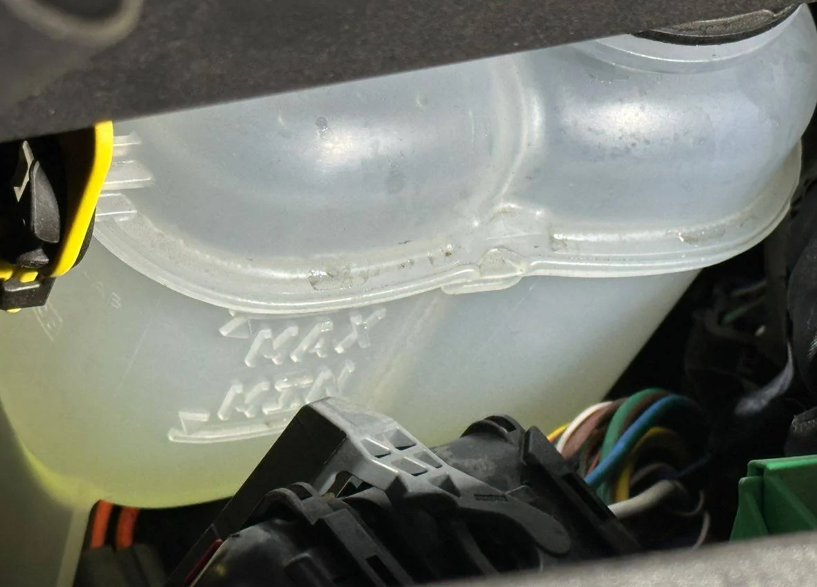

Update, I added an additional 1 quart of coolant. The level in the reservoir was near the Max line. Drove around for about 30 minutes, hilly areas, heat (actually cold) on blast, no joy on the heater. Came home, coolant level was about exactly midway between Min and Max. Coolant is definitely working through the system, hopefully pushing out air pockets. Seems to be holding steady there. No signs of leaking underneath the truck, on the pavement, or anywhere I can see underneath with a garage creeper & flashlight.
Going to try again tomorrow. On the plus side, temps are above 50 again :)
Here is a video that shows what your dealer should have done to remove the air from the system. This video shows the air removal from a Mach-E with two reservoir bottles, but the process is the same for our one reservoir bottle Lightning. Go to the 29 minute portion:

I think at this point, it is a dealer call. You've taken the steps to remove the obvious. Let them fix it now.

I ended up having to add about 3.5 quarts total until it finally has a steady level. My heat has now returned to really good levels. That being said mine got progressively better each quart I added, so you may have a secondary issue. When it was bad I could feel my heat cycling on and back off (warm air to cold air and back about every 10-20 seconds).
The good news with mine is that there seem to be no permanent damage issues. I took a 5000 mile road trip being 3 quarts down in the middle of the summer. I started hearing sloshing sounds when at charging stations and should have checked sooner. It wasn't until I researched on my heat cycling issue that this forum pointed me to the answer.

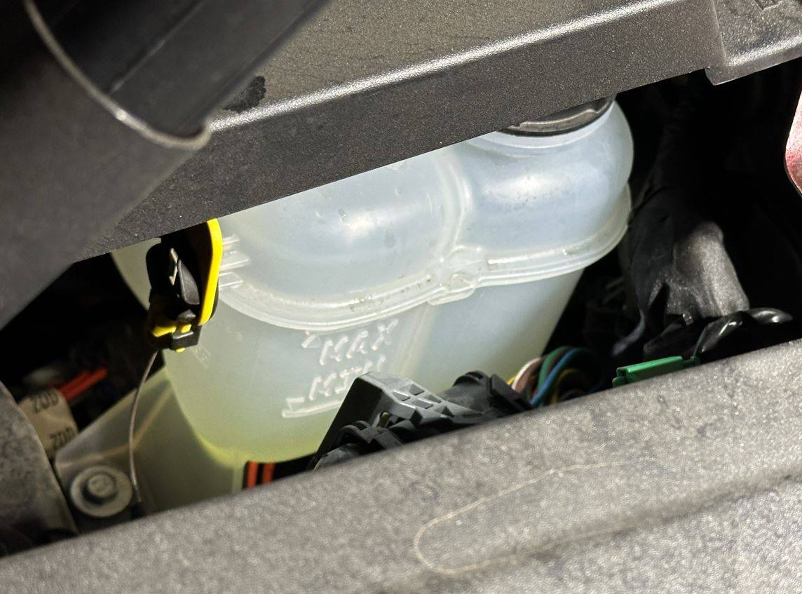

It's been about a month now. I've added coolant 3-4 different times since January. Thankfully, it hasn't been exceptionally cold, but the heater is still not working. In the beginning, when I had no coolant, the added fluid would go down very quickly after driving. Fast forward a month later, I just added maybe a cup of fluid to get it close to Max level after driving for 2 weeks. Hence, the coolant level seems to be settling...maybe finishing distribution?
But, with no heat, no doubt I need to take it in. I also have a recall now "Upper control arm ball joint nut replacement." I have no idea what that is or how serious it might be, but seems I can get that and the heater done in the same drop off.

It's been about a month now. I've added coolant 3-4 different times since January. Thankfully, it hasn't been exceptionally cold, but the heater is still not working. In the beginning, when I had no coolant, the added fluid would go down very quickly after driving. Fast forward a month later, I just added maybe a cup for fluid to get it close to Max level after driving for 2 weeks. Hence, the coolant level seems to be settling...maybe finishing distribution?
It'll be interesting to hear what they find, either PTC or diverter valve are most common failures.
