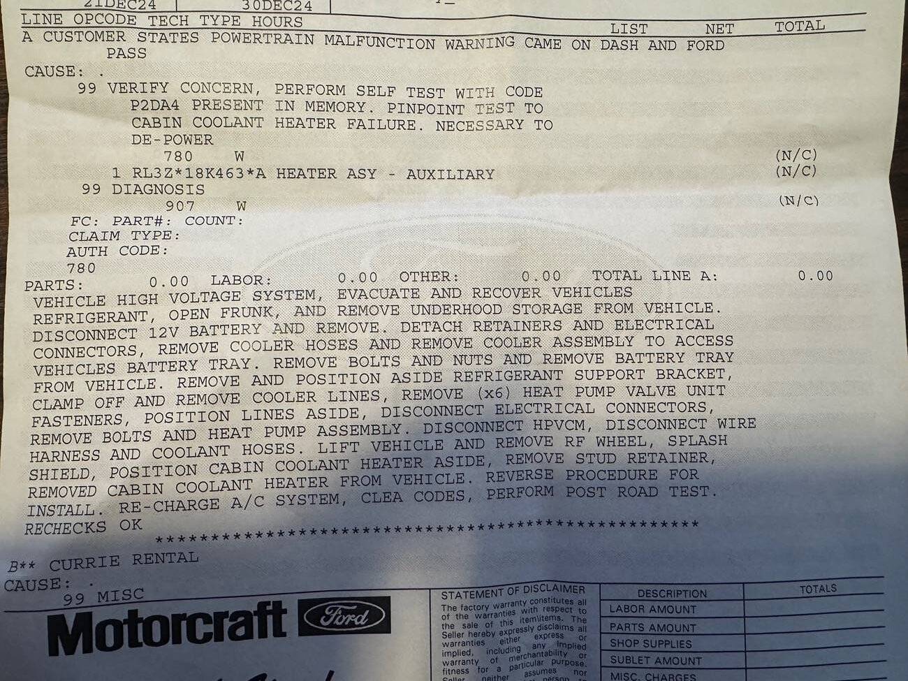

You are having a nearly identical experience to mine (also 23 Lariat ER). It was just starting to get cold in Idaho when I realized my heater wasn't working. I tried filling coolant several times and the level just kept going down, still no heat.
Eventually my service appointment was up and I took it in. Long story short... They tried everything and eventually replaced the heater itself. In the process they did find a coolant leak, so that was a good thing to find and fix.... Where did it go, though? Not on my driveway. The coolant level has been great since. The heat is great now, too. Unfortunately it took them longer to diagnose and fix than I would like, but overall had a good experience with this dealership.
My dealer also did all the CSPs which was great because with the sensor update Blue Cruise works nearly 99% of my freeway time now.
Take it in... ASAP. You'll thank yourself when you are warm again.

Hey everyone, final update here:
I brought the truck into my dealer last Monday. The intake tech was not very friendly, telling me that there were also all sorts of battery codes and that it would be a very long time until I saw my truck again. I then got a call from another tech saying that they confirmed that the problem was my heater assembly and that they had it ordered and it would be fixed soon. I asked about the battery codes the other guy had told me about, and he said that they weren't to be concerned about and were likely due to the battery being cold without the heater working. I got my truck back yesterday, a week after I brought it in and the heat is strong again. I also had the shop do my truck's first "EV service" while it was in. Everything checked out just fine.
Key takeaway:
Heaters might be an issue, especially on 23's. I believe a select run of 23's were recalled for the heater.
Check your coolant levels. Forum techs suggested checking coolant levels when my heat went out, and while that didn't fix the problem, my coolant level was well below the tolerance set on the overflow reservoir.
Thanks again to everyone who weighed in and advised on this issue.
