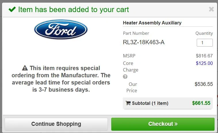

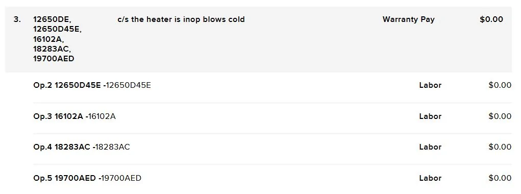

The results are in! A faulty heater is what I am told. I have some screenshots to share since many of you are far better at deciphering the lingo than I. Curious to hear if anything more detailed can be distilled from it.
From a customer perspective, Chapman Ford in Scottsdale took great care of me, had a loaner ready upon request, and remedied all this in a couple days. For those folks in AZ, the Chapman team has been great with EVs. So consistent, reliable, and strong customer service-wise that we make the 3 hour round trip to go there. Highly recommend.

https://www.tascaparts.com/oem-parts/ford-heater-assembly-auxiliary-rl3z18k463a
