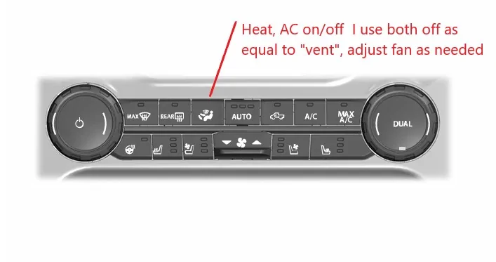

I am not sure if your dash is similar, but I use this button to cycle heat on and off as needed:
Ford F-150 Lightning 23 XLT...Heat Off but Fan On Adjusting heat & AC & vent
This works. When you press that button, additional HVAC options pop up on the screen and one of them is a button to turn heat off and on without affecting the blower fan speed. Thanks for the info.
