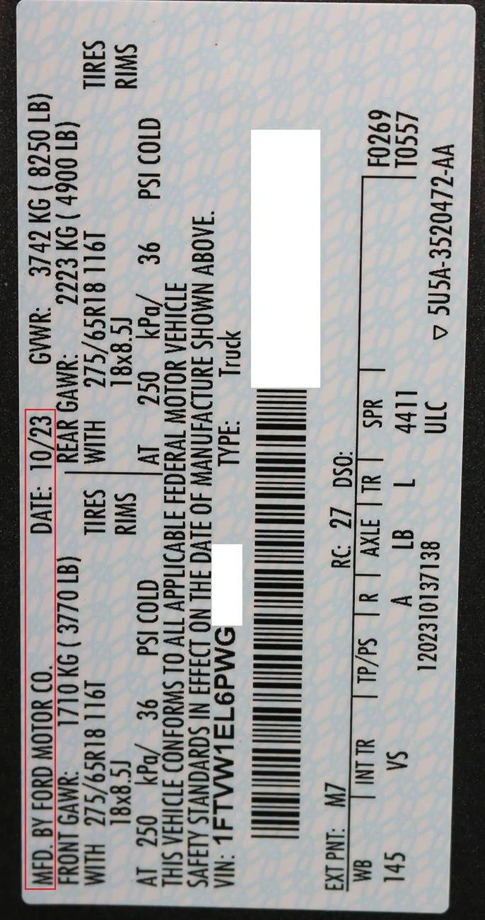

PS: look for the date of manufacture on the door sticker. Mine was a 2023, bought in Jan 2024, but it was manufactured in Oct 2023, so only a few months before bought.
Ford F-150 Lightning Found unsold '23 XLT ER:  Battery implications from sitting 2years? IMG_5731-mfg-2023-10-edit out vin
221
16,147
18,157
Your truck was expected to be built on Friday the 13th of October
