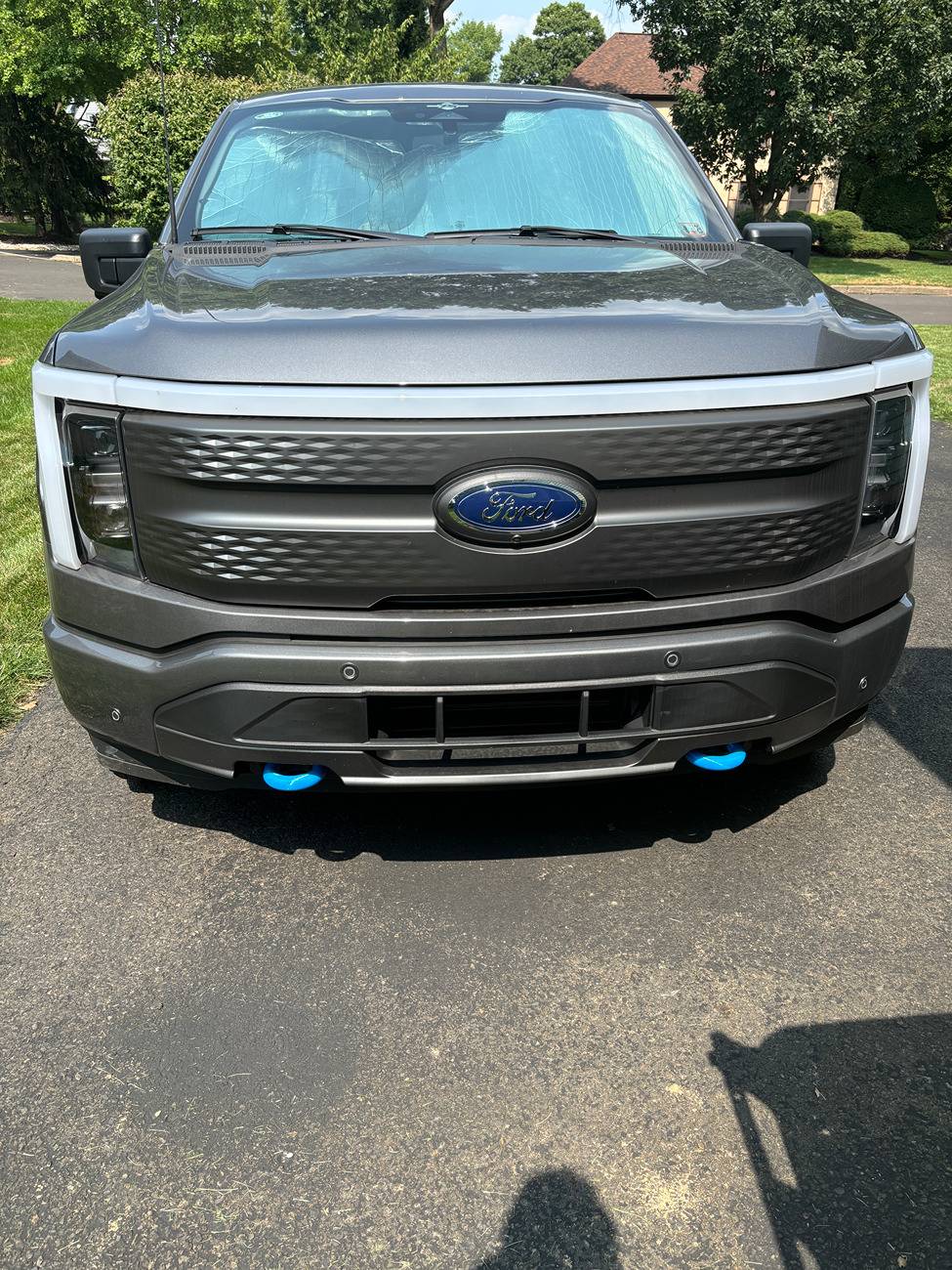

@FLSpartan04 I purchased a set of the tow hooks you made all the way back in August and never got around to writing a review on your etsy page. They turned out great, thanks!

Thanks! They look great! Considering it all started in this very thread, I love to see Lightnings with the Lightning Blue covers the most. But things have branched out since then. 😆 I can’t believe how many products I now offer, and it has all been by request with people finding my Etsy listing for Lightning Tow Hook covers that started here. Even have my own website now! www.TuffTrucks.Club
