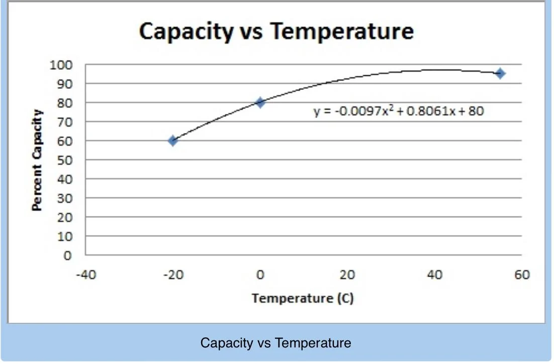

Preconditioning (warming) the battery in cold conditions will maximize charge/discharge performance. Here's a list of best cold weather practices from the Tesla owner's manual.
Does that apply to what the Ford rep said?
It sounds like the Ford rep said it needs to warm up as it drives and the range will increase (I'm basing this off the fact they were driving the truck, not charging it, at the time the claim was made. That's very much different than preconditioning a battery that's plugged in and charging before you start driving.
I didn't see anything on that link to suggest range will increase as you drive. I am very skeptical that the range increases as you drive the Lightning due to the battery "warming up" as the rep stated.
