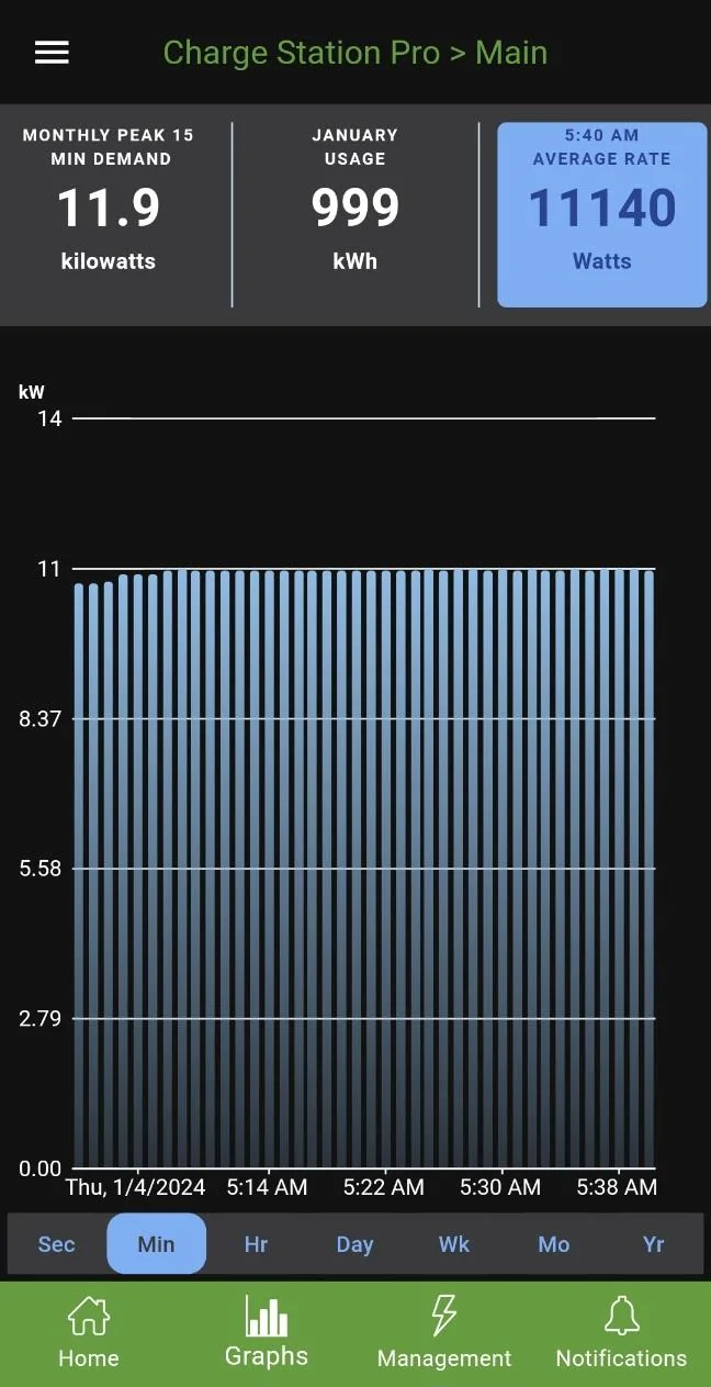

If you really want to figure out the numbers, get an Emporia energy monitor. You'll need one rated for a main panel if you're using the Charge Station Pro. The individual circuit monitors are not accurate above 50 amps. You can then track how much energy you are putting into the truck preconditioning and compare it to the energy your truck consumes on your commute without it.
https://shop.emporiaenergy.com/coll...s/gen-2-emporia-vue-whole-home-energy-monitor
Ford F-150 Lightning DC Fast Chargers not recognizing 320 mile range Screenshot_20240104_125658_Emporia Energy
