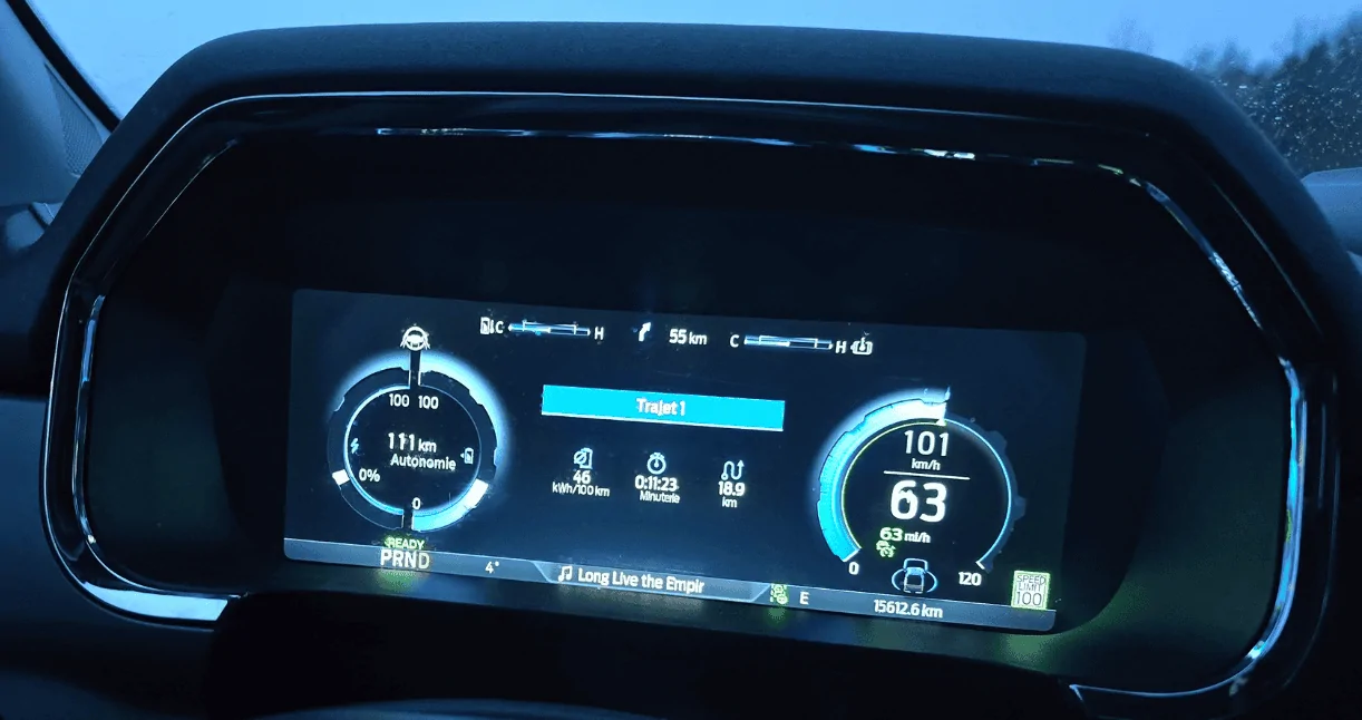

So it's normal? To simplify, whatever the conversion whit an extended battery at 60mph I'm able to make 160 miles total . 110 miles at 75Mph
In no way was I referring to your situation. Just trying to help people see the different ways that efficiency is displayed. I'm not able to respond on if it's normal or not. I don't live in a place that gets nearly that cold. What I can do is run a few factors that have been observed.
  1. EVs don't like cold. 4C will cut about 1/3rd of the total capacity out of most batteries, the F150L actually handles cold a bit better and only seems to loose 25%. The car won't show you this in lower battery capacity, but will instead display it as lower efficiency.
    1. 320 x 0.75 = 240 miles
  2. The heater in the Lightning is not great from my understanding. The AC is actually less impactful on range. I don't have a figure for that, but I think using a decent amount of heat could explain maybe another 15-20% cut to your range.
  3. The EPA range test is shit for comparing highway driving to. It's a "mixed use" test and does half at 55MPH or something like that, and half in stop and go. EVs with regenerative brakes do really well in stop and go.
I would have thought this was low, but the more I consider it, yeah, this might be normal for those temps.
