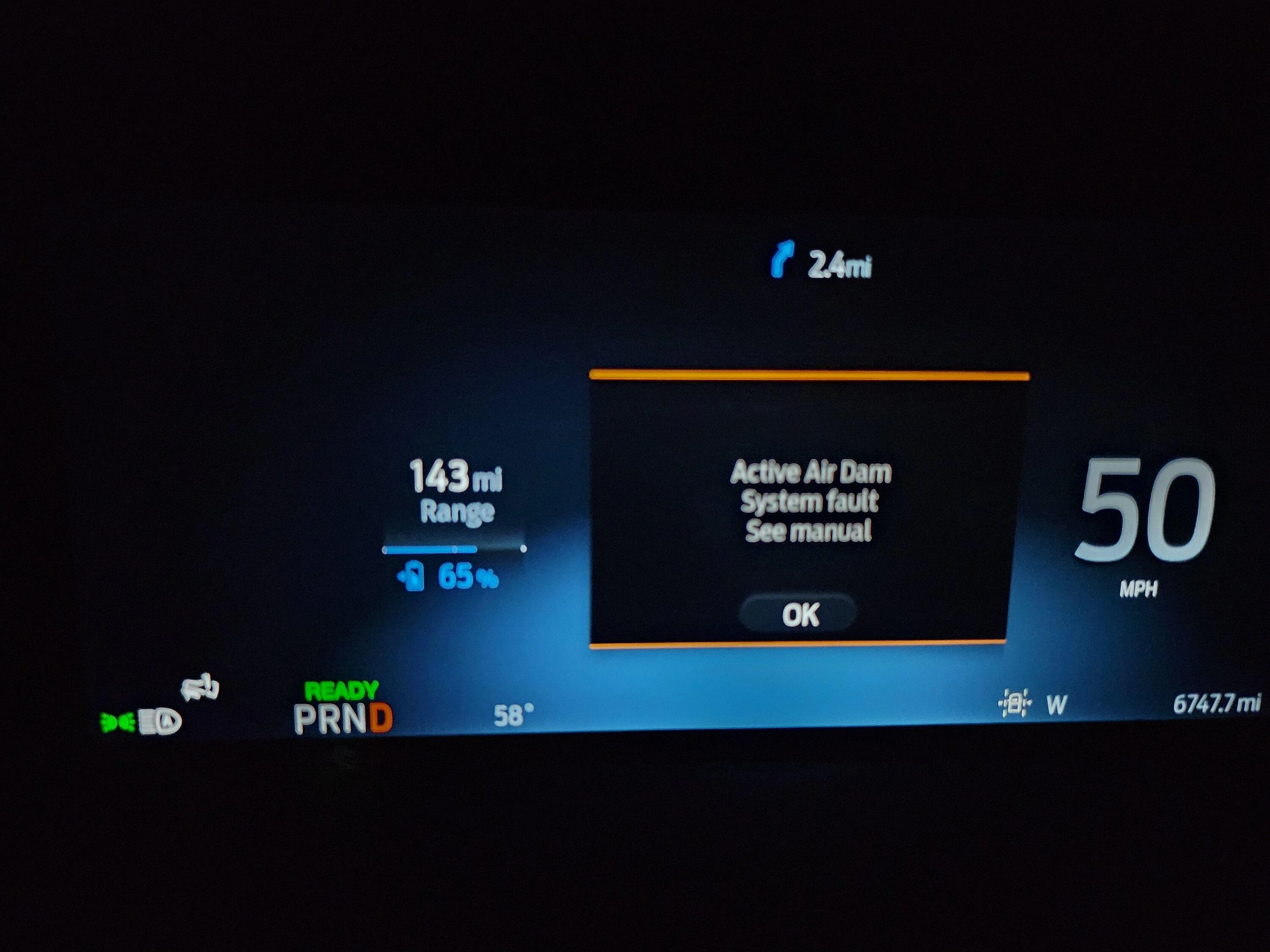

Does this fault affect our mileage?? Coming home from Oregon it errored out, on a downgrade, and it wouldn’t get better than 1.7 on some downgrades I would get 1.9 easy in the sierras. Anyone experience similar with this error?

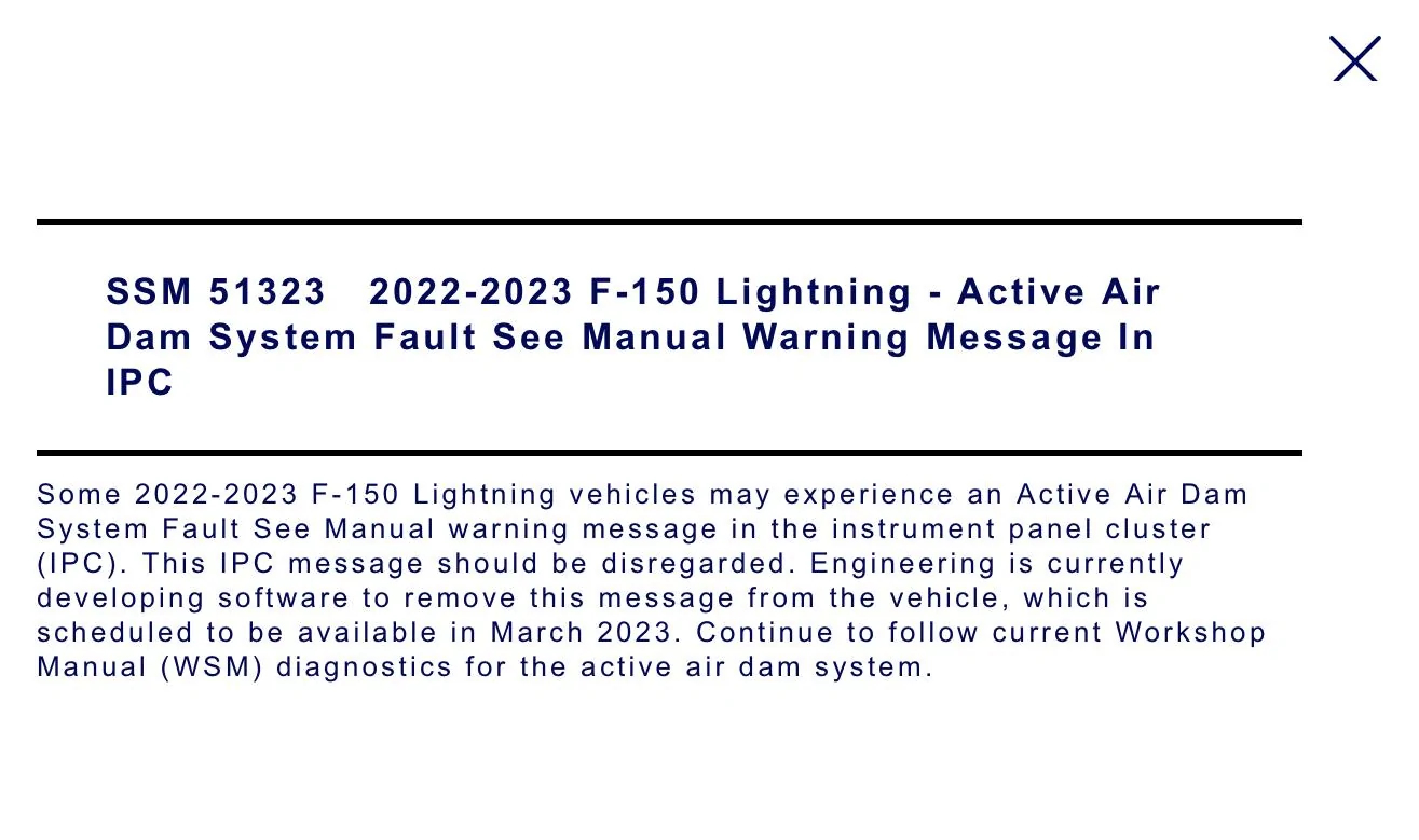

I wouldn't worry about it, there's little you can do about it since the action only happens after 45mph, so there's nothing you can 'check' when it is sitting still... it either works, or it doesn't, but I don't think it's a big aero-saver, either, over short term miles...
I believe the error is due to the two motors not being in 'sync' when they try to move the aero-dam down, at 45mph. I don't think it means it NEVER works, it just couldn't do it's job THAT time.

I had a bad actuator that the dealer replaced. No errors since being replaced two months ago.

MANY dealers replaced the actuators instead of following the TSB and just updating software. Not saying that is true for your case, just a general statement that the part replacement paid out more than software

I got this error just a few miles away from the dealership the day that I bought mine. I ignored it because I have been reading what has been posted here. Someone suggested silicone lubricant. I did that on each side and haven't had the error ever since.

That also works. The fault tolerance was set a millisecond to fast so by helping it slide easier it fixed the issue. And then with the updated software it will get fully fixed by the time you need more silicone
