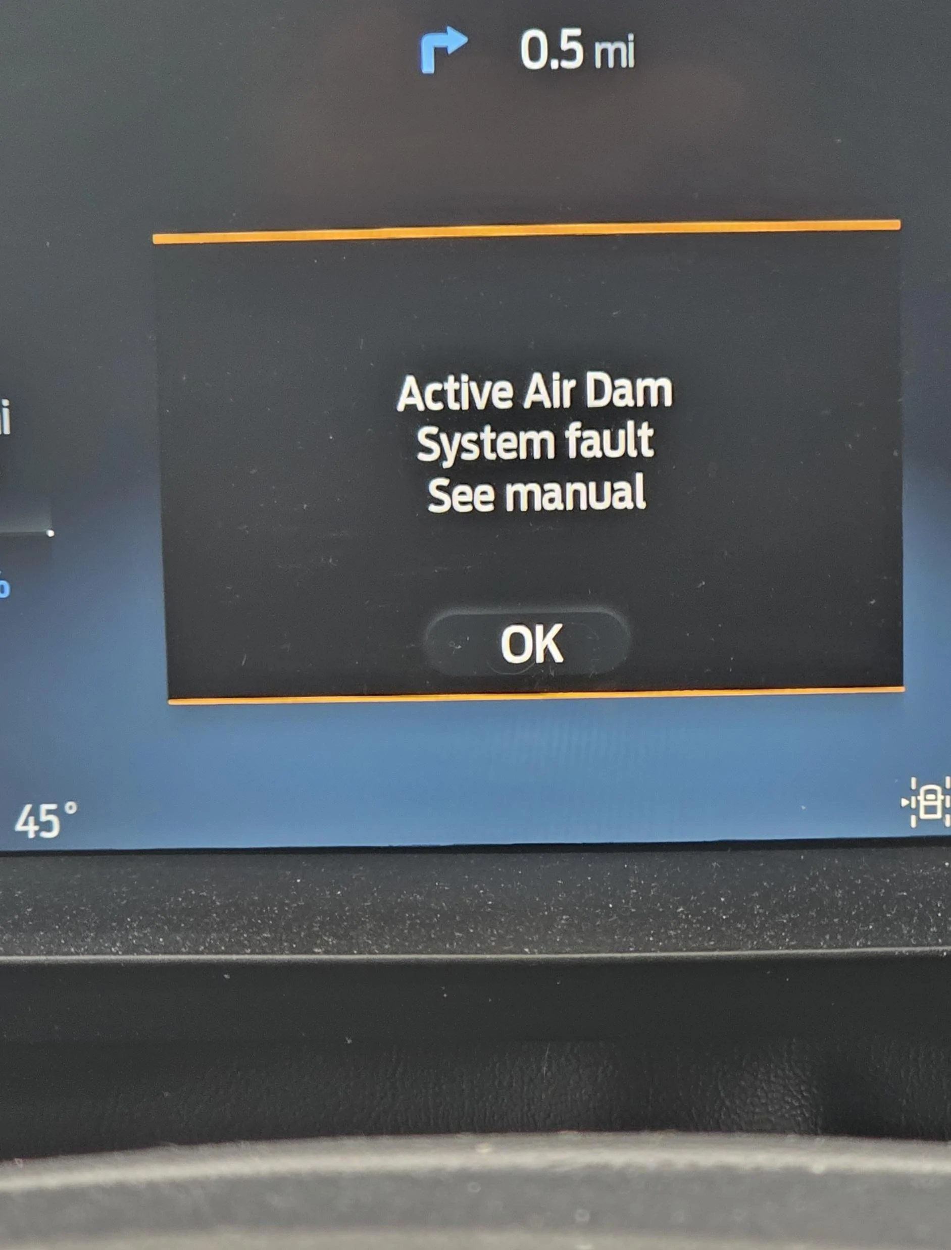

Oh goody!
I finally get to join this club! 4,300mi

I need the jacket, I started this thread. And it is still showing most everyday and sometimes several times a day.
Did you ever try to lubricate the air dam tracks (WD-40...etc)?
