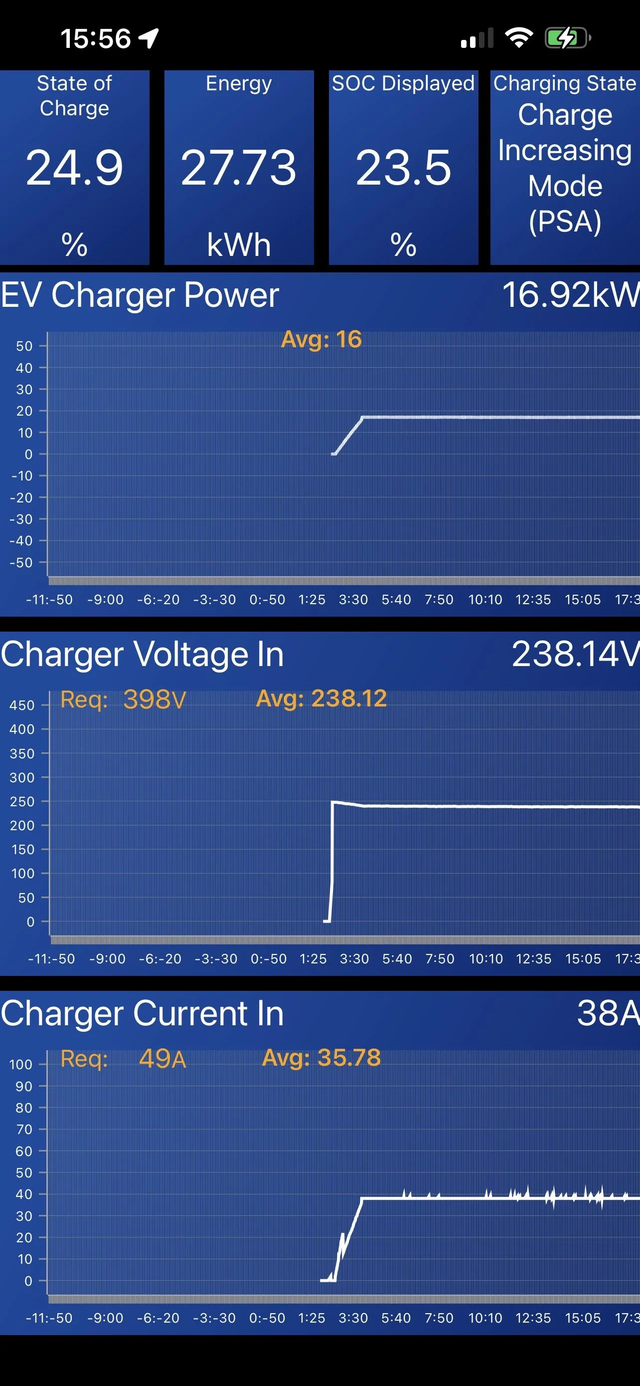

Isn’t the ODB data the net DC going into the battery? There will be conversion losses between the AC going into the truck and the DC going into the battery. There is also energy used for battery temperature maintenance. Maybe as much as 10% loss.
FWIW, average of 16kW being delivered @ 238.12V/67.19A (calculated) over the first 00:17:30 (24.9% SoC achieved) beginning at ~20% SoC. There may be a rounding error due to only two significant figures of the Ave kW Delivered displayed.
Attached is a copy of my CarScanner Dashboard of a recent FCSP charge session that started at ~20% SoC.
Note: At this point (picture) of the session (24.9% SoC), my Lightning is requesting 398V, but only receiving 16.92 kW@238.14V/71.05A calculated [(16.92/238.14)*1000].​
FCSP set to 80A connected to a 240V/100A circuit
I have only been able to ID one the PIDs for my ER Lariat’s two onboard chargers…the bottom gragh/digital readings show the one charger PID identified was requesting 49A, but only receiving 38A.
My simple math says my truck in total was receiving a total of 71.05A [(16.92/238.14)*1000] at the time I took this screenshot……
