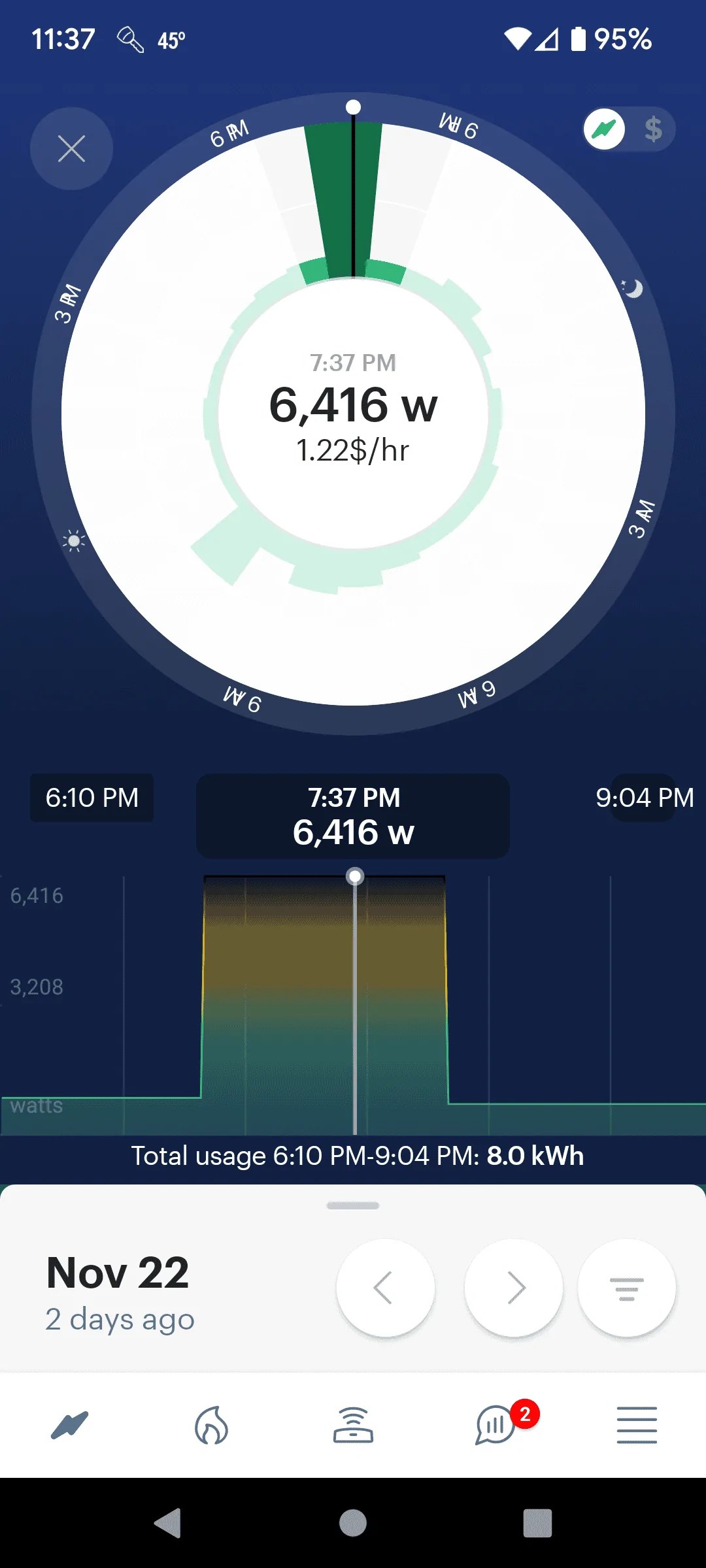

Basically I either need to let it go or buy a charger that shows real time electricity transfer. Which I really don’t need considering I have solar and battery back up and could never use a full charge in a day, lol.

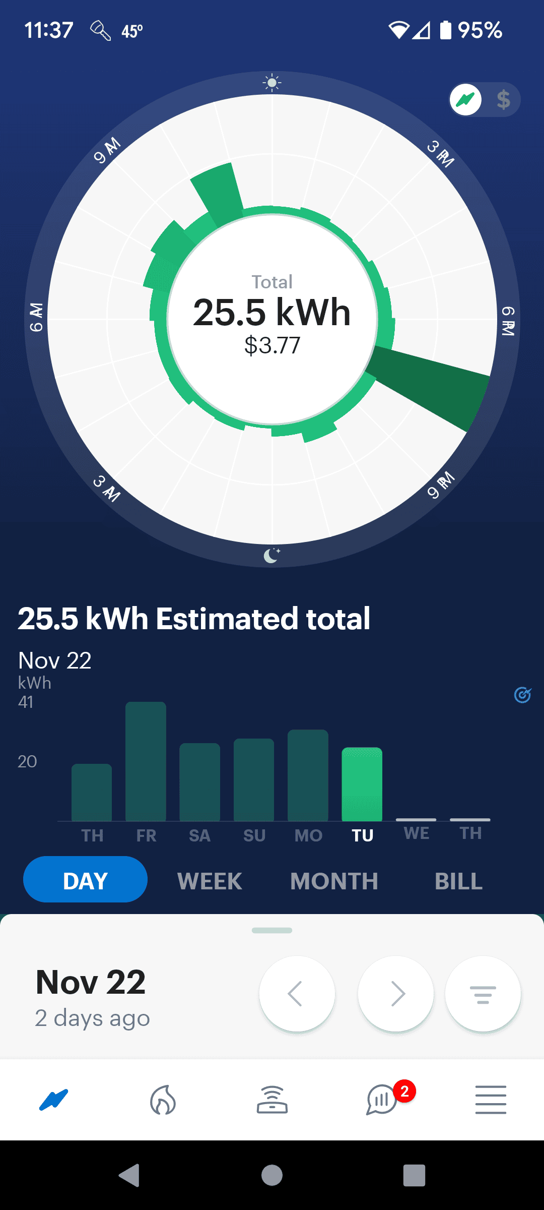

I'm surprised that with solar and battery backup you can't better isolate usage on your end and see.
My utility company has an app that shows me usage, down to exact points in time. It's 24 hours delayed, but if I pay $1.99 a month I can get it immediate. So I took the 6 month free trial for the immediate, and got readings on every major appliance to see what they were.
First picture is my usage 2 days ago. You can clearly see that the charger kicked on at 7PM. Second picture shows that at 7:37PM I was using 6,416 watts. I can see that after I was using 764 watts. 6,416 - 764 = 5,652. But it wasn't on for the full hour, and the app is only showing one hour increments. If I go back to when it charged for multiple hours (late October), I see 8,392, 8,414, 8,421, then 532 the next hour. so 8,400 - 530 = 7,870.
My charger is set at 32 amps, and I have 248 volts. 7,936 watts. Pretty close.

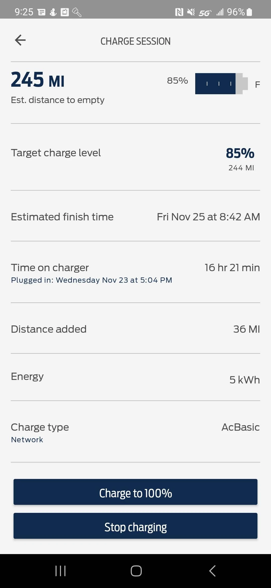

My 120v wall outlet gives me about 2 miles an hr off the ford mobile charger. With a 20 mile commute, it's good enough for me to use the 6kw Chargers at work.
(I'm pretty sure 5kwh though is not 36 miles lol)

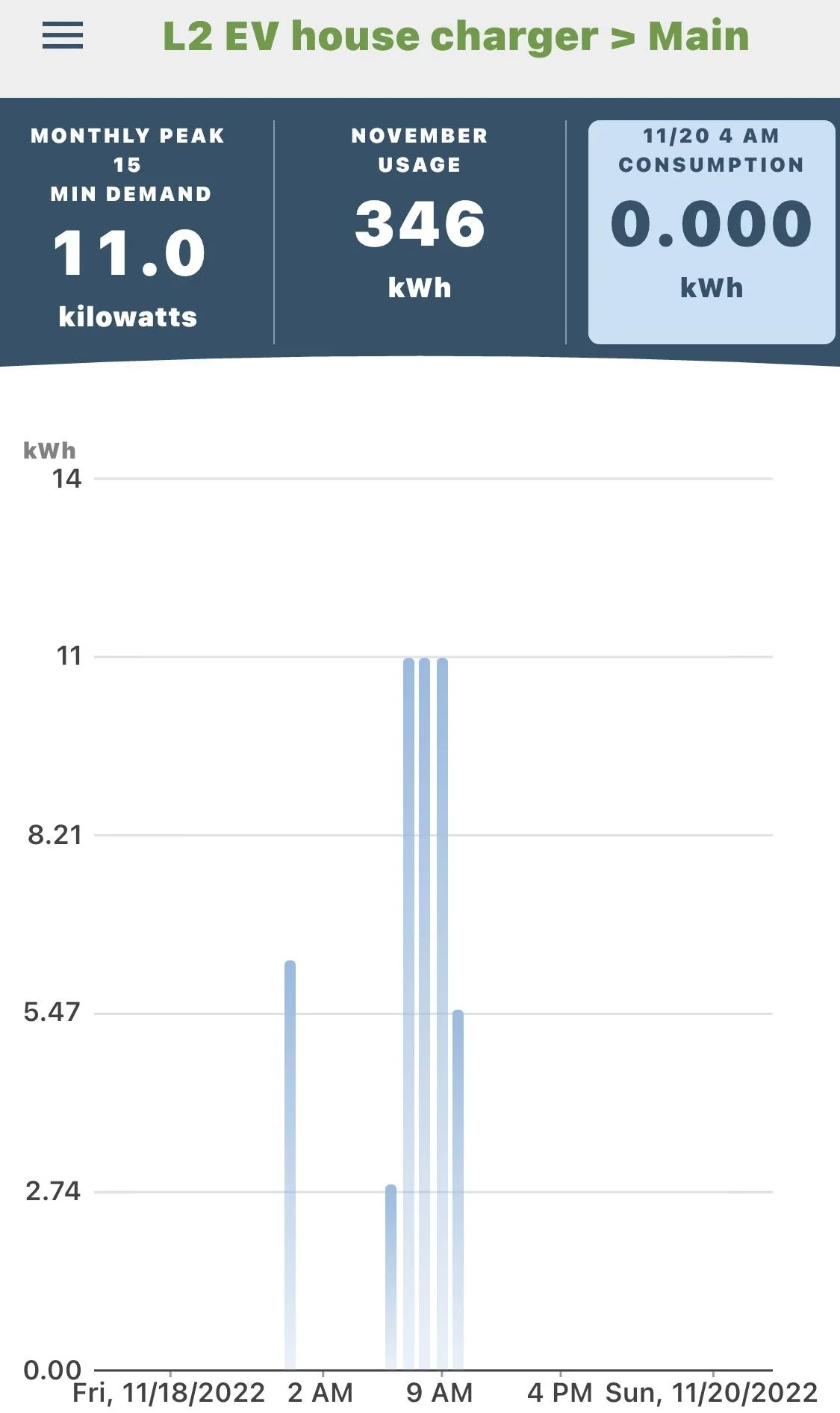

I have the emporia charger and see 46a. It’s hardwired on a 60a circuit.
Same charger - hardwired to a 60A circuit and it's at 11.0kW (46A) sustained charging.
Always charge to 100% once a week.
4 hours total charge time on a weekend:

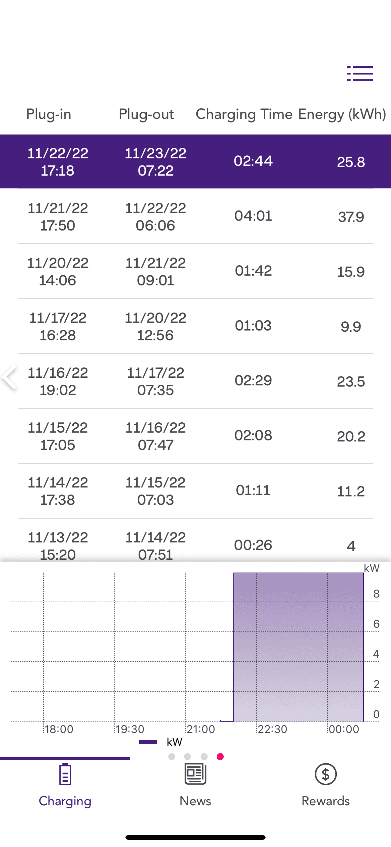

Here’s a screenshot of my Enel X 40A JuiceBox last several charges:
Ford F-150 Lightning Actual Charging Speeds at Home (What are you getting?) 9C453523-85F0-4BE3-9200-571912D4395E
for reference.

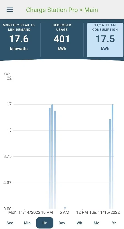

Mine is on a 100A breaker. Measures 238V on the FCSP terminals with a 25 foot run and #2 THHN. Set to 80A. Measures 17.5kWh feeding the FCSP, meaning it's drawing around 74A.
If you have a low kWh reading, first thing I would check is your voltage.

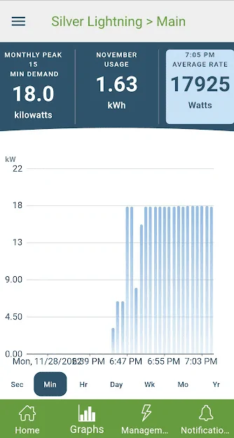

I just installed a Emporia Gen-2 Vue, I was seeing ~17925 at 240v that would be ~ 74.7 amps

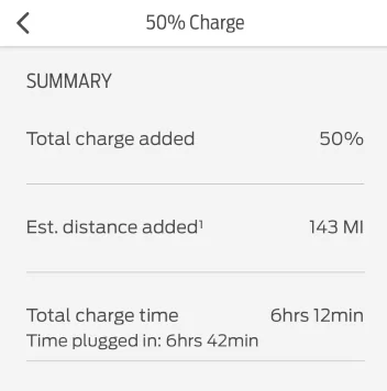

Here is how I would calculate my charge rate using the Ford Pass data - reference this screen shot from today:
Ford F-150 Lightning Actual Charging Speeds at Home (What are you getting?) 20221129_030559000_iOS (Medium)
Total charge added is 50%. I have an ER battery which is 131 kWh so total kWh added is:
131 kWh x 50% = 65.5 kWh.
Total charge time was 6hrs 12min (don't use the time plugged in number). This is 6.2 hours.
So the average charge rate is kWh/hours which is 65.5/6.2 = 10.6 kW.
Note I have the FSCP set at 48 Amps. Assuming 240 volts that is 240V x 48A /1000 = 11.5 kW theoretical rate. The FSCP reported 71.0 kWh sent to the vehicle for this session which is an average rate of 11.45 kW. Close enough. Note the difference in the 71 kWh sent and the 65.5 kWh battery increase are charger losses.
