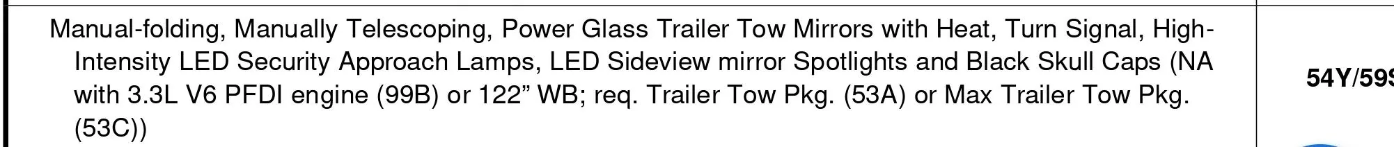

Order Guide states you have to have the Trailer Tow Package or Max Trailer Tow Package to get the towing mirrors.
Ford F-150 Lightning Adding Tow Mirrors to 2022 F-150 XLT w/Tow Tech Package Screenshot_20220315-100216_Adobe Acrobat

Thanks for the info,
I decided to take a closer look at the Order Guide and discovered it contradicts itself (or at least supports ambiguous combinations of options and pkg's).
I spoke to a parts guy at a different dealership that says adding tow mirrors to the Tow Tech Pkg will work fine.
For $650, I think I'll take a chance.

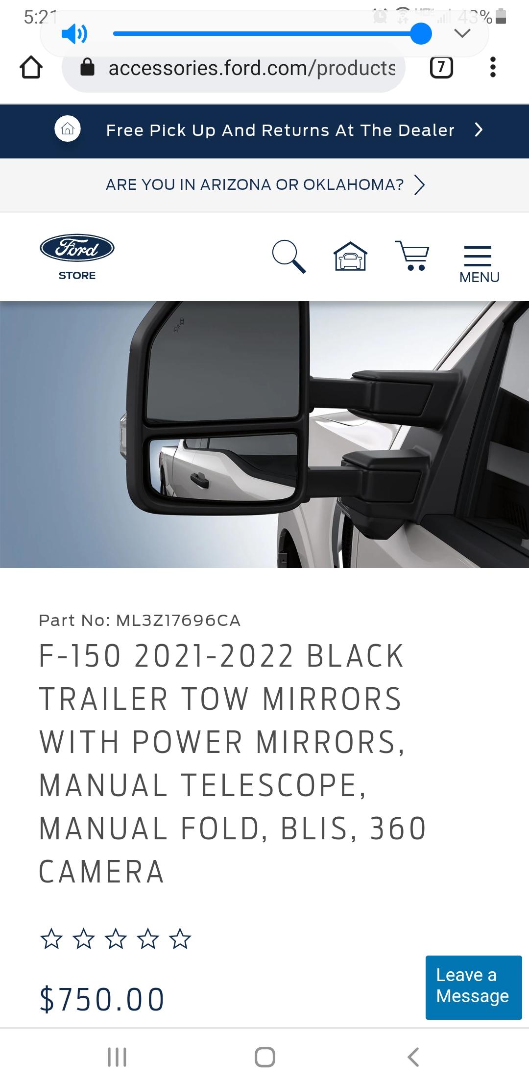

Factory Tow Mirrors are now available through Ford as an accessory. All styles from basic to power folding with power telescoping.
Ford F-150 Lightning Adding Tow Mirrors to 2022 F-150 XLT w/Tow Tech Package Screenshot_20220321-172133_Chrome
