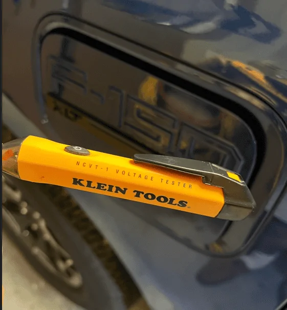

This weekend, I realized I was missing an essential tool for EV travel.
Ford F-150 Lightning An essential travel tool I just added to my Lightning - voltage tester 1664834905333
A simple voltage tester is something I'm going to keep in my console at all times. I'm thinking about adding a receptacle tester too.
You visit someone and they are willing to let you plug in for a charge but then things don't seem to work right. Many folks seem to have electrical outlets that don't function as expected.
Examples I have run into.
Is that old 240 volt outlet still connected?
It looks like a 240 volt outlet are both legs connected?
What breaker powers what outlets?
Is the polarity reversed on an outlet?
I ran into a 120V outlet the other day that had an open ground. The receptacle tester would confirm an open ground.

Those tick tracers are dangerous. I wouldn't trust them. Get something with physical leads.
SmokingtheMeats
Oct 14, 2021
478
295
PA
2010 F-150
Tech
What makes them dangerous? I’ve seen numerous electricians and contractors use them. I have one myself, and I’ve never heard anyone say they are dangerous.
37
3,799
6,920
I find them to be unreliable, and easily fooled. I won't use them. I got hit with 277 once because it didn't recognize it, but was set off when I put it up to 480.
Use at your own risk, and always remember to check your checker. Test something 100% known to work, do your check, then go back to the 100% known circuit.
4,075
5,344
I agree. If it indicates power present, there is, but if it doesn’t light up, you can’t be sure the circuit’s dead. They have their uses (tracing switch loops, for example) but shouldn’t be relied upon to tell you a circuit is safe to touch.

If you use the Klein Tools one pictured you should be alright. Don't compare any of the knock-offs though as they are unreliable and this is a device you want to be reliable. I still have several of these kicking around from my past life as a sparky and I've found two things 1) spend more and get the Klein Tools version and 2) in all of the years of owning Teslas exclusively and traveling all over the country to include remote areas I haven't yet had the need for one of these. That's not to say it's not a bad idea to keep one as it will pay for itself if you need it even once but more to demonstrate how frequently you'll actually have use for it.
You can do an awful lot of things "just in case" with an EV and before you know it... you'll have like a hundred things you do and after years you'll discover that EVs are far less worry than people realize. I was the same way when I first started and I think focusing on all the unlikely occurrences can be a deterrent to EV entry. I've been making more of an effort lately to try to demystify and declutter EV ownership because it really is dead simple if you let it be. FAR less complex than ICE ownership and it's not even close.
Summary: Not a bed idea to throw one in the glovebox if you want just in case but don't lose any sleep over not having one. You'll be fine.
