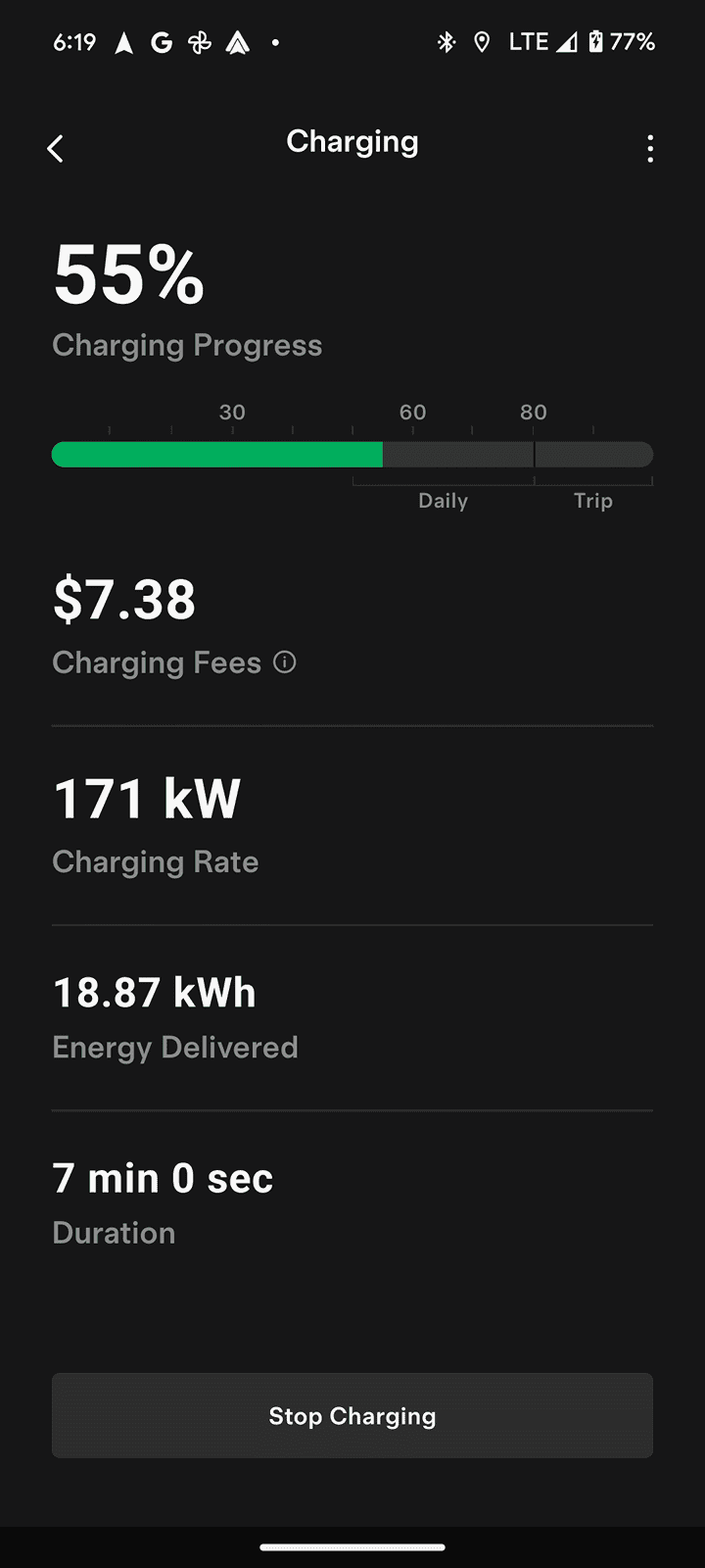

I just got the A2Z adapter so I could use Tesla V3+ chargers on a long trip I am taking. In preparation, I took the CCS adapter to a V3 Supercharger to test and work out any bugs prior to the trip. Things I discovered:
1. Even if you have a Tesla account (as I do for my Model 3) you still need to register in the Tesla app in the Charge My Your EV section of the app. You don't need to reenter your payment info, just your address. This added a few minutes before I could start the charging session.
2. The Tesla app is your friend when it comes to finding compatible Superchargers. Use the search feature. It will only show you compatible Superchargers on the map, unlike Plug share, etc.
3. This super important...You have to lock the adapter once you attach it to the NACS cable...and it's not exactly easy or intuitive. Like others have said, use the ground as a surface to allow you to put more "plugging" force to make sure it is seated completely. Secondly, the charger will throw a "charging fault" if the locking switch on the adapter is not in the correct position. The problem is that it is in the locked position when you can see "unlocked" on the adapter switch. I guess A2Z thought that pushing the switch towards the "locked" wording was obvious, but when you do that, the word you see is "unlocked" and the switch covers the "locked" wording. To me, by doing that, the switch covers the "locked" word and exposing the "unlocked" wording, which to me means unlocked. So to reiterate, when the adpter is really locked, what you see is "unlocked." I had charging faults twice before I realized the seeing "unlocked" means locked.
Once I got everything figured out, the charging went perfectly, even hitting 171kw for more than 7 minutes. As someone who has been using Superchargers for years, I am really happy to get access to the absolutely best charging network out there. Now, it would be nice if I didn't have to take 2 spots to charge. I'm sure that I'm going to catch flak for blocking a charger at a busy Supercharger one of these days. I know as a Tesla driver, I would be pissed if I had to wait for some Lightning idiot blocking the only available Supercharger. ?

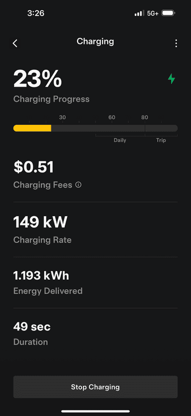

Got my A2Z DC adapter two days ago (Ordered on May 1).
Tested it out at Tesla charger. Initiated charging in the Tesla app. All worked as expected. Hit about 167 kW max.
Used the right most spot so as not to block a spot.
