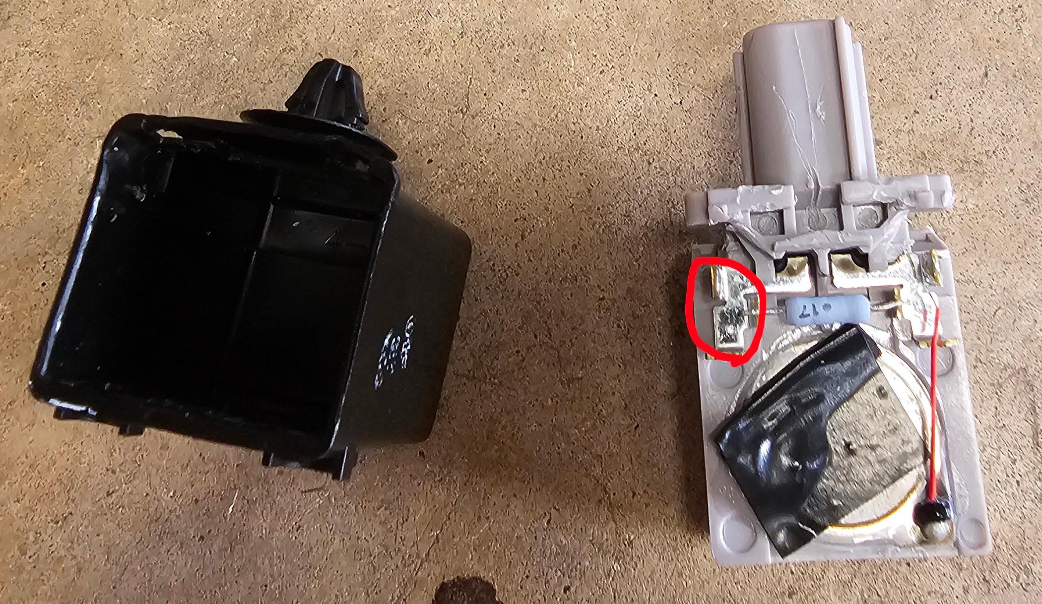

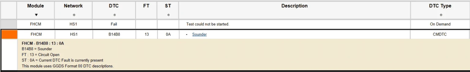

I did some FDRS updates today including one for the frunk (FHCM) and afterwards I started getting an error in FDRS about an open circuit. It showed that "sounder" could not be tested. Based on the "sounder" name and this being a frunk update, I figured that Ford finally put something in that checks for it. I took my sounder apart and removed the ground wire connecting to the internal speaker. I taped of the ground and put it back together and installed it. Ran the test again in FDRS and it passed. It doesn't beep either, so looks like this will work for now.
The pic below is of mine opened up. I pulled the black ground wire off that was connected to the area with the red circle around it. Opening it up was a lot of trial and error as you can see from the scratches and bent plastic edges.
Ford F-150 Lightning Anyone figured out how to turn off the frunk beeping yet? lightning_sounder.jpb
FDRS error before putting modified sounder back in.
Ford F-150 Lightning Anyone figured out how to turn off the frunk beeping yet? fdrs_sounder_error

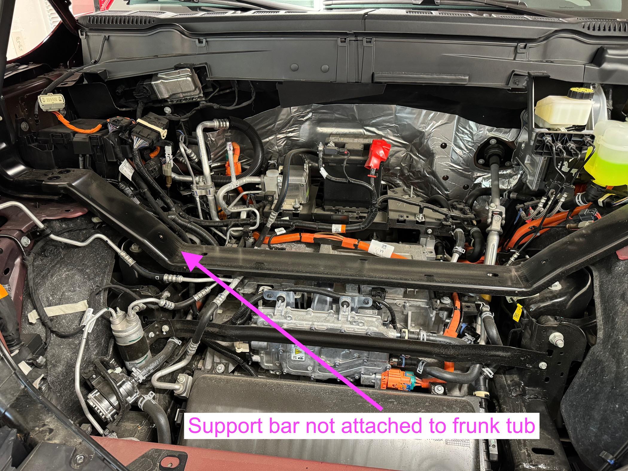

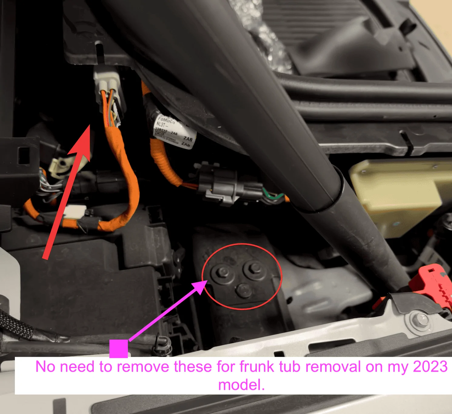

Removed my frunk tub today and found it is a bit different than what others have posted.
The support bar was not bonded to the frunk as stated. I did not need to remove the two bolts on each side of the outside of tub (even though I did). This likely makes it easier to remove /install since you don't have the weight of the support bar when lifting the frunk tub and 4 less bolts to mess with.
Not sure if this is true for all 2023 models or not.
As you can see in photo the support bar is still in place after the tub removed. Other videos/photos, posted show the support bar coming out with the tub.
Something to note if you ever have to remove your frunk tub.

mrau
Feb 2, 2024
385
522
23 Lariat⚡ER
Not sure.
There was no sign of adhesive or physical connection to the support bar after I removed tub. There are just two T45 screws inside the tub that connect to the support bar, but those are already noted to be taken out to remove tub.
My truck is a Oct 2023 build.

23 Lariat⚡ER
Yep, you are right.
No MIL light on the dash, but I did check for codes. Got code: B14B8 -Sounder
May do some surgery on the beeper and reinstall in a few days.
