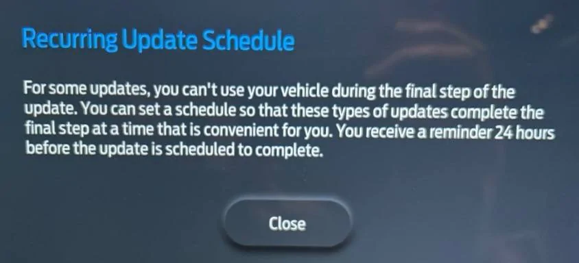

Like @TaxmanHog says, that Recurring Schedule you are referring to is not when it checks for updates. In my experience it checks whenever started. This is a very common misconception.
There are two types of Updates - "instant" and inhibited. It will download both but for inhibit updates, it will wait until that Update time to install (or you can choose now).
Here is the info screen for Recurring Update Schedule you referred to:
Ford F-150 Lightning Anyone know the Ford SW update URL/DNS name from your (WiFi) Network? 1742602498996-8k

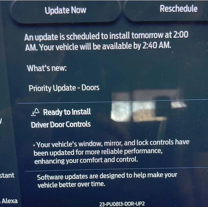

You will see a message like this when an inhibit update has downloaded. Note you can Update Now or Reschedule:
Ford F-150 Lightning Anyone know the Ford SW update URL/DNS name from your (WiFi) Network? 1742602619545-vr
