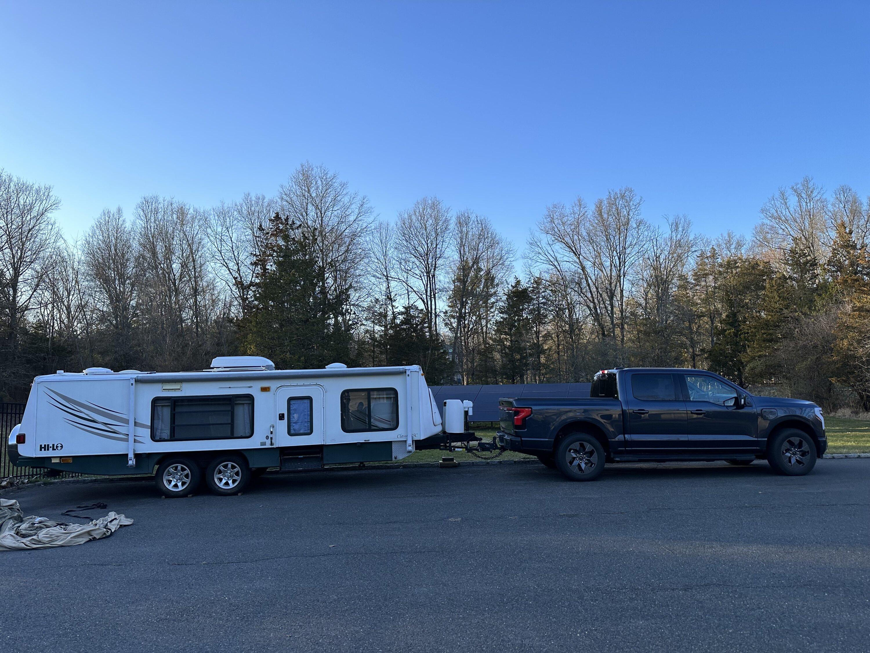

It’s possible with the right trailer. I’ve gotten as high as 1.7mi/kWh with my Hi-Lo in tow and average 1.5mi/kWh towing at 70mph usually. Lowest I get usually is 1.3mi/kWh and that’s if it’s really cold and windy, or if I’m trying to keep up with traffic and doing 75.

Nope, I’d probably be even better with that. I’ve got a 25 Classic, extra wide and half a foot taller.
I bought it as a trial and will likely sell it and go up to a 31 Classic this year given how good it’s been.

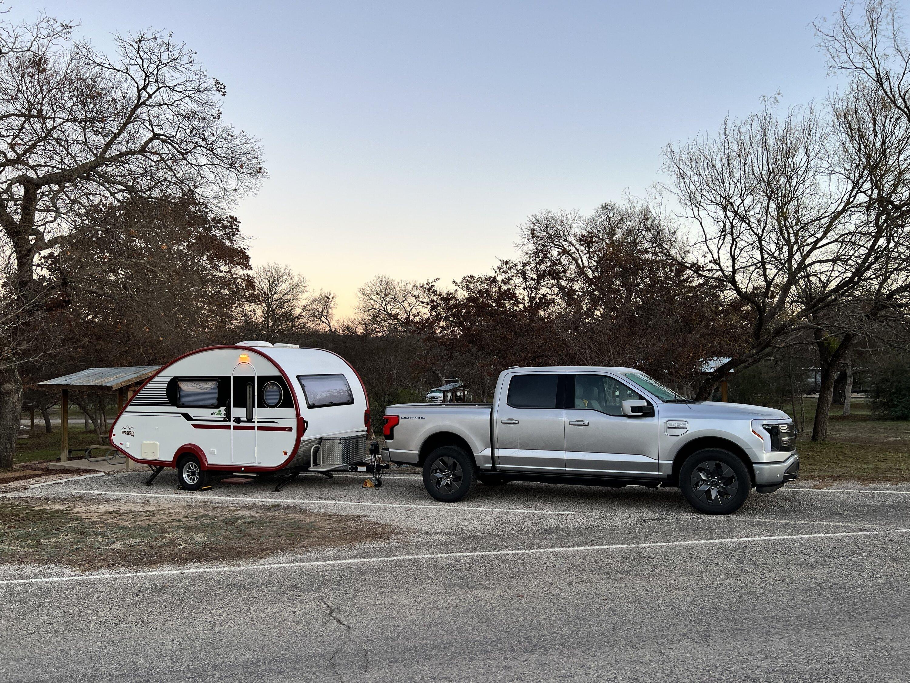

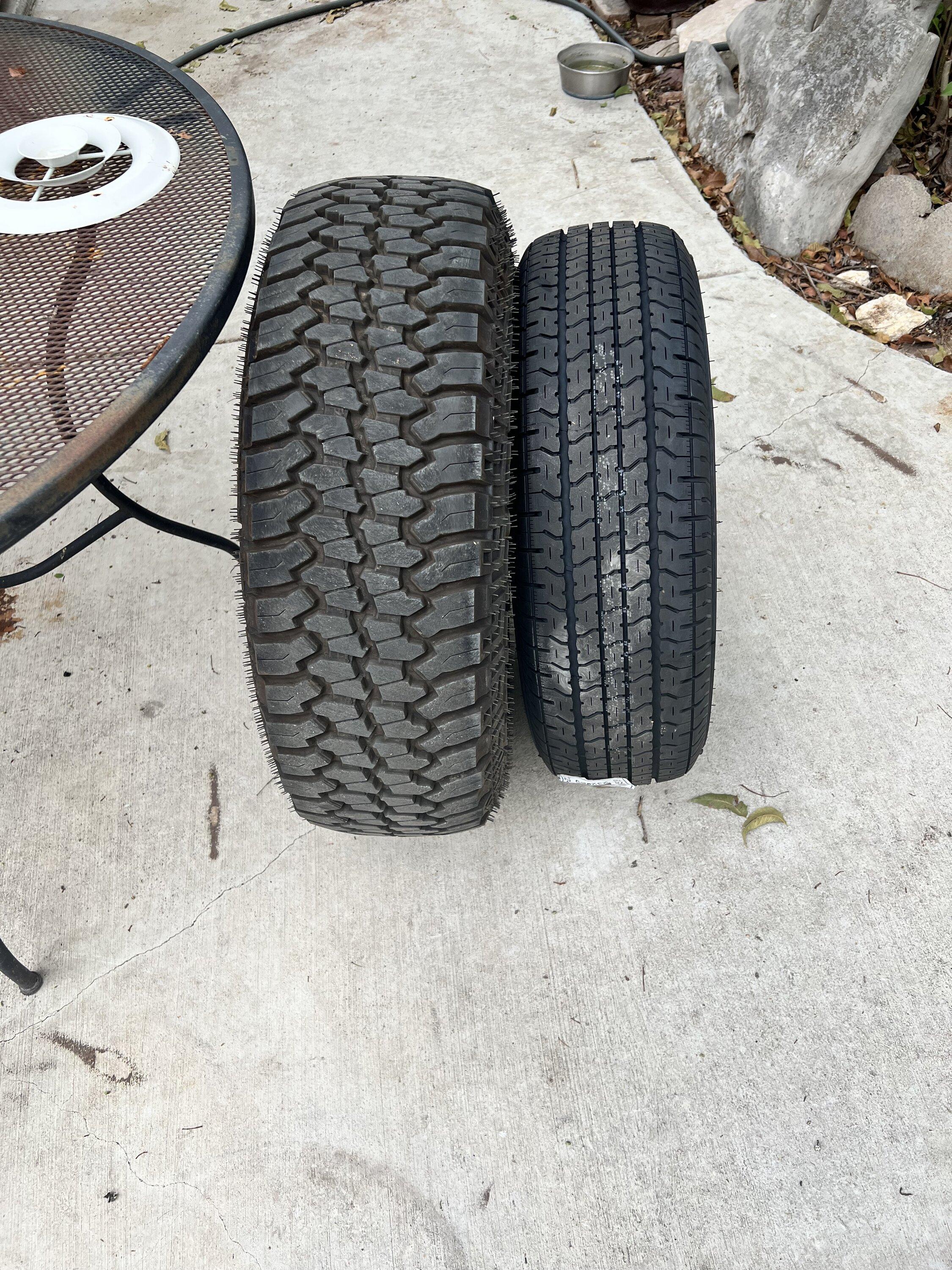

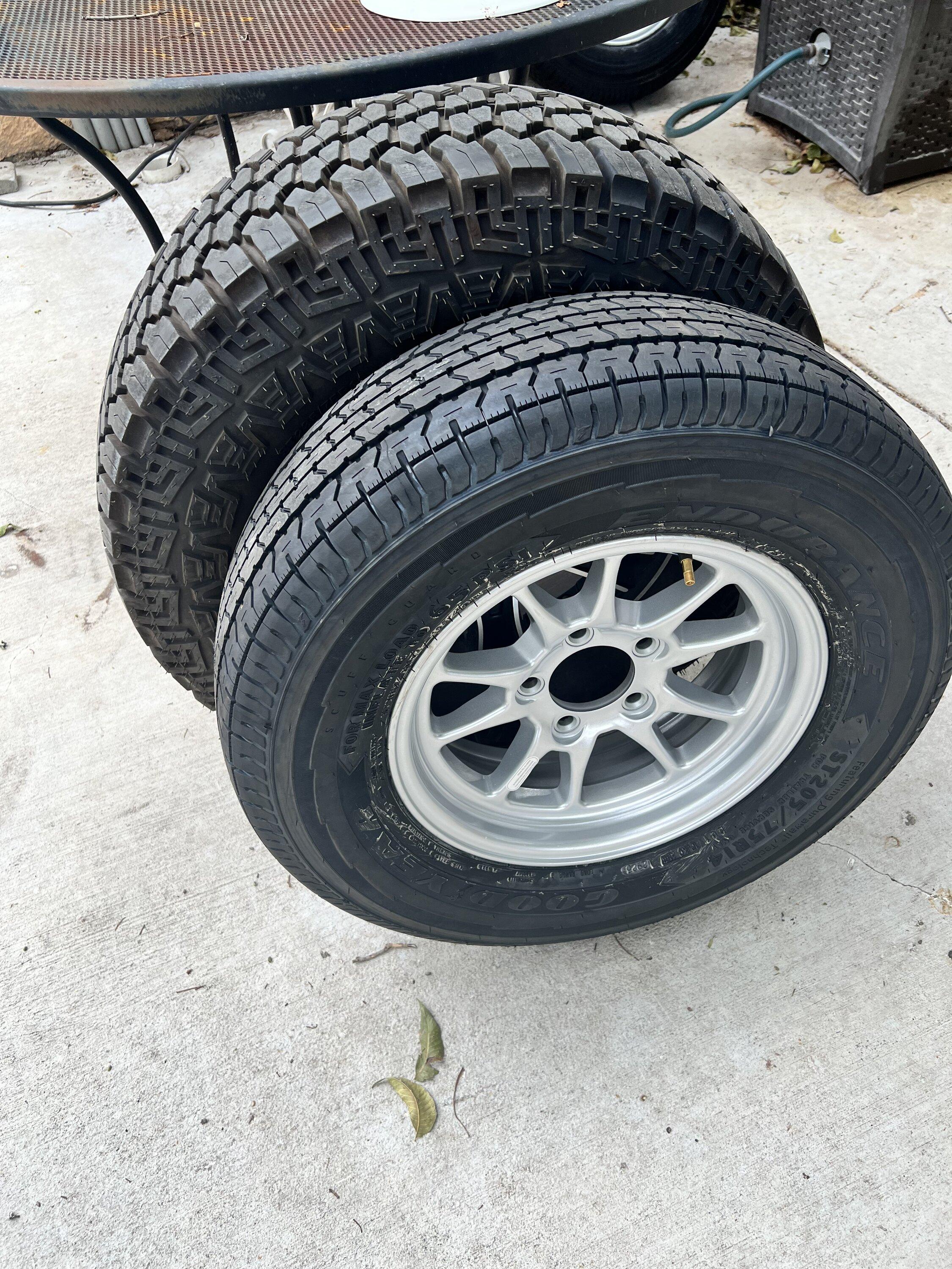

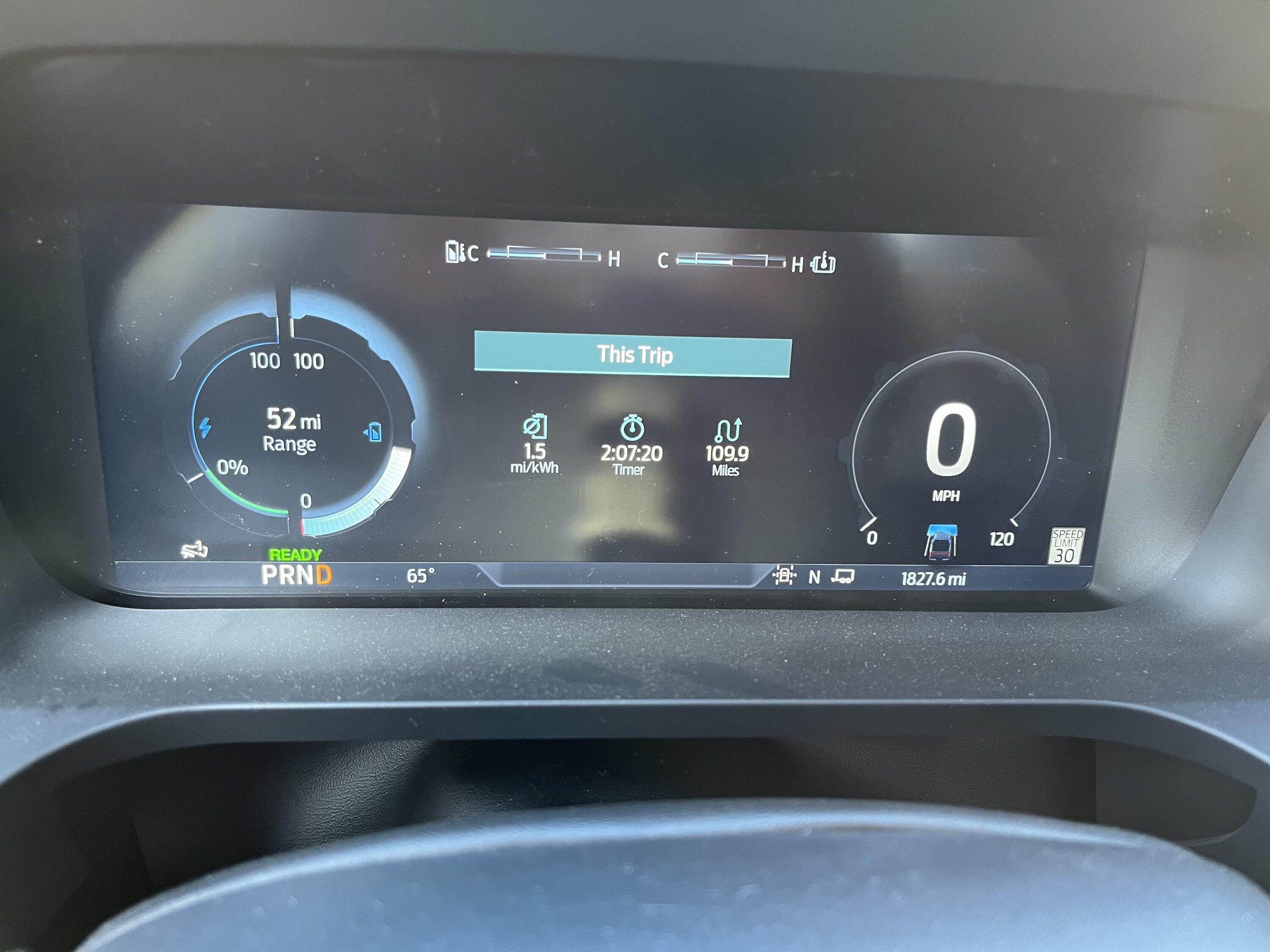

1.5mi/kwh is the best we’ve got, averaging about 50mph (60mph going through city traffic). This was also with an elevation drop and I changed the wheels and tires out to smaller all season trailer tires from the off road ones.
Ford F-150 Lightning Anyone towing a Nucamp Tab 400 Boondock trailer? IMG_2098

Any thoughts on how much the tire swapped helped your range? If 1.5 is the best you have gotten at 50mph, what do you average at regular highway speeds? Thanks.

Normal highway 1.1, 1.2 but it changes a lot over 60mph. It really depends on how much range you need. I have not done A/B testing on just the tires. The smaller tires drop the trailer an inch in height, they weigh 12lbs less each and the tread is less wide. I did it mainly for when towing with our Model 3, before we had the Lightning.
