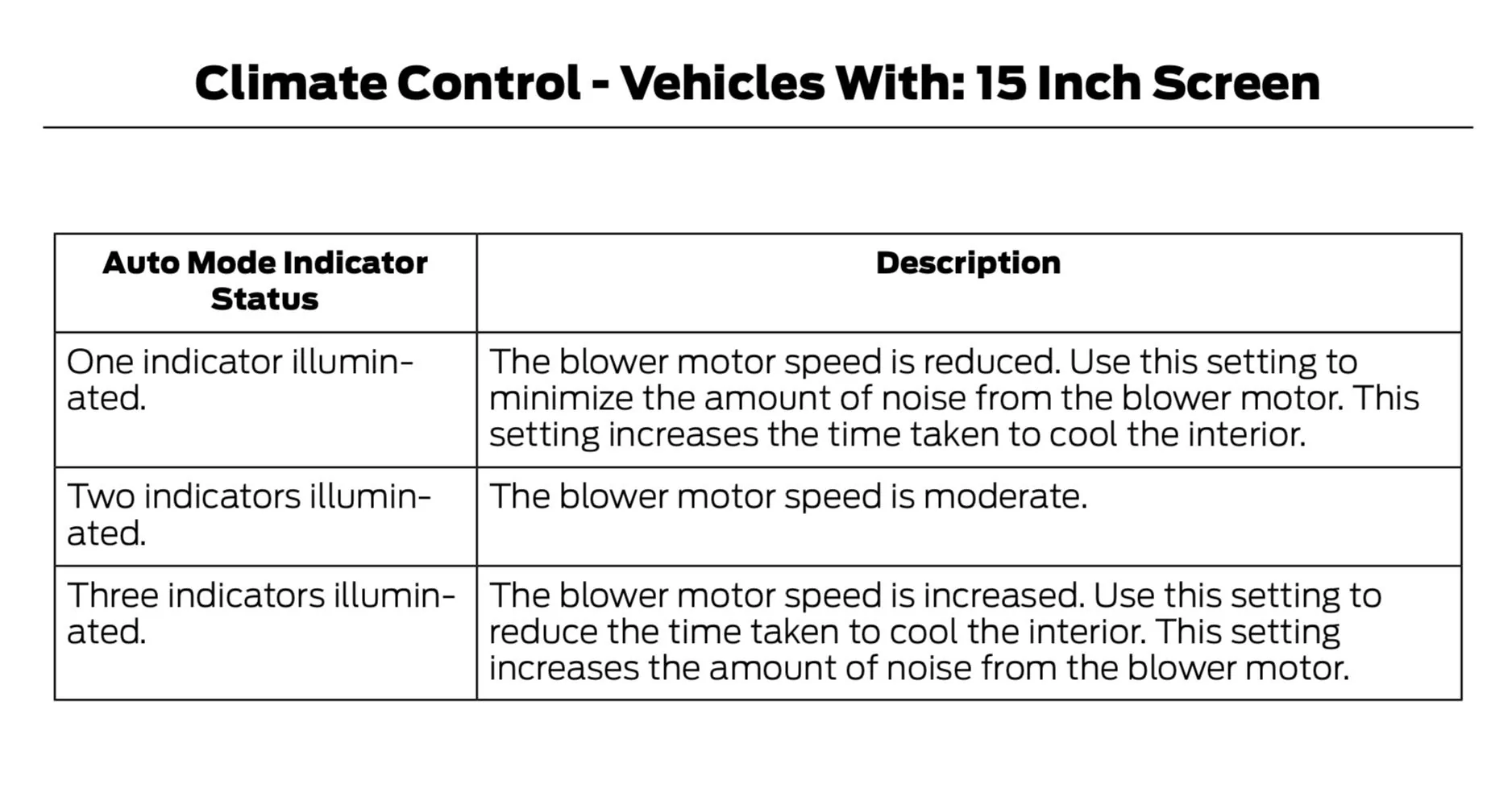

That isn't the way it is designed and mine has not switched. You select one, two or three and it will adjust the cooling/heating with the preset blower you've chosen. If you choose one and it is hot, it is just going to take longer to cool as it isn't blowing as fast.
Page 158 of the manual.
