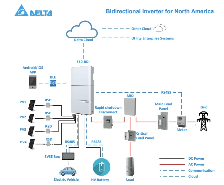

There is a more detailed integration document available. By default Sunrun is installing the 4kW version of Delta's inverter. Delta's documentation calls for a device called MID which acts as a transfer switch and requires critical loads to be moved to a separate panel. During on-grid operation, it permits solar feed-in using UL 1741 safety mechanisms. With grid interruption, it isolates from grid and runs the critical load panel only.
Thanks for this explanation. I'm dealing with this exact thing now with sunrun. They just sent me today this picture but I don't see a MID in the layout. The two panels on right are two 200A panels coming from a 320A meter/400A service on other side of garage wall. Trying to figure out what exactly they have planned. I assume E4 is the HIS that hooks to the DC output of the EVSE (Pro charger), and DSB is the dark start battery, and BULP is backup load panel. So where is the 200Amp MID switch? Didn't Ford advertise this as whole home backup? Does Sunrun always use a Backup Load panel or are they just avoiding connecting a MID between the utility box and one of the 200A panels. I realize that 2 panels presents its own issue but I can move all the AC units which are 120A 240V and 50A oven to one panel and it would make the other handle all else. I'd just shut breakers that are not critical or not turn those items on to keep draw less than 9.6kw, but I'd like the choice of deciding that. Sounds like you have seen HIS installs before? Appreciate your insight. Hard getting tech info from Sunrun so far so time to study the manual that has been posted on the forum. Not using the Sunrun string inverters in this setup.

In person, I have not seen the specific hardware suite used by Sunrun, but good clues come from the AEE Express site from which you can order the HIS gear if Sunrun doesn't cover your state. It includes a BDI series bi-directional inverter, a 12v20AH battery pack, and a WHB-200 automatic grid isolation switch (a/k/a MID, or "microgrid integration device"). It appears that the MID device could easily fit with the backup load panel footprint (16"x21"x8") in your picture.
Ford F-150 Lightning Backup Power 1658367879312
Ford F-150 Lightning Backup Power 1658367168547
Ford F-150 Lightning Backup Power 1658367737352
The system MUST have a MID device somewhere, because you need something that will disconnect the grid so you don't backfeed power when the grid is out.
Also note the "EVSE device" box in the diagram - this is the DC side only of the FCSP (black lines only). The AC side of the FCSP will also be connected appropriately, likely to a 100A breaker in the grid-only main load panel.
The easiest way to describe this is that anything connected to the "grid" side of the MID gets disconnected on grid failure. Anything connected to the backup side of the MID becomes part of a microgrid supplied by the bidirectional inverter. And code requires an outdoor external AC disconnect that will disconnect the inverter from the MID device.
