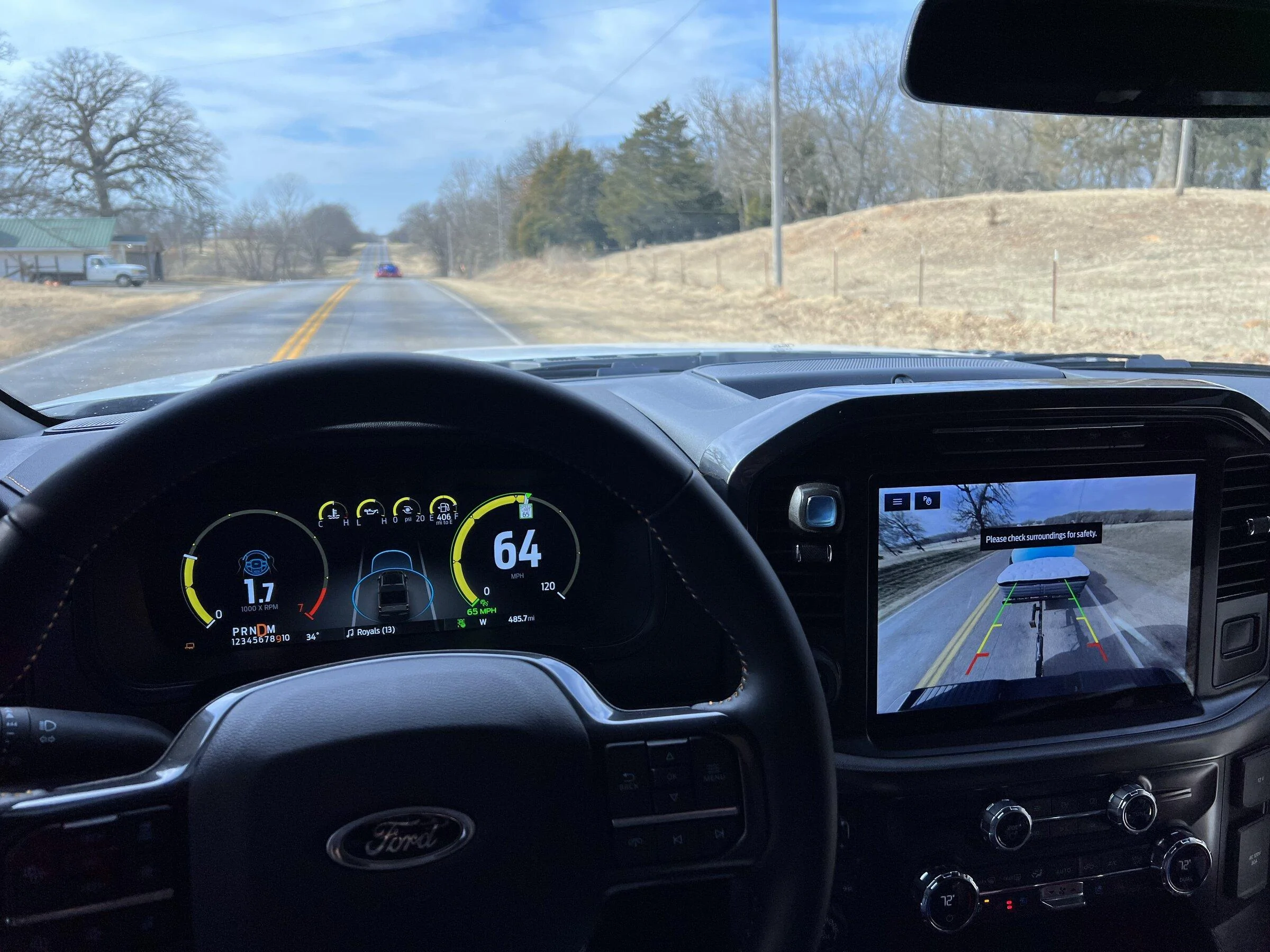

Your bed cam should as well. Mine does.
What I'd like for the bed cam is a little better picture quality.
Yeah, the quality of that camera sucks. Can’t see anything at night and still grainy during the day.
