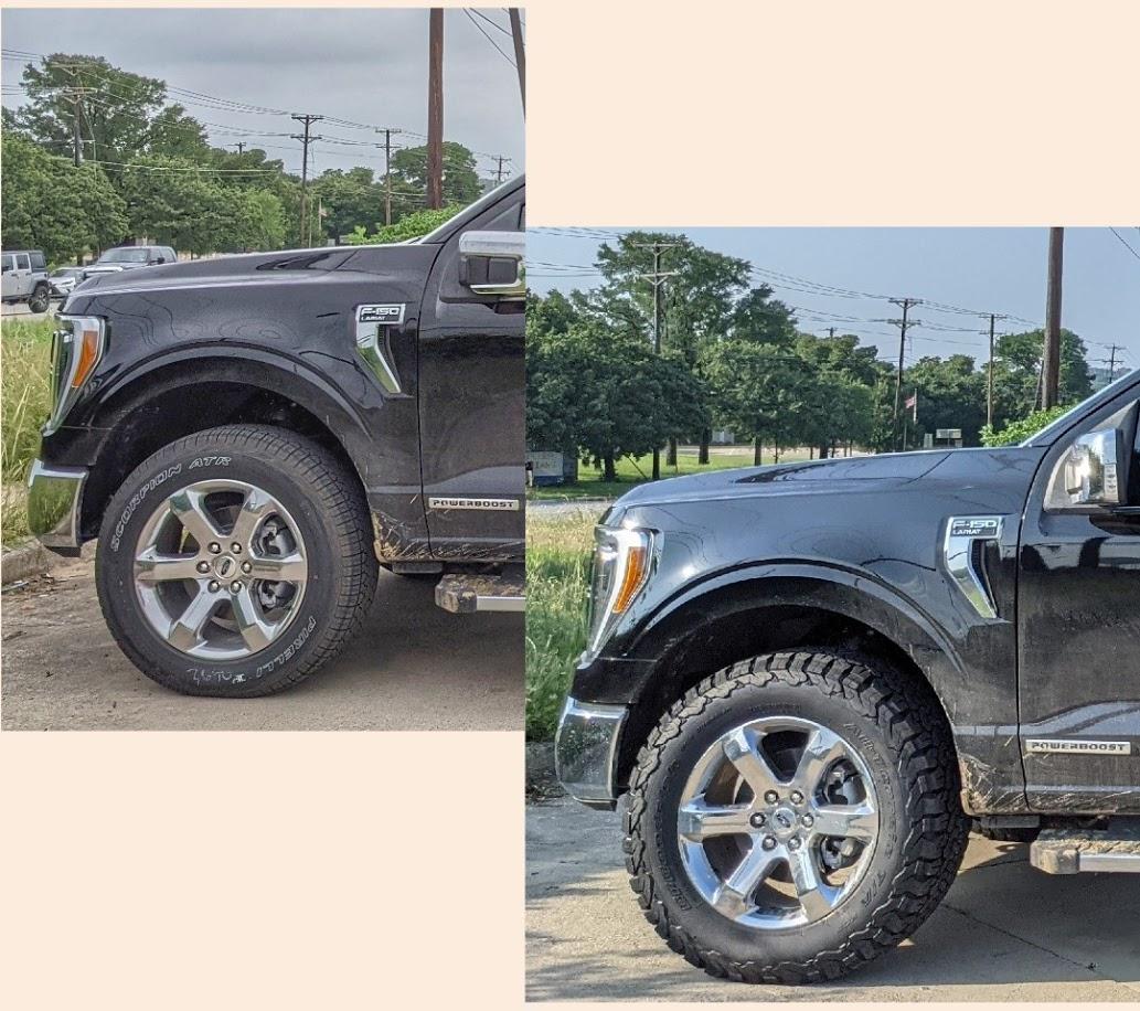

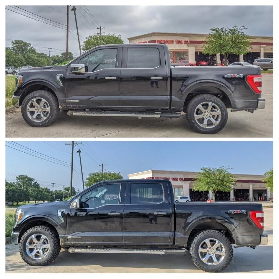

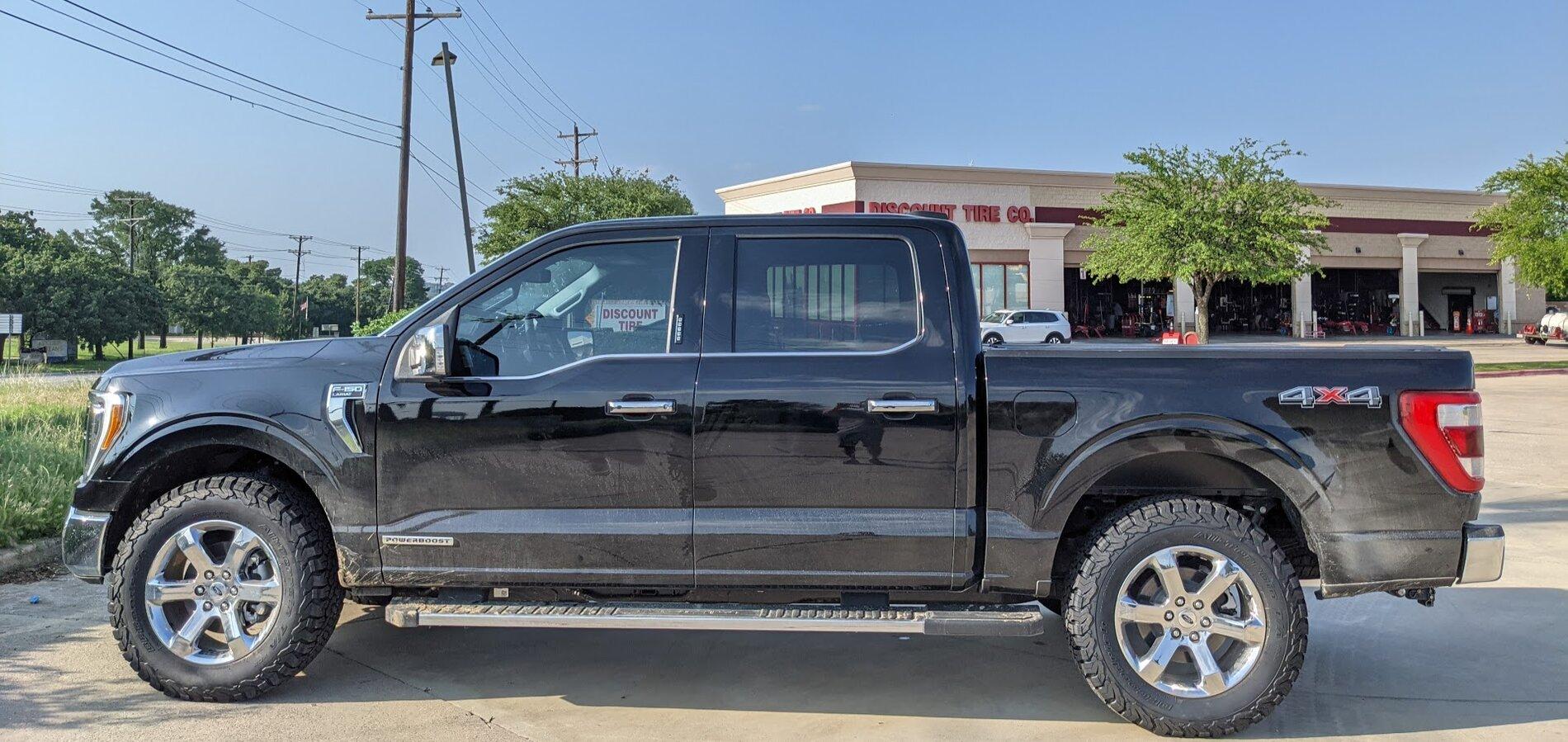

Just put on 285x65x20 KO2s (34.6" tire) on a stock truck. No level. No rubbing whatsoever. I do have 1.5" spacers on order for the rear as the rears are a little tucked for my liking. Otherwise, I am quite happy with how it turned out.
Any rubbing when going over bump forward or turning

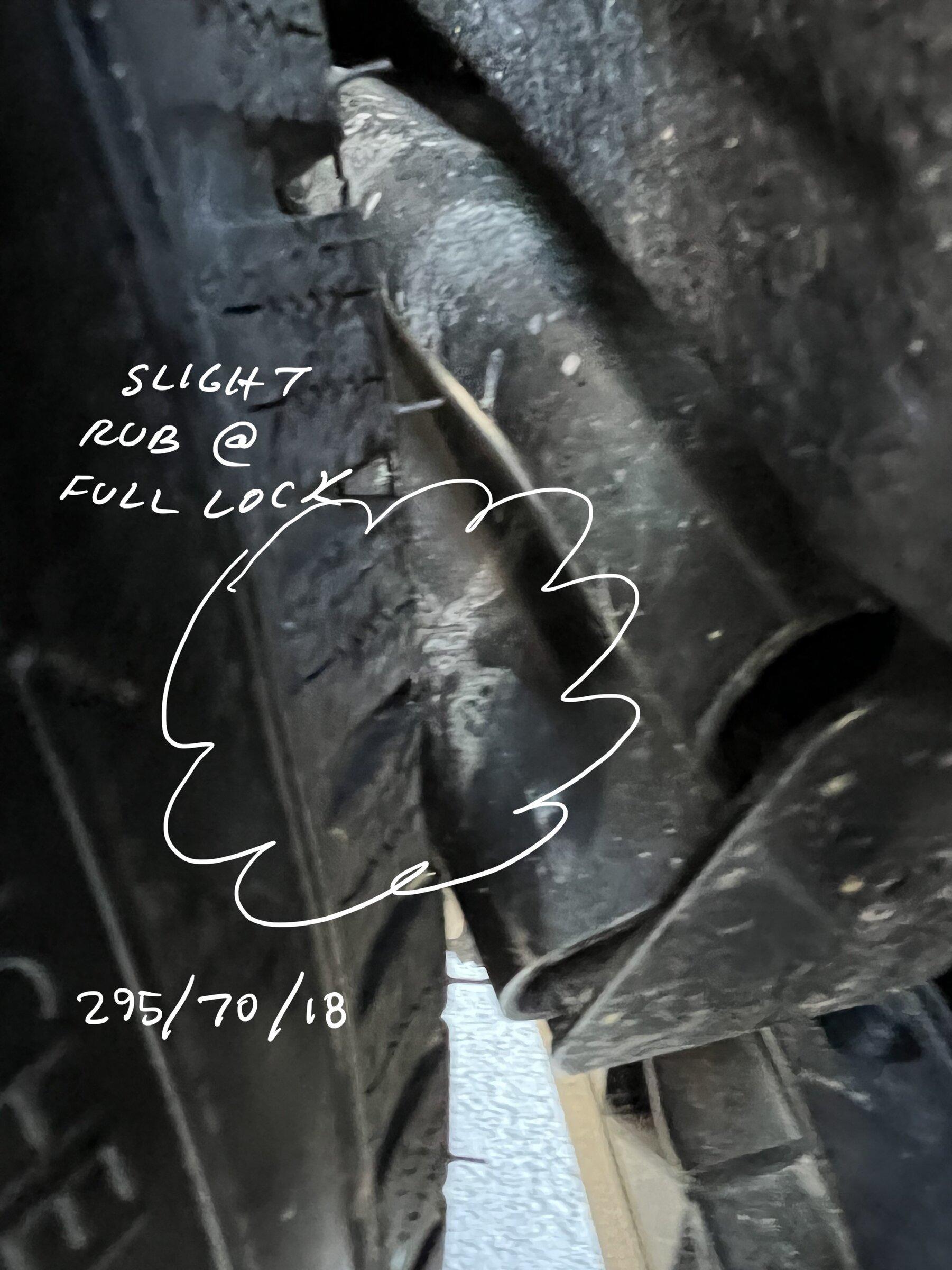

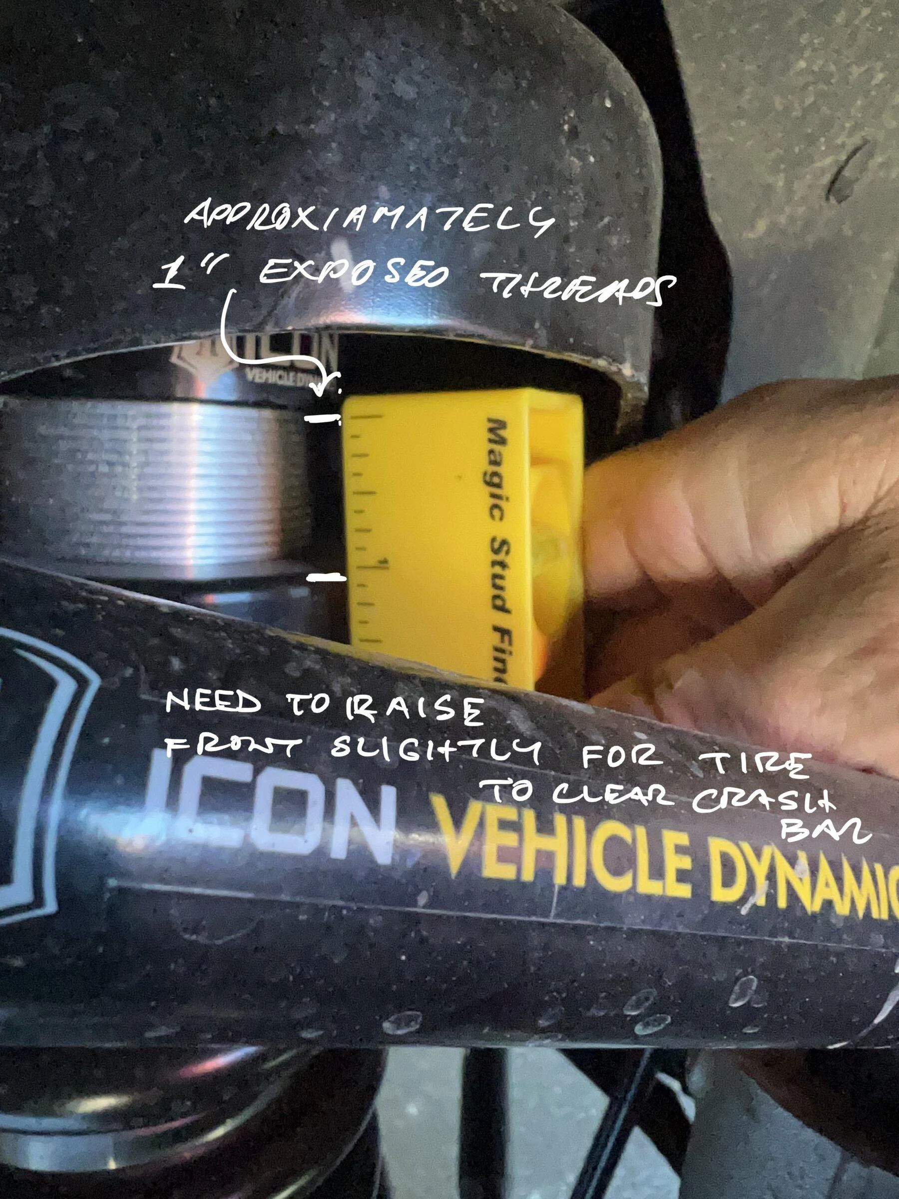

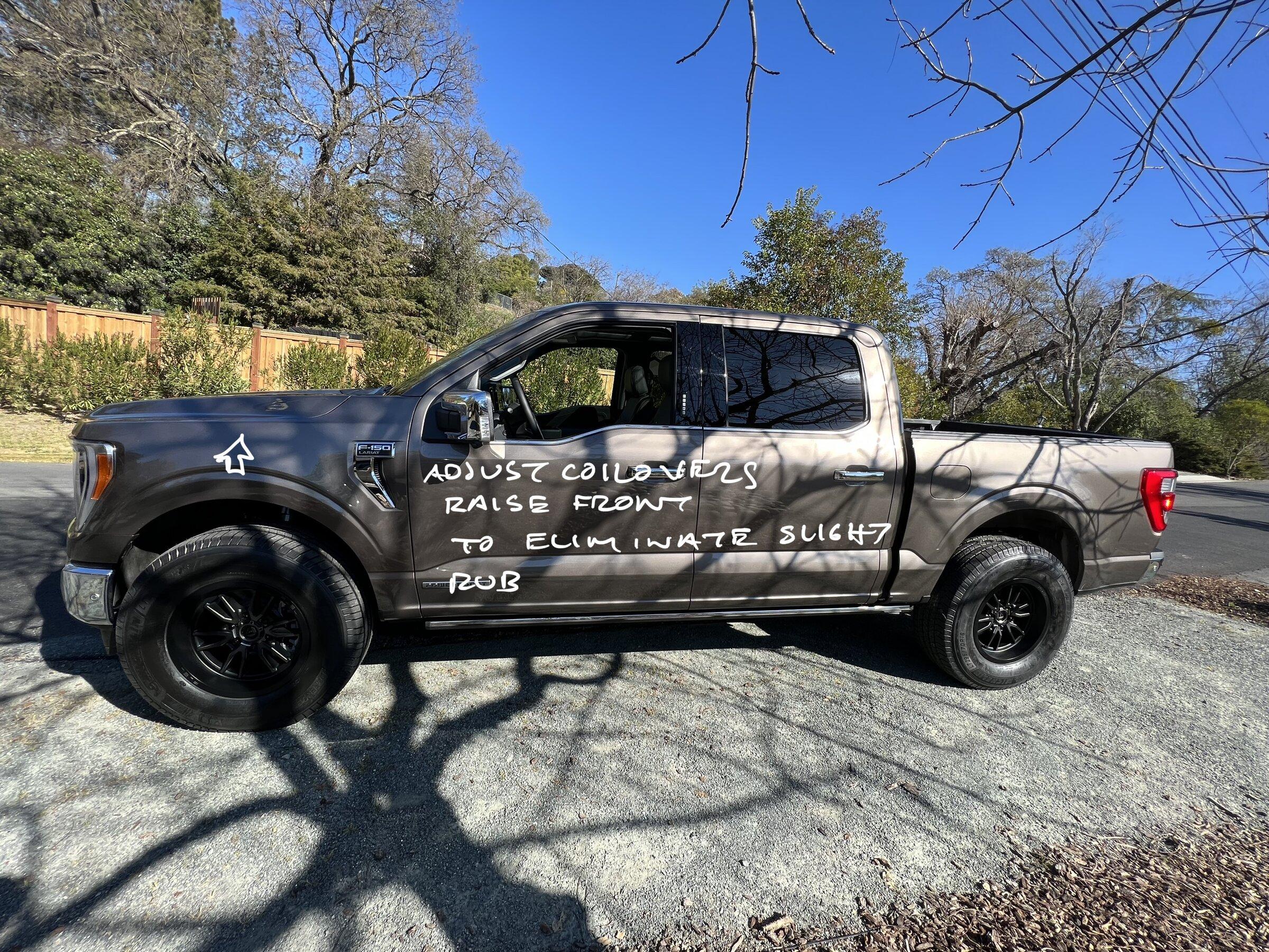

My truck finally arrived, and I had Granger install an Icon Stage II kit and align it before they shipped it out. I am assuming the dealer installed them at the settings that the shocks came out of the box since they didn't have the tires to test fit. I purchased the 295/70/18 Michelin Defenders locally from America's Tire and they just barely rub on the crash bar, so I am thinking raising the front approximately 1" should resolve the issue?
I think I have plenty of room to raise the front slightly to eliminate the rub. I thought I read every (4) turns of the collar gets me 1/2" raise in ride height. Install guidelines don't exceed 2" of exposed thread, and right now I have 1" exposed thread.
2. THE SHOCKS SHIP AT ICON’S RECOMMENDED RIDE HEIGHT. ICON DOES NOT RECOMMEND ADJUSTING THE COIL BEYOND 0.8” OF THREADS BETWEEN THE BOTTOM OF THE TOP CAP AND THE TOP OF THE COIL NUT. ADJUSTING BEYOND 0.8” OF THREAD SHOWING WILL REDUCE RIDE QUALITY. DO NOT EXCEED 2” OF EXPOSED THREADS.
Anyone have insight or opinion by looking at the photos? It is drivable as is, just want to get it correct.

I'm debating 285/65r20 vs 275/65/20, so these pics help for sure. Since I'll be towing a 6000lb TT, not sure I want to put on a 2" level. I did see motofab has a 1.5", but still think it'll be too much when towing.
Definetly do not raise the front when towing. Asking for trouble.
