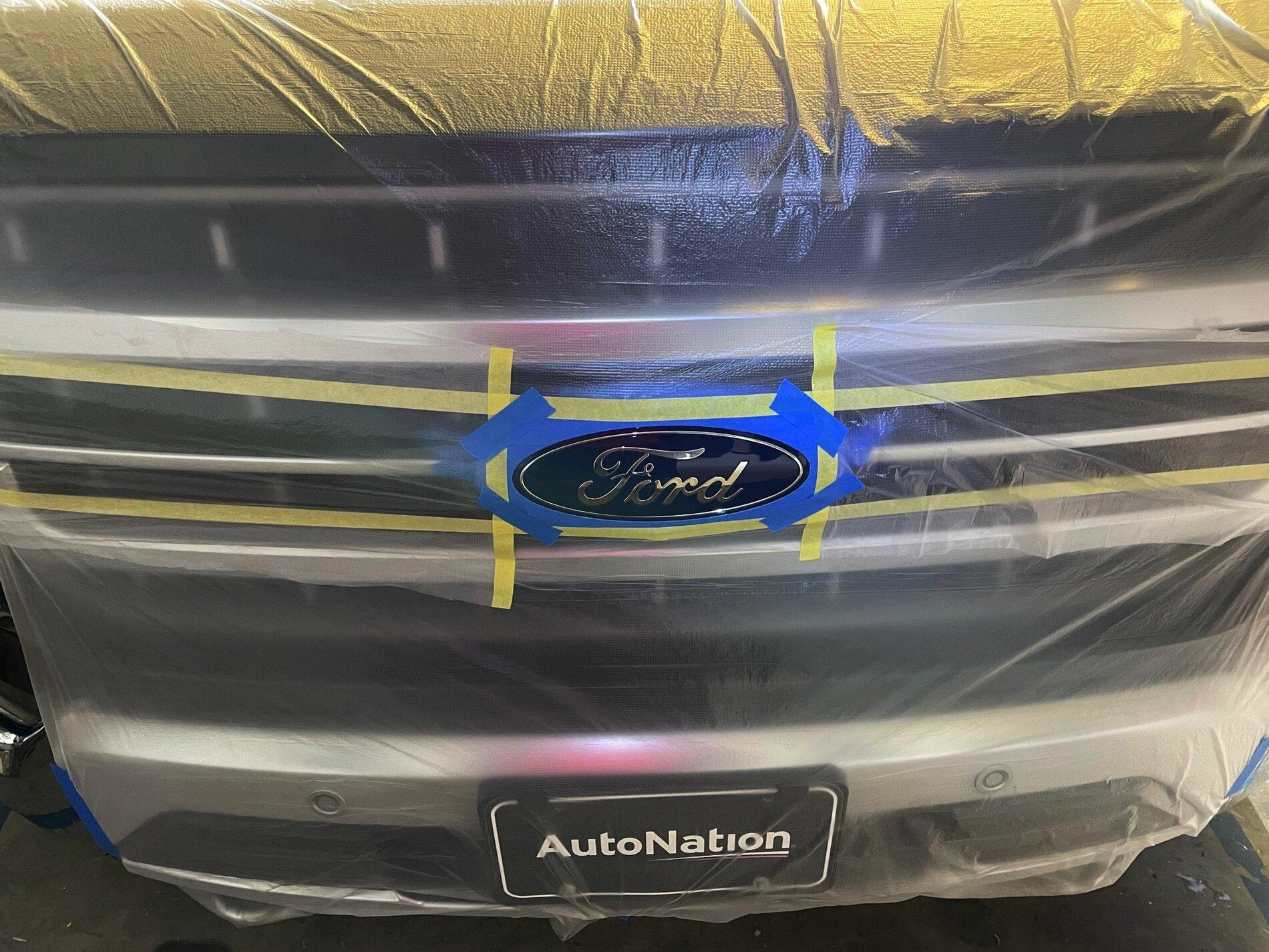

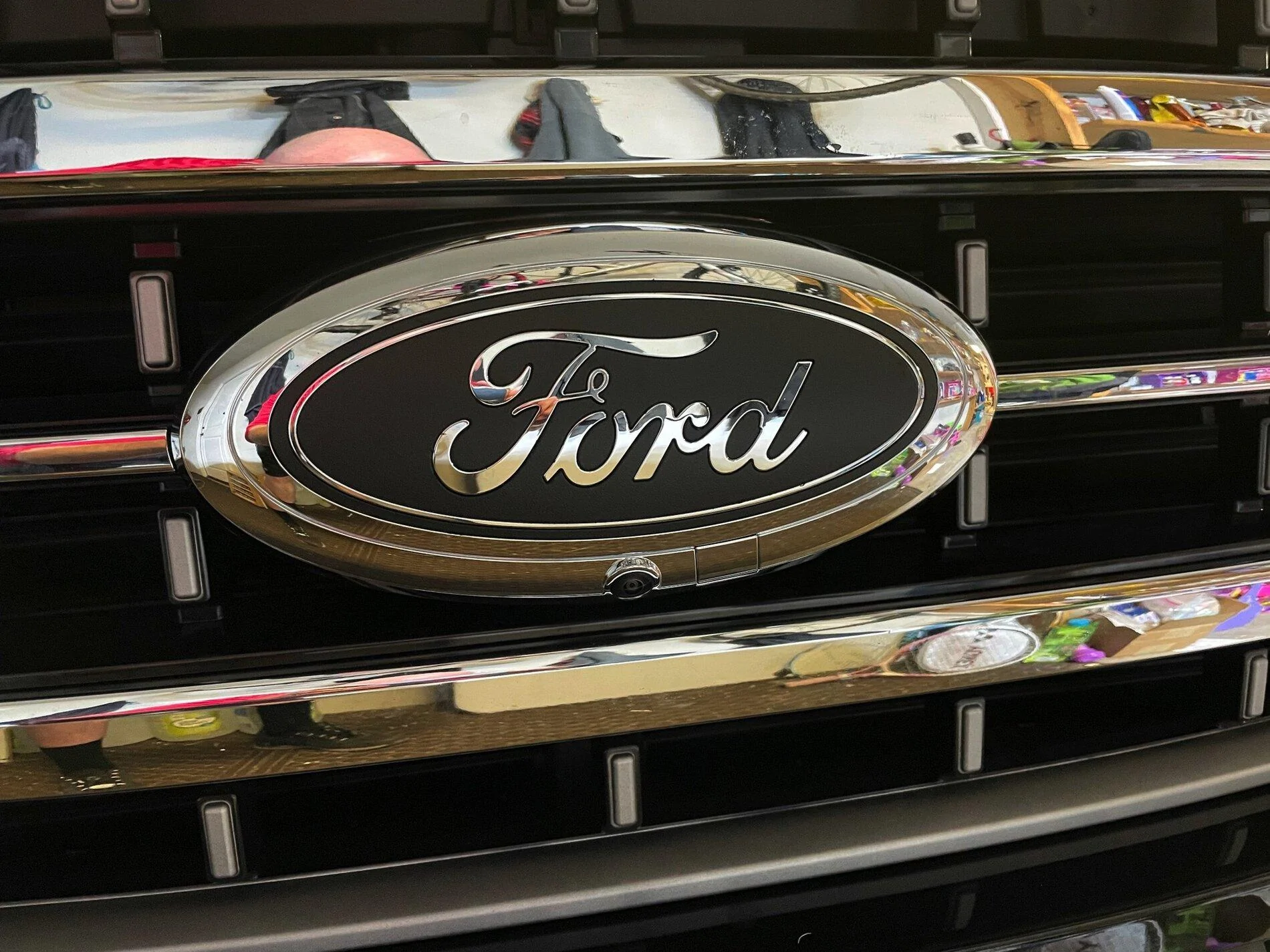

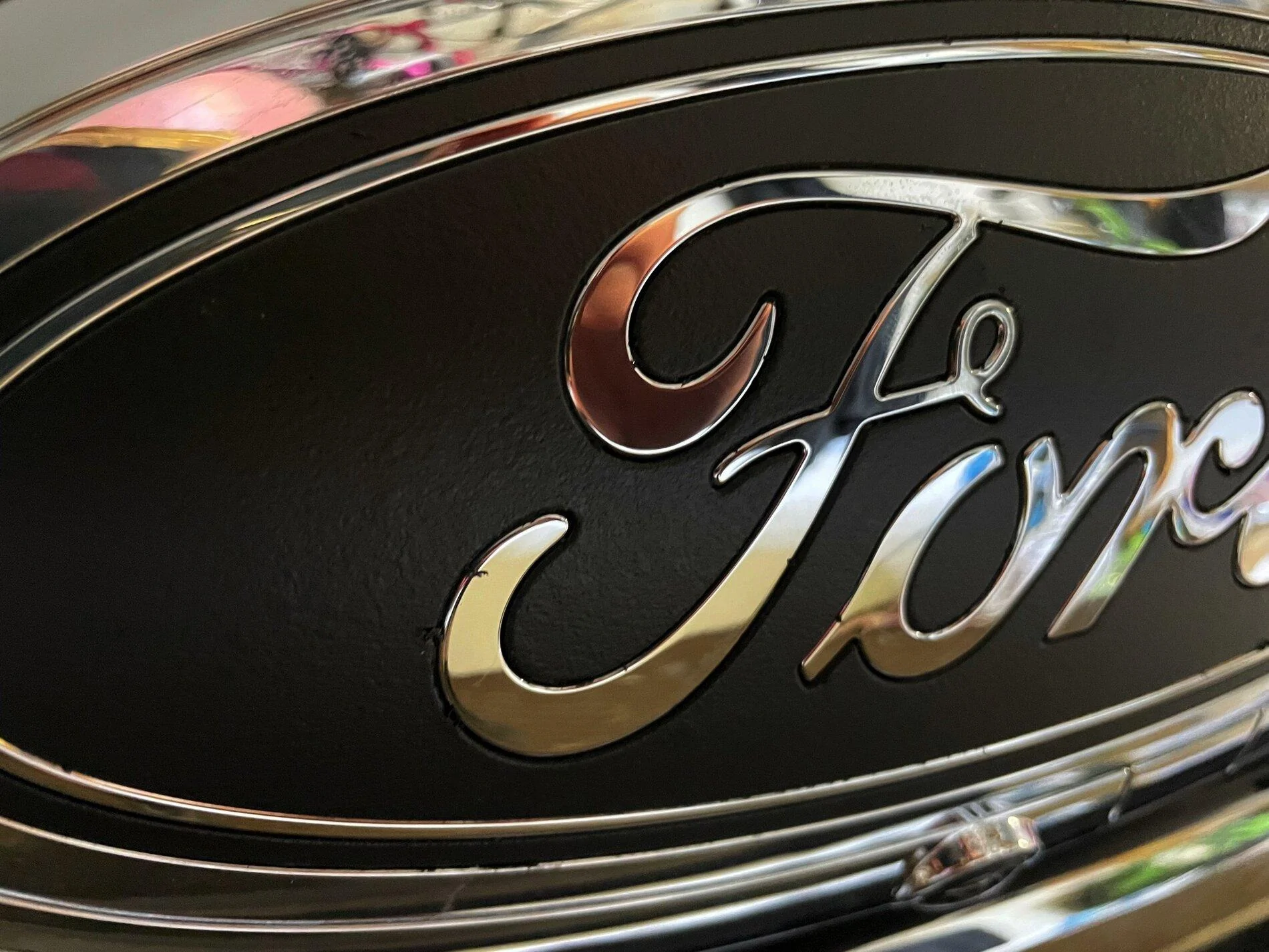

I wanted to swap my blue oval for a black one, but keep my chrome. Didn't seem like any of the decals supported that, and new emblems are awfully pricy. Also still was a little confused if any of the emblems worked with the 360 camera on the 2021. So I masked off the outer chrome ring with the rest of the grill, sprayed 8 coats of black plastidip on, removed the masking while wet to prevent peeling, and then after it dried I trimmed out the chrome ring and FORD letters with a hobby razor. Left with a nice textured matte black oval and chrome letters. Did this for grill and tailgate.
Ford F-150 Lightning Black Ford Emblems / Logos? Masked
Ford F-150 Lightning Black Ford Emblems / Logos? Close U
Ford F-150 Lightning Black Ford Emblems / Logos? Full View

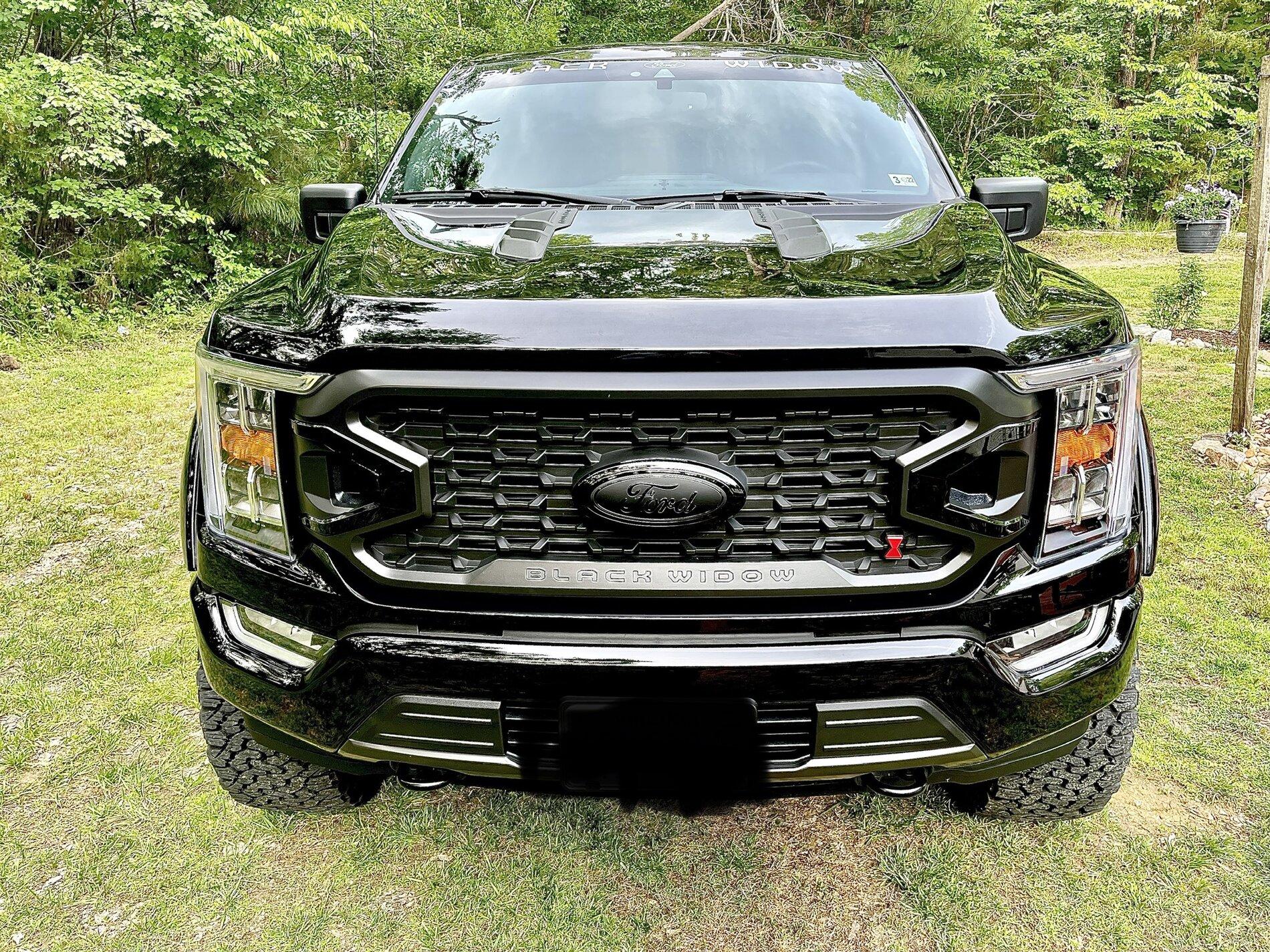

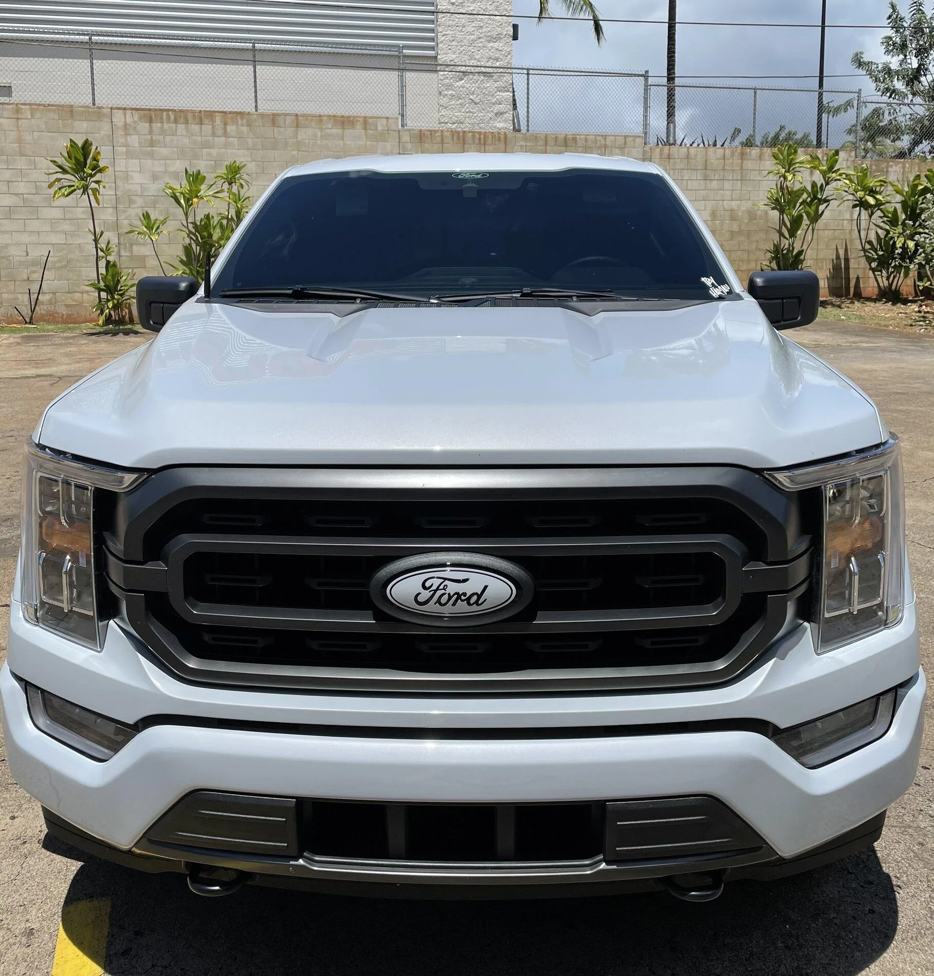

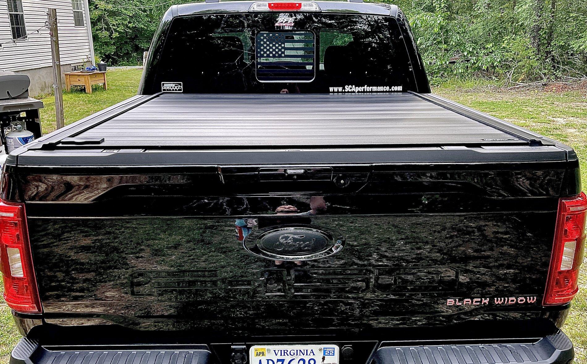

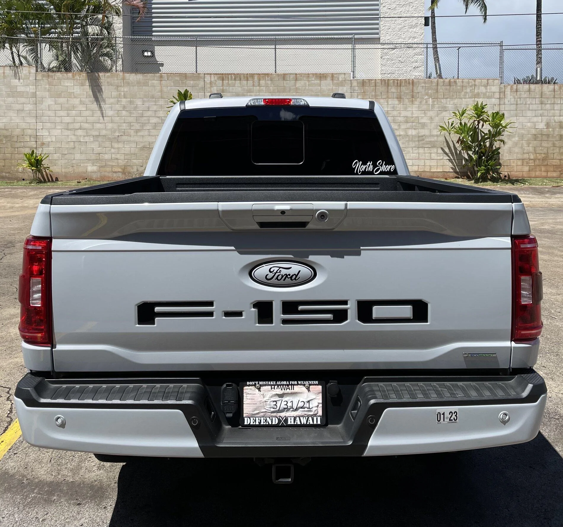

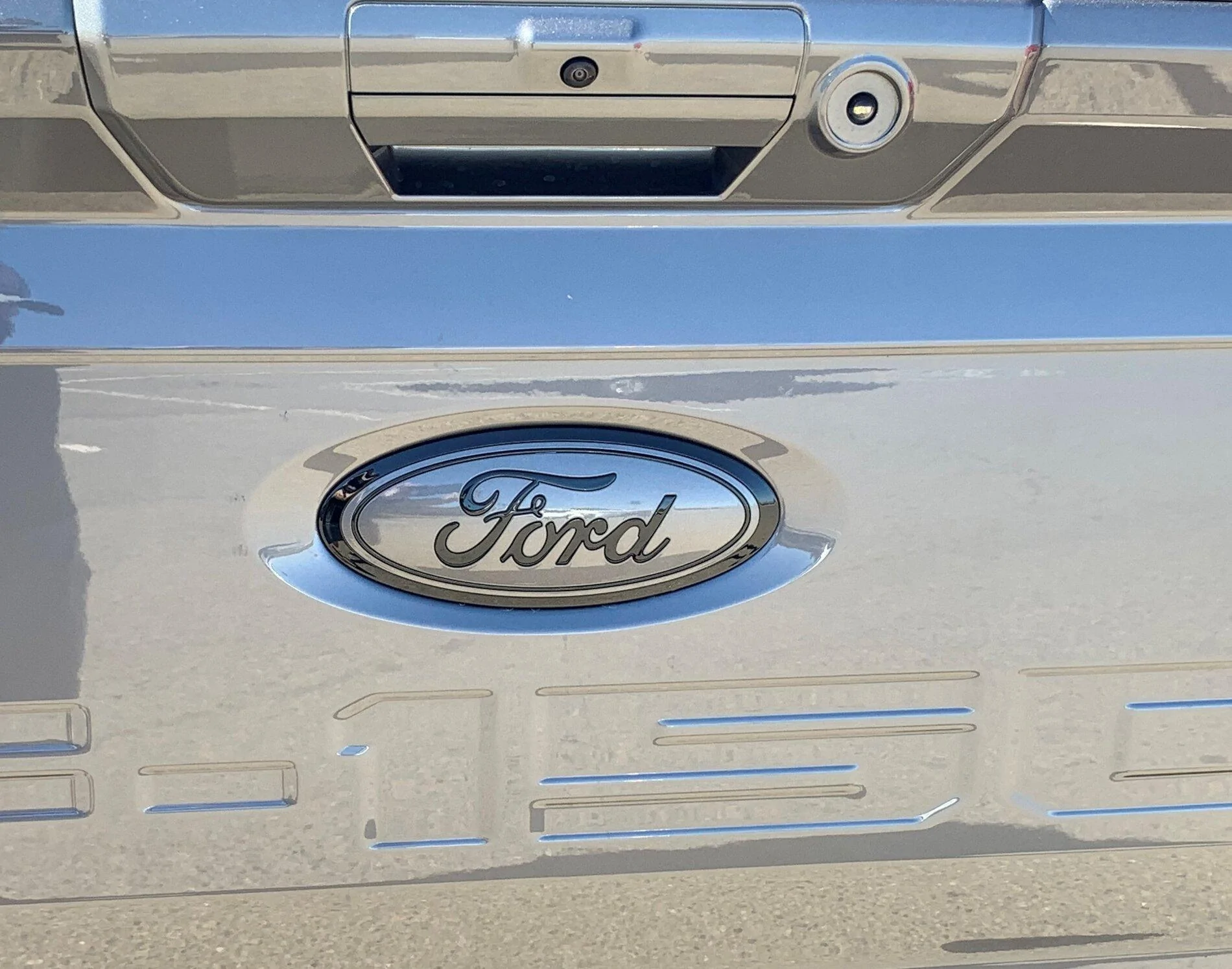

For anyone looking to paint match their emblems.. I do dozens a month. Just lmk
