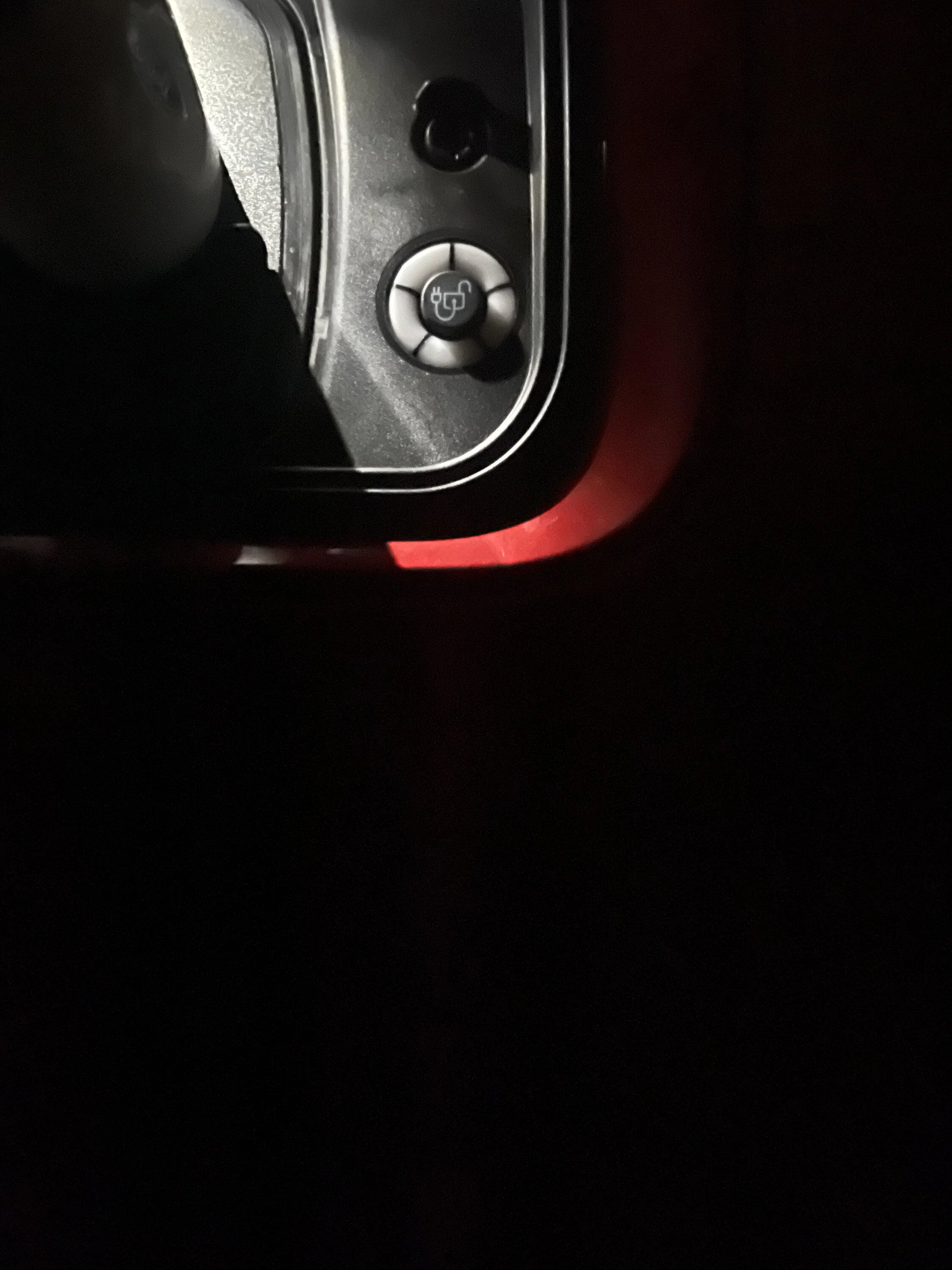

Has anyone noticed that their charging indicator light no longer turns blue to show progress? Or, maybe this is only with certain chargers. The picture below is shown charging with the portable charger with 240v.

or, it may also be that this indicator light only stays on for a few minutes... doesn't mean it's not charging, but the light is an 'owner' indicator.
I wonder if pressing it will reactivate it.

Mine still works the same. Blue when charging, flashing the percent quarter that it's current charging in.

Can someone tell me what exactly that button does? I thought i would press it and it would unlock the charger but it doesnt. I held it and it still doesnt.. not sure what i am doing wrong.
On my Mach-E, it is used to stop a DCFC session. Then the CCS connector can be removed by pressing the latch on the connector. When I first got the car, I couldn’t unplug my L2 cable unless I pressed this button first, but that apparently got changed by an update.

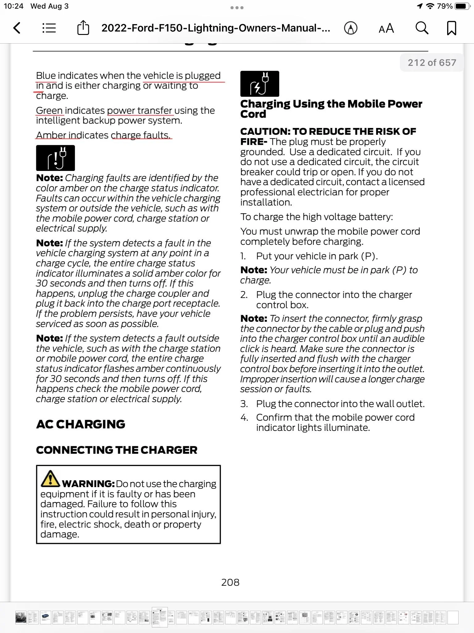

Isn't there a setting to turn it off? Maybe you toggled it.

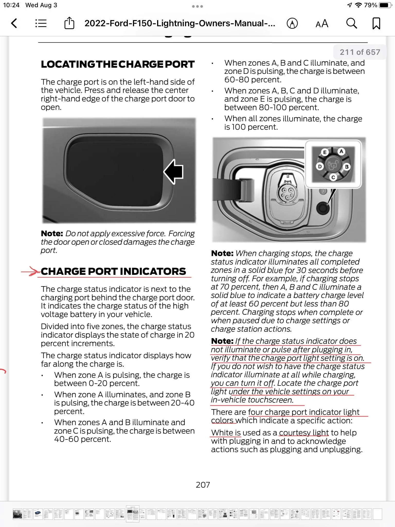

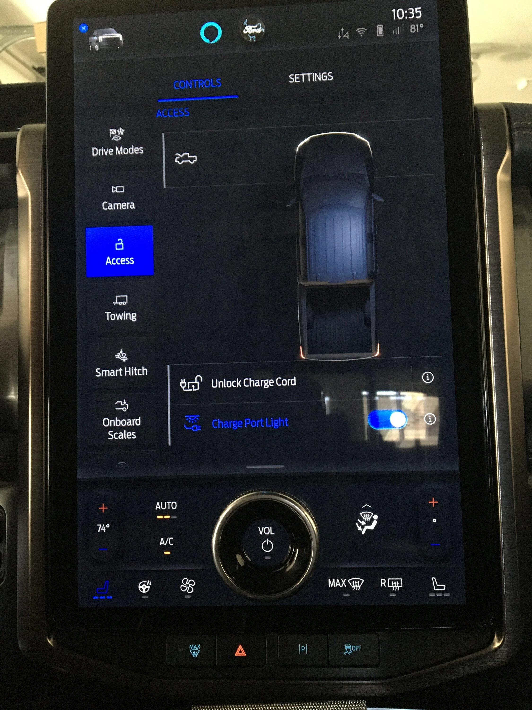

@blpublic
Yes, it is buried in the “Vehicle Access” screen of the vehicle’s settings ….not the most intuitive location to put it, and the location of this toggle is not explicitly identified in the Owner’s Manual …..just a general reference to “Vehicle Settings“…just not where in those settings……

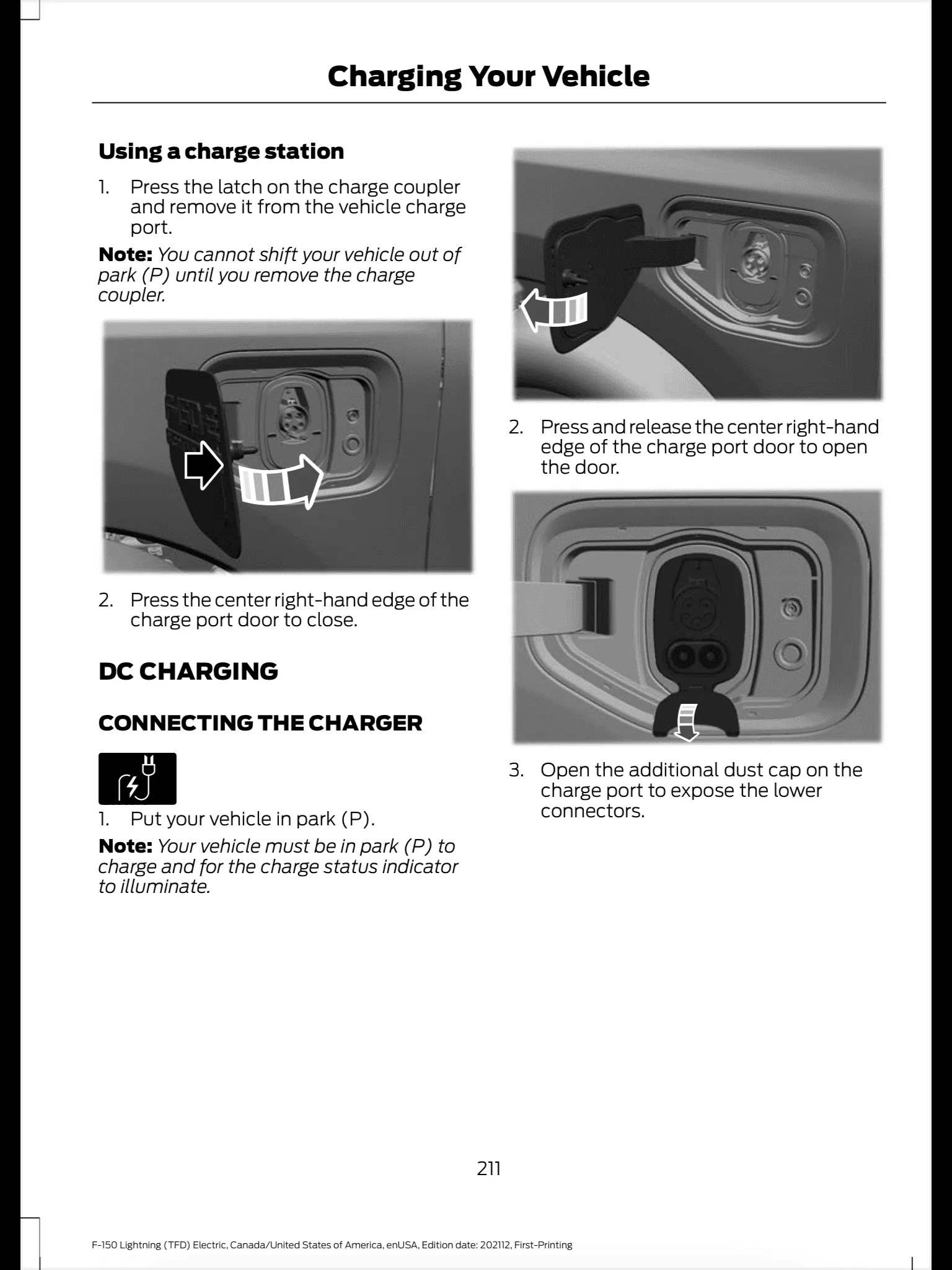

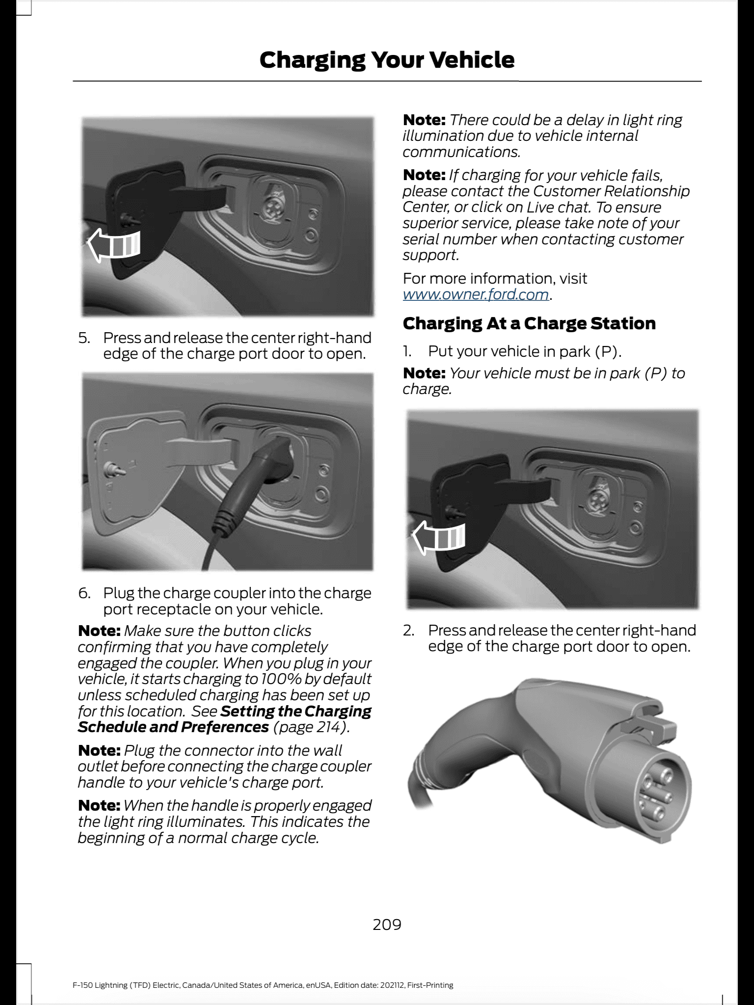

It appears to be the same with the Lightning…the Owners Manual instructions for disconnecting from a “Charge Station” and a DC Charger differ in the instructions for disconnecting from a DC charger explicitly state to first “push the coupler unlock button”.

@blpublic
Thank you! A classic case of RTFM - sorry. I didn't know my dad had accidentally changed this.
No worries….I stumbled across the location of this setting when rooting around the UI on my 2nd day. Had I just read the manual, I would have still had to root around because Ford didn’t make it clear in the manual were this setting is located! “Vehicle Access”….the Frunk is shown at the top of the screen and the rest of the controls are related to charging. 🤔
