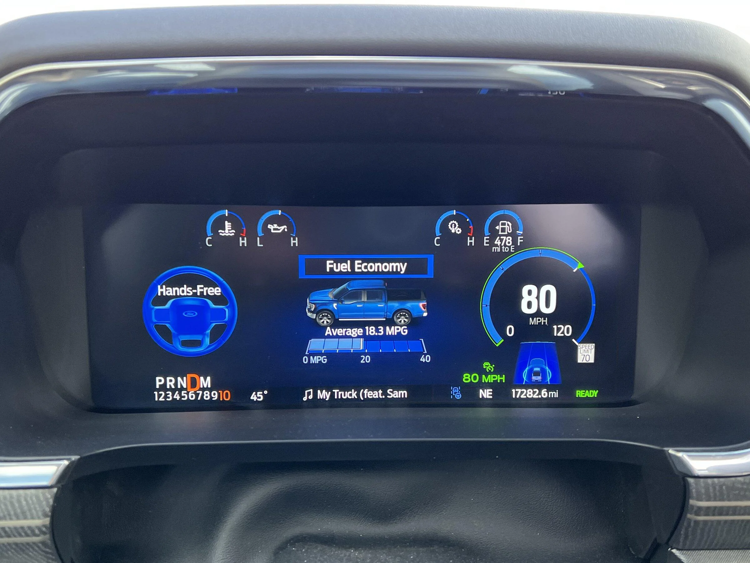

I can confirm that with the update to 2.5.2 last night that BC is active and works. My only trouble with it that it kept randomly de-activating. I started isolating, and found out that BC seems to kick off at 81 MPH. Perhaps this is talked about elsewhere, but I hadn't noticed it mentioned.
Note that it wasn't limited to "5 over", but rather a maximum speed. I could set it at 77MPH in a 70 zone and was fine.
It is confirmed that even in a 85mph speed zone, blue cruise will not work past 81 or 82.
