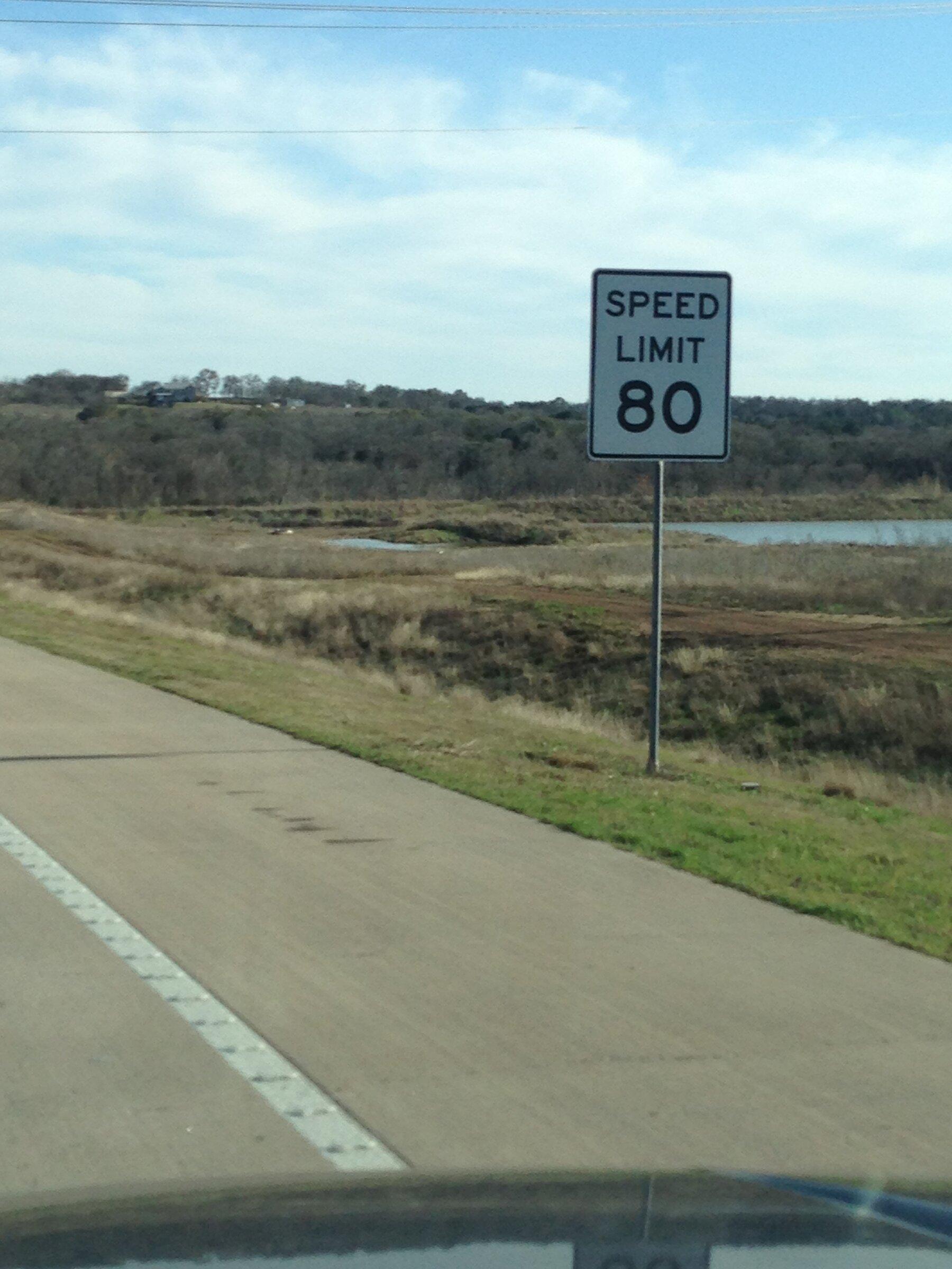

Looks like it's Texas. I know I've seen as high as 75 in the Midwest.
My company's corporate office is in Houston. Been to Texas a few times I never seen a limit that high. Im not doubting I just want to know what roads so I can drive them too?
Yeah, Kansas has a number of 75 areas.
South Dakota has areas that are 80 MPH. Moving straight north of Sioux City, IA on I-29 and it really starts to scoot.

Bring it on down to TX. The speed limit is 85 on a Toll road that was built a few years ago between Austin and San Antonio.
You have to get out of the big metro areas before they up the speed limit to 75+. I think the Austin tollroad bypass is the closest to where large numbers of people live.
Of course in Dallas and Houston, you still have to drive 80 or you get run over regardless of what the speed limit sign says.
