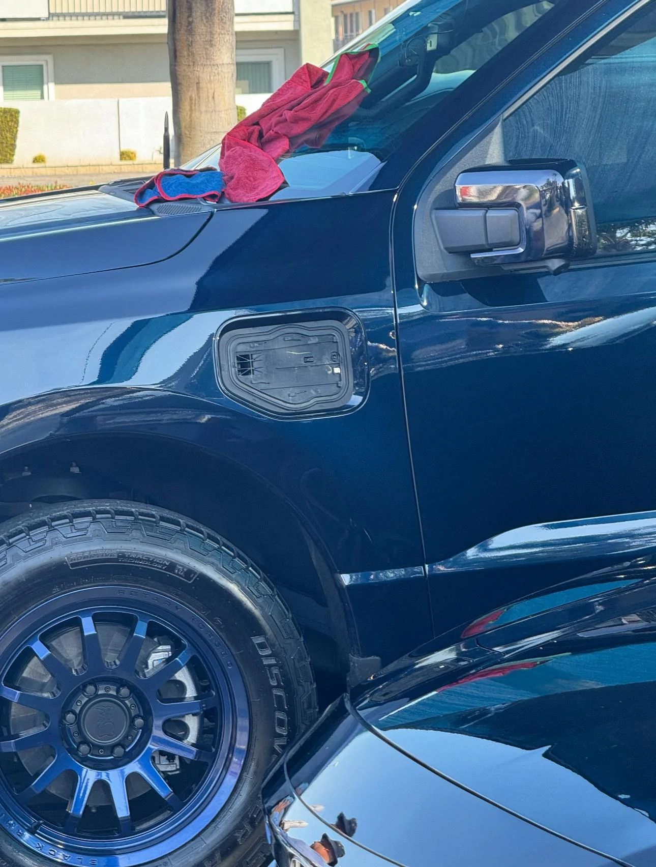

It literally slides right back on. If you press to hard and at a specific angle when closing it you can push it off the little tabs that hold it on. Then you go driving and it goes missing.

... you can push it off the little tabs that hold it on ...
tl;dr: You can push off the little tabs that hold it on.
The cover has little tabs of its own, that it uses to hold onto the above-quoted little tabs of the door proper. Both material and size put the cover's tabs at a disadvantage compared to the things they're supposed to grab. The tiny prong near the cover's upper outboard corner, for example --if you try to re-attach the cover to the door proper, you'll find it pretty easy to break off. Maybe not in one try, or in two like I did. But you get all the tries you need, while you can still find the cover.
